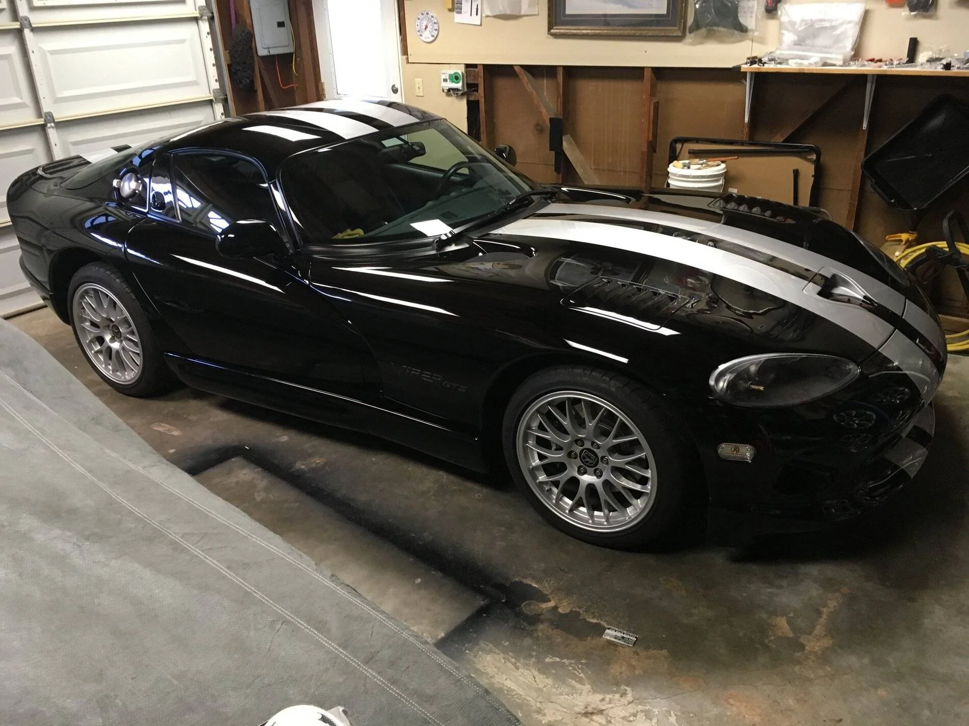

And why do you think is that so?
That is my Viper
And why do the first things owners of the cars you mentioned do after their first track day???
They put much bigger tires in front.....
That is my Viper
LOL owners also put spinners on their cars and double decker wings. My point is owners THINK they are smarter than the engineers that designed the car. Their not! And on your viper wider tires up front don’t equal a squared set.
