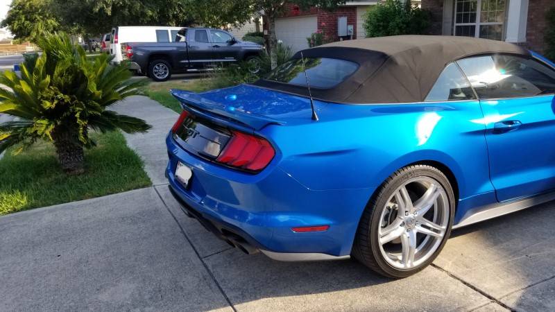

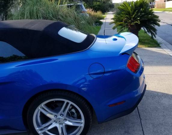

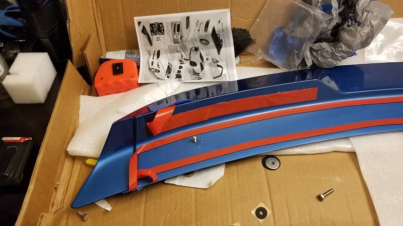

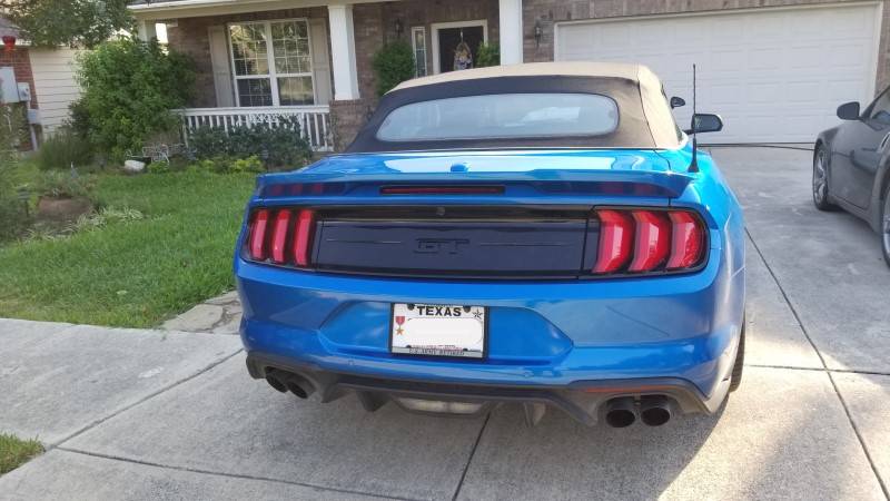

CDC Outlaw
RPI Designs Painted
https://www.rpidesigns.com/shop/item.aspx?itemid=5431

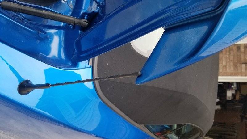

Need to get a shorter antenna - The stock one catches on the spoiler.
CDC shows as a 15-17, but fits on 18-20 as well.

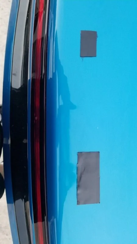

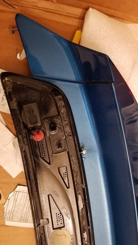

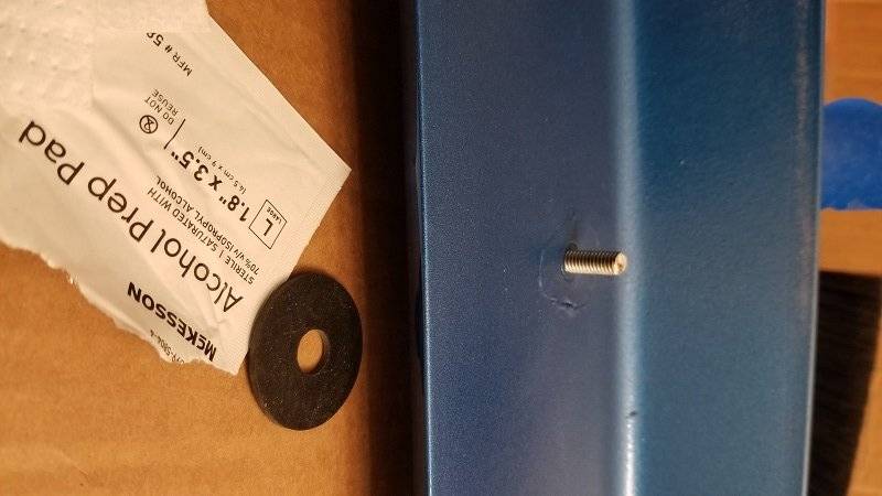

Removal was pretty fast and easy.
Used 6 strands of fishing line tied and taped on 2 6" aluminum rods to saw through the tape and a couple of soft plastic trim tools to pry it off.
Used a drill attachment from LMR to remove the remaining tape fairly quick.
https://lmr.com/item/LRS-400E-KIT/adhesive-removal-tool

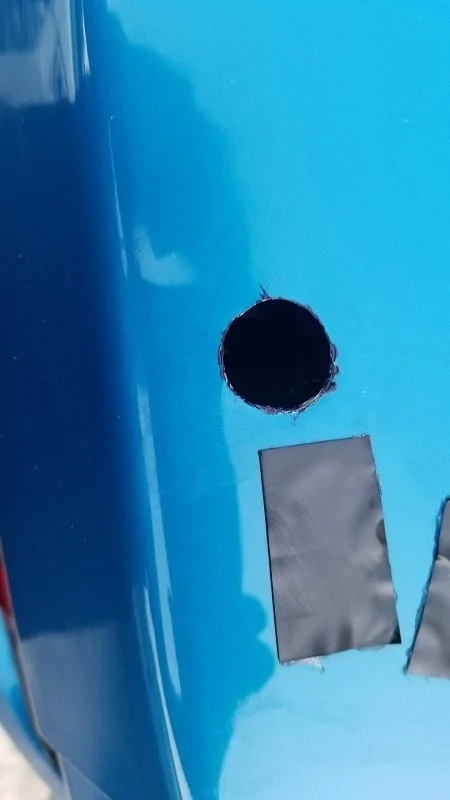

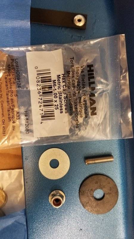

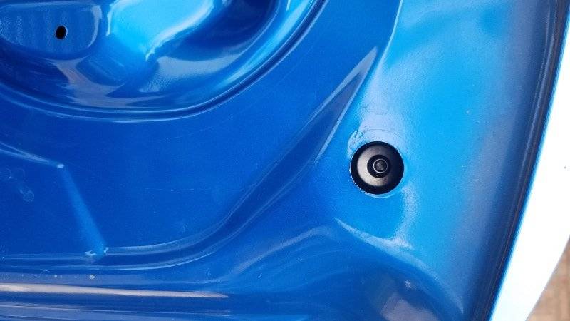

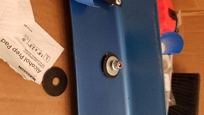

Install was a little tricky.
Holes in the truck and the screw holes did not quite match up.
Had to drill out the holes about 1/2" towards the middle and about 1/4" towards the rear of the trunk.
The included screws were very short and hard to thread.
Bought longer, but same size and thread (M6 x 1.00 x 25) bolts from Lowes; cut off the heads, and threaded them into the holes in the spoiler - creating a stud like the stock spoiler and allowed me to reuse the stock nuts.
Had to use a rubber washer and a metal washer due to the larger holes I drilled.
Used FlexiSeal Tape to cover the stock spoiler holes in the truck.
Hope this helps someone else in the future...

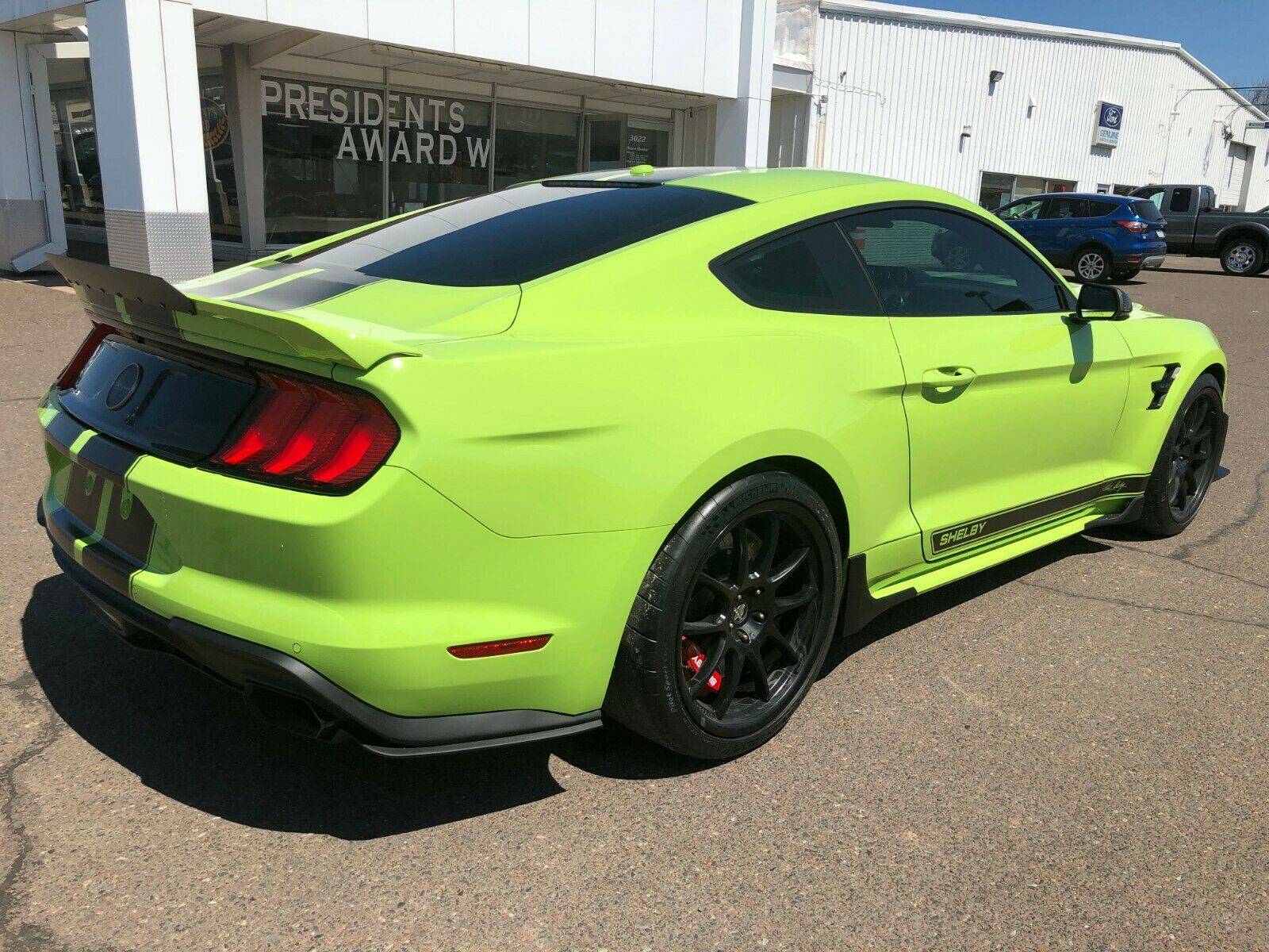

Wish someone could make a replica on that nasty look spoiler with the gurney flaps!! Or a least SHELBY sell them like the previous ones..

Update
Bought the Stubby antenna on Amazon - Works great and fits correctly.
Bought a couple of less expensive antennas, but they did not work well or fit corrctly.

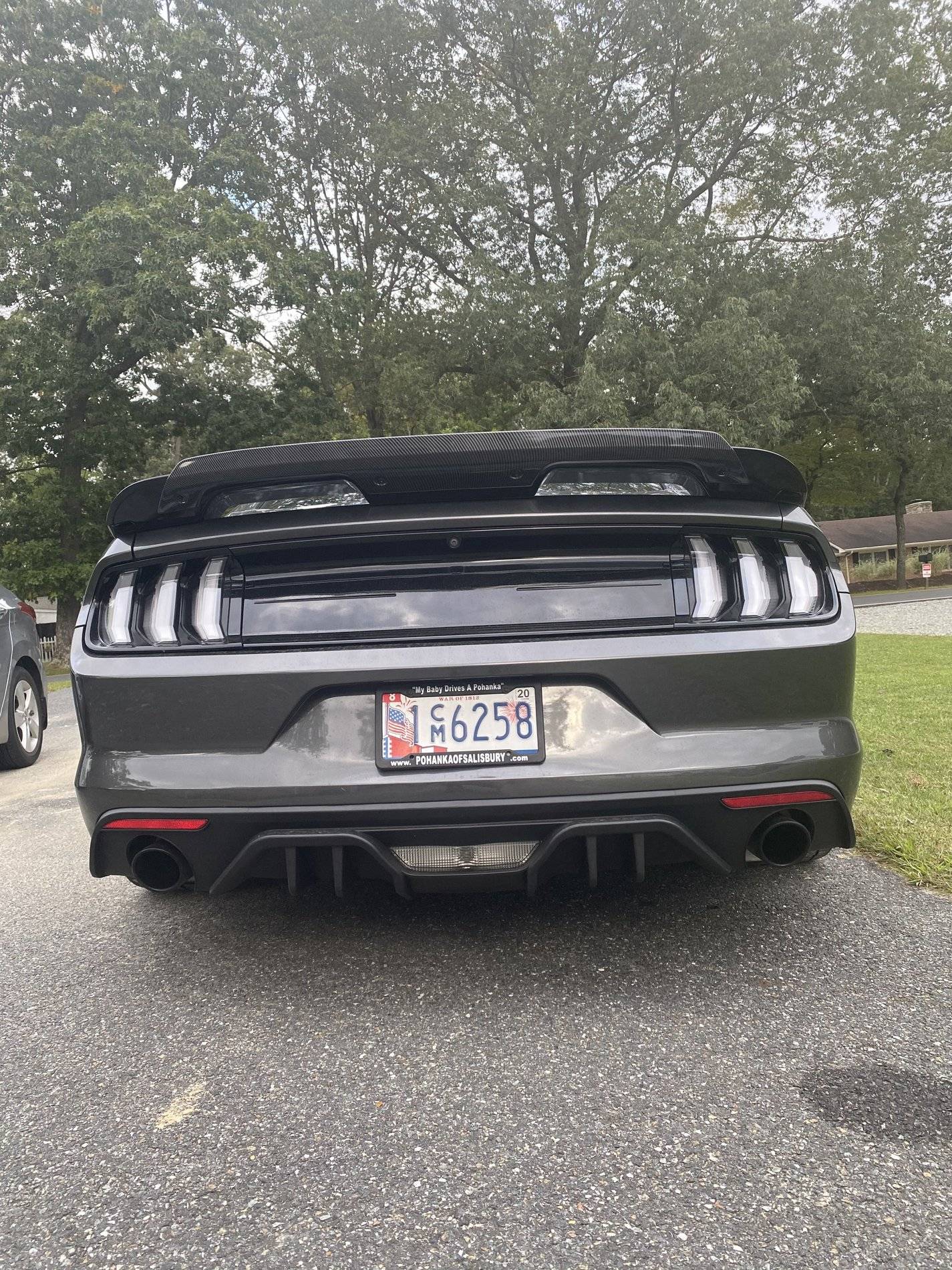

JimsFury
Aug 31, 2018
134
39
Jim
2020 Ford Mustang GT (Grabber Lime), 1996 Ford Ranger
Where did you get the Gurney Flap?
JimsFury
Aug 31, 2018
134
39
Jim
S550-STEF
New Member
Aug 16, 2016
Maryland
2016 MUSTANG GT PERFORMANCE PAC

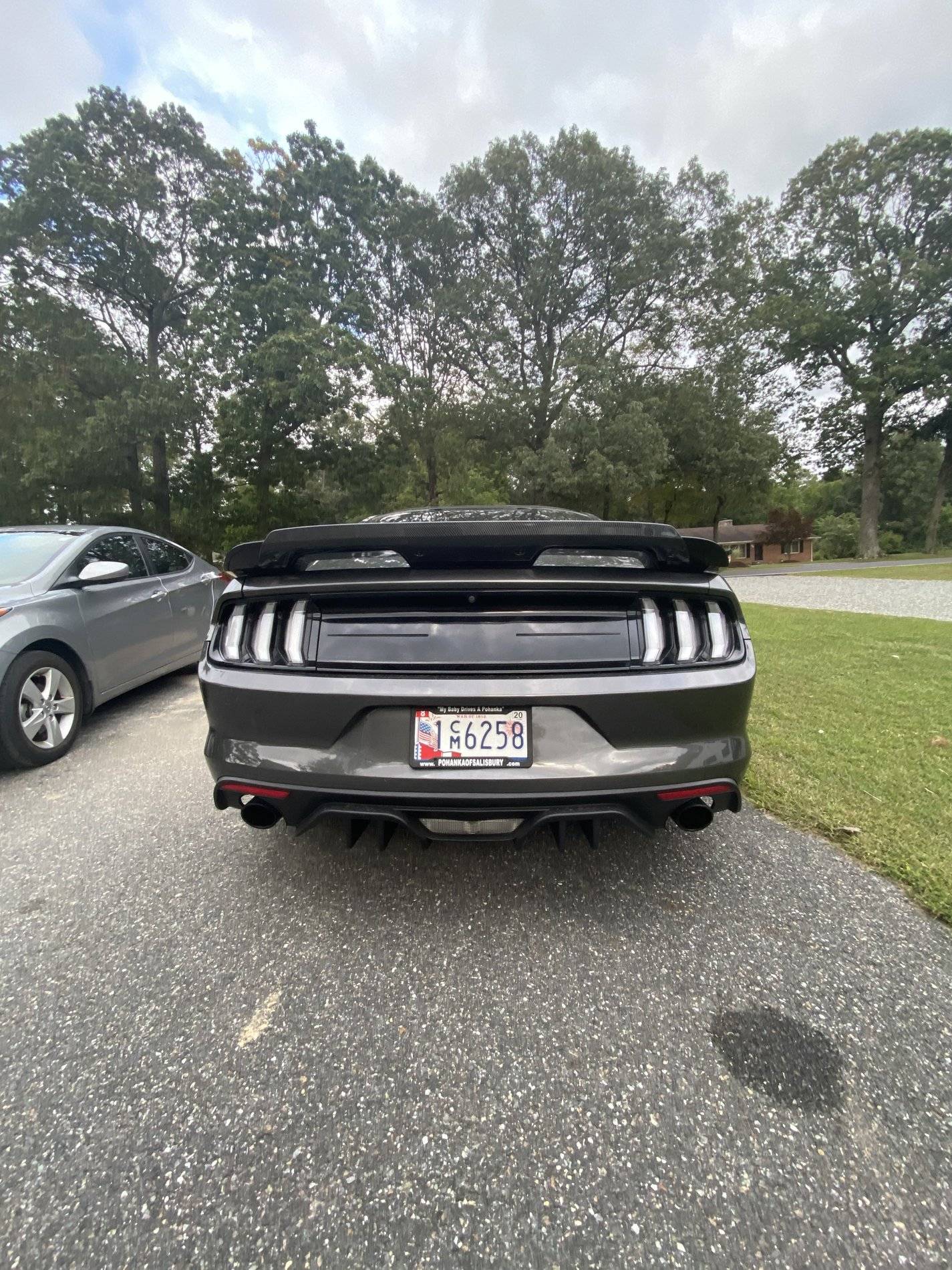

The I5 autohaus Rear spoiler with gurney. Quality and fitment is pretty good. Not super crazy about using self tapping screws to keep the gurney on but time will tell if it holds.
Voo Doo
Apr 18, 2015
128
2,587
1,864
Surrey BC
Ric
2019 BULLITT DHG
The screws..”should” hold as long as you don’t use the spoiler to,close the trunk!!
