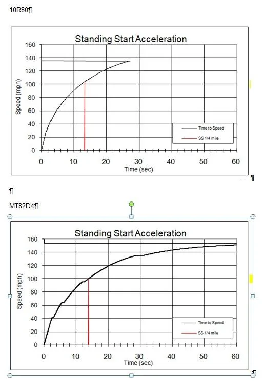

Visually, from a mathematical simulation of my own creation. Everything the same except for transmission gearing and shift time. The MT82 shift points are much more pronounced.

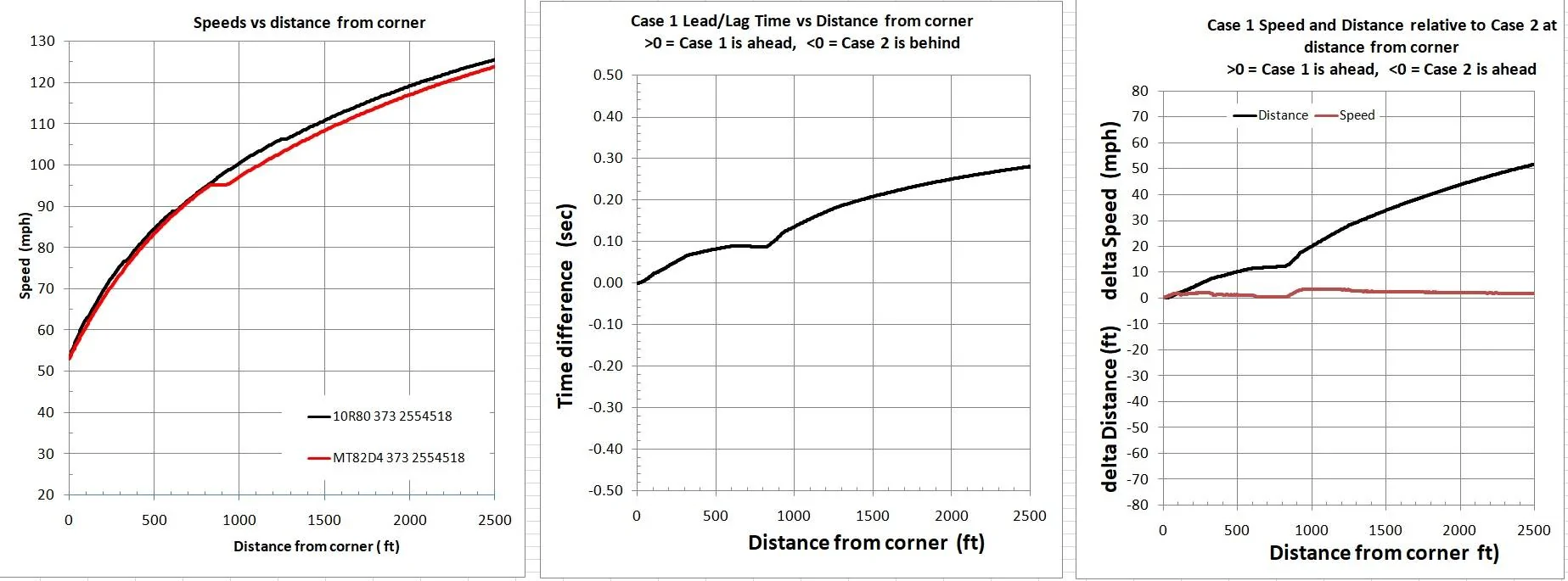

Here's what a run up through the gears starting at a little over 50 mph looks like. The 10R80 (Case #1) clearly leads the way.
