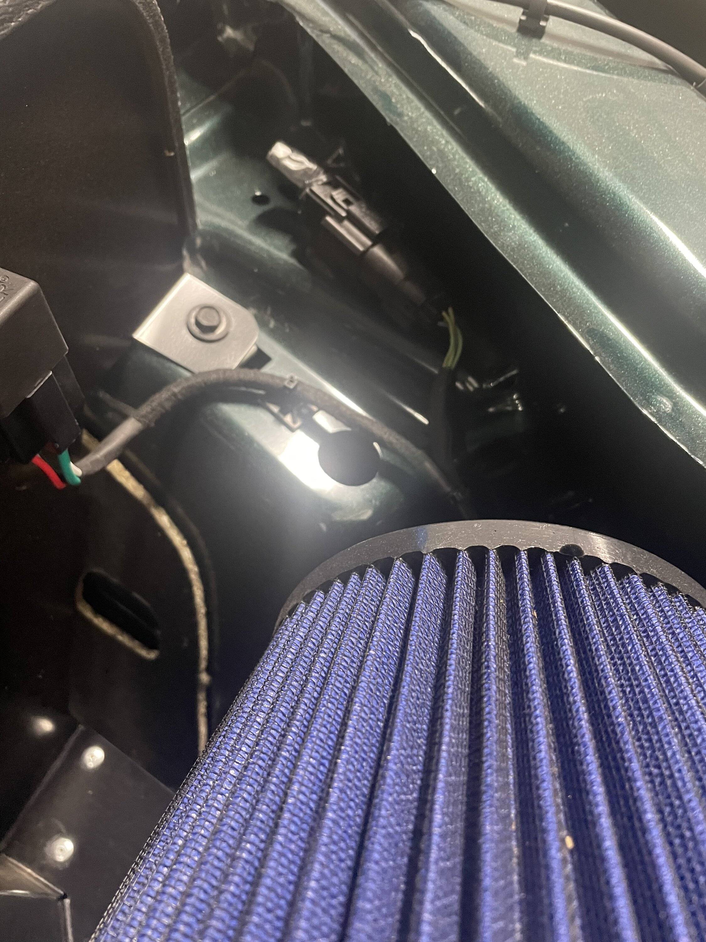

Have you turned off TC or unplugged the nanny plug on the driver’s side front fender by the airbox? Try that and let us know if that eliminates the bog for you.

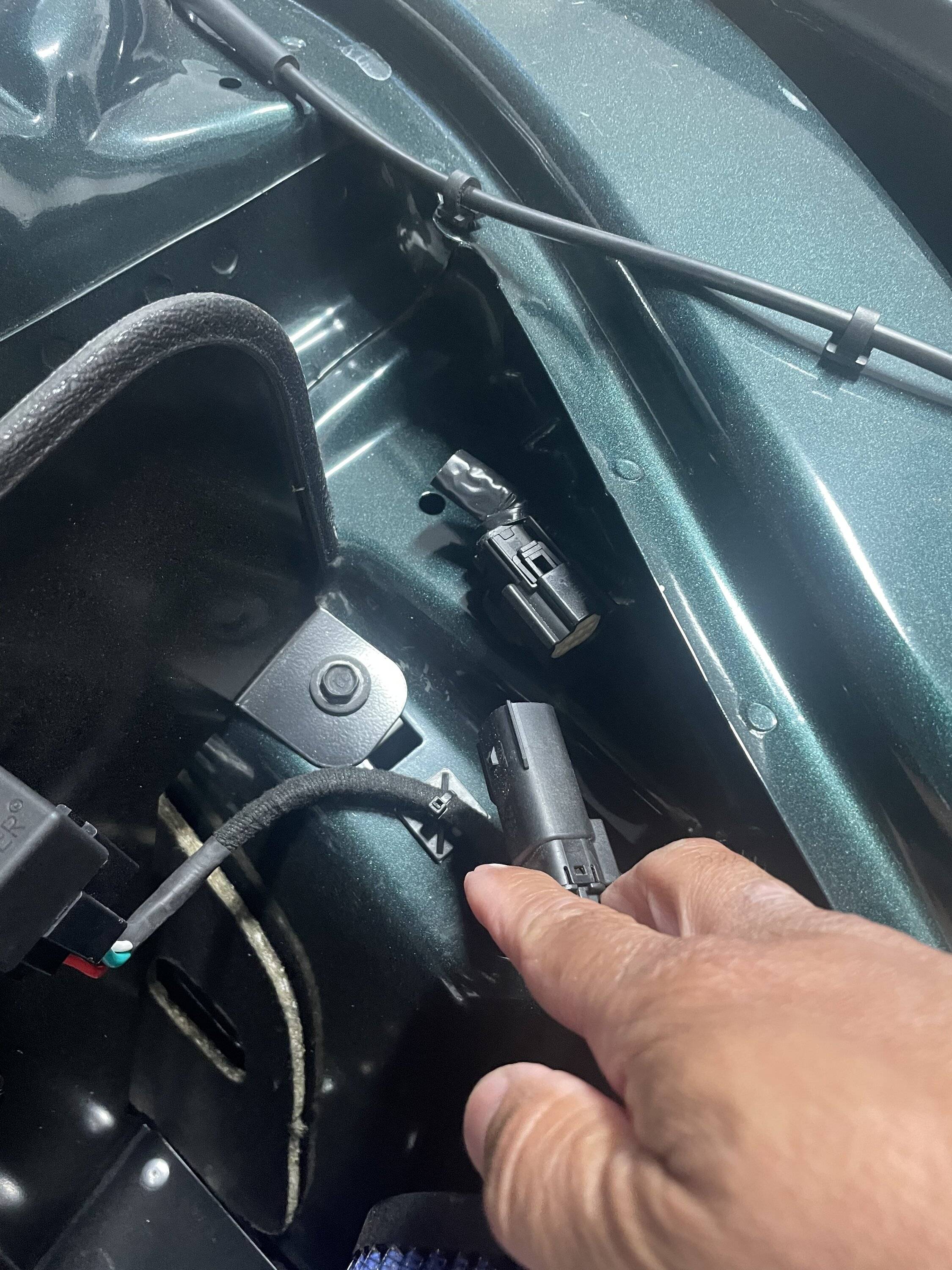

Locate this plug next to the airbox and unplug it.

Disables all of the nannies, TC, Advance Track. I ran with mine unplugged for months and it was convenient for track use. No issues, or anything, it just disables all of that stuff, so you don’t have to remember to do it. I’ve heard that turning them off in the car via the switches doesn’t completely disable them, whereas that plug does.

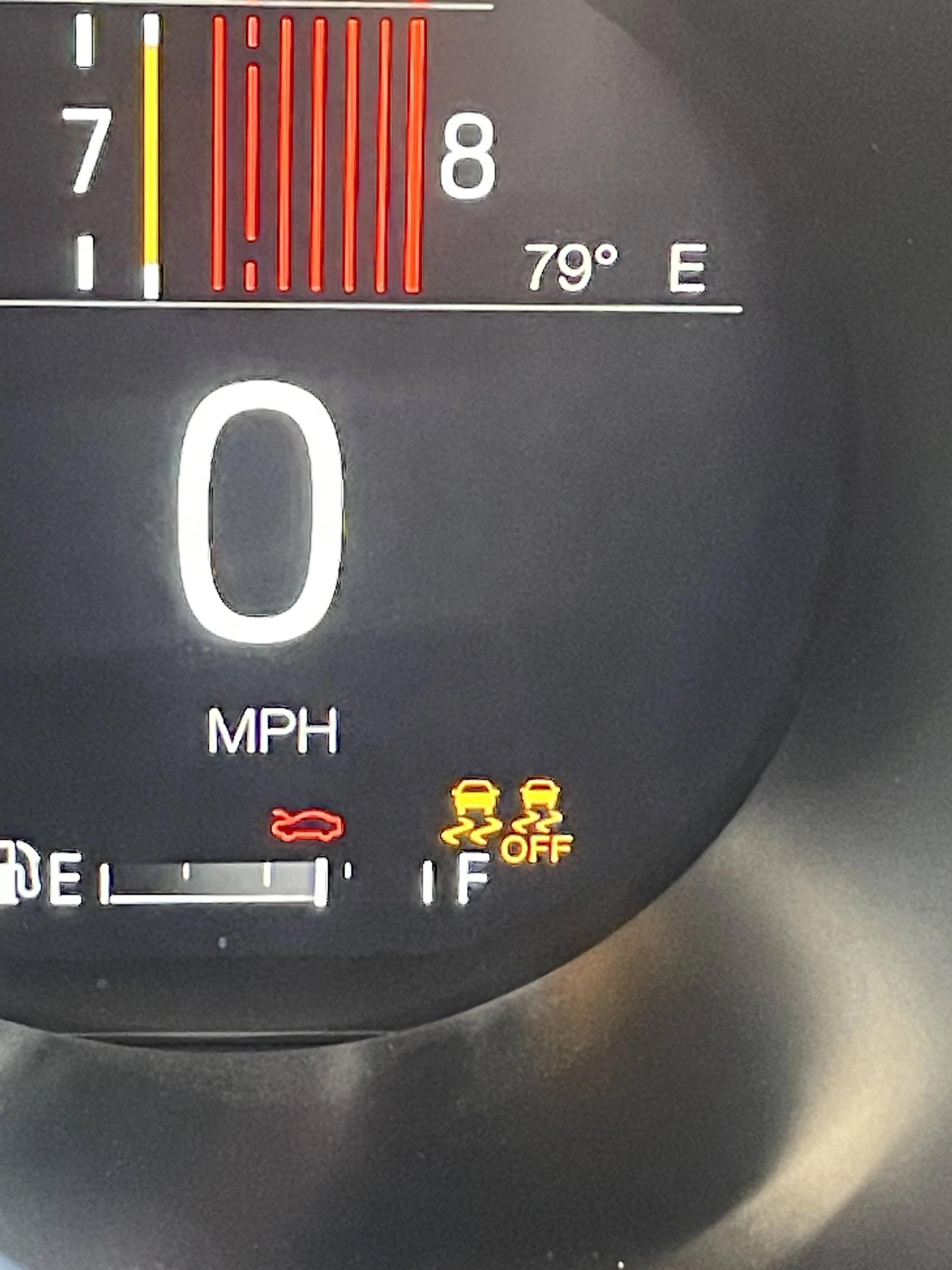

NGOT8R
Jul 19, 2020
154
9,403
7,900
Adrian
2019 Bullitt
Does the ABS and steering mode still work ?
Anything on the dash lit up like a Christmas tree ?
I don’t recall that being an issue, but I will unplug it and confirm it for you tomorrow.

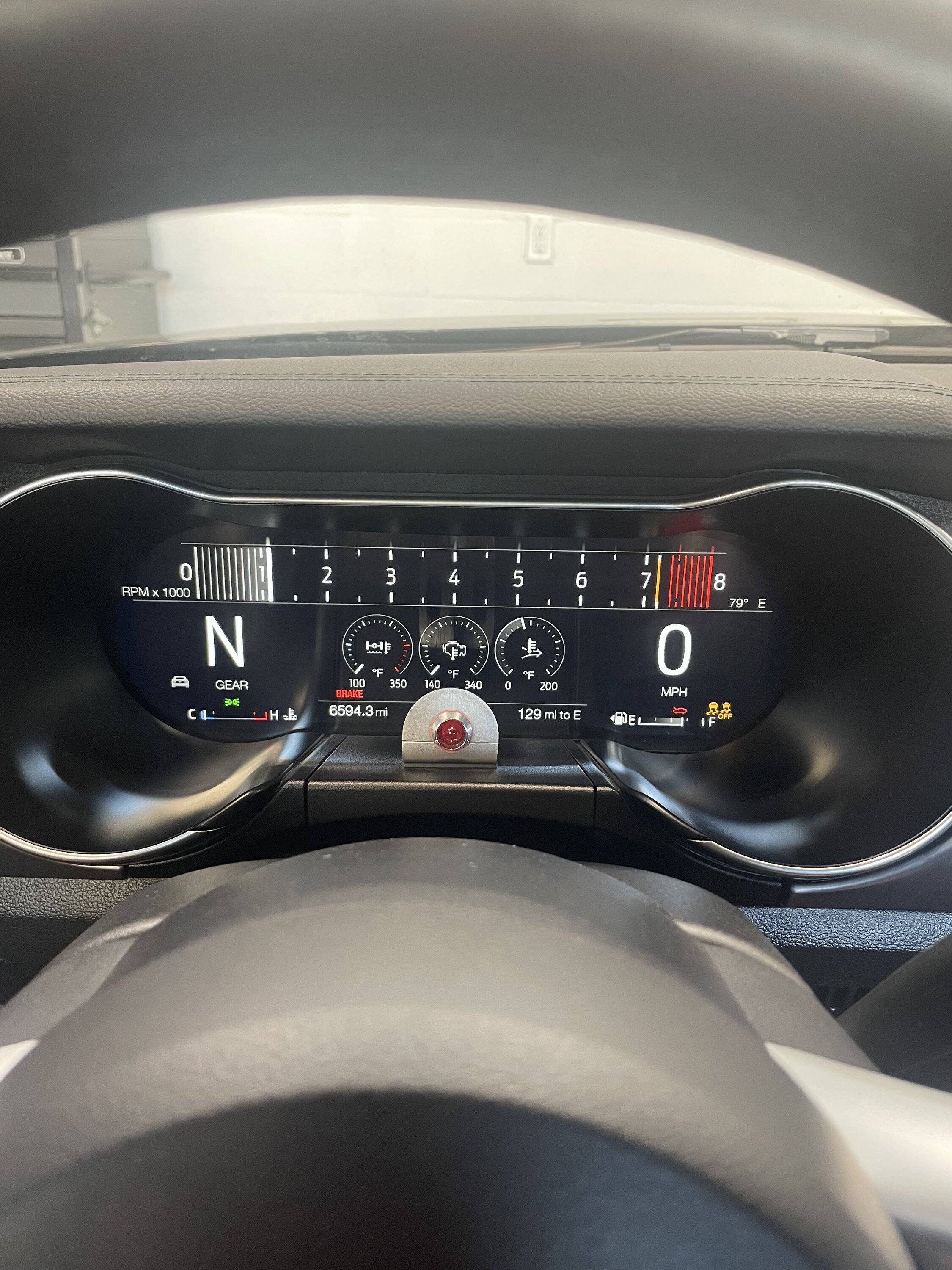

It’s been over 6 months since I plugged it back up, right before the car went under the knife for tranny work.
Here’s what I get on the dash when the nanny plug is disconnected. Disregard the Hood Ajar warning because the hood isn’t completely closed.
Thanks, Adrian. I'll give that a try a little later in the week.
