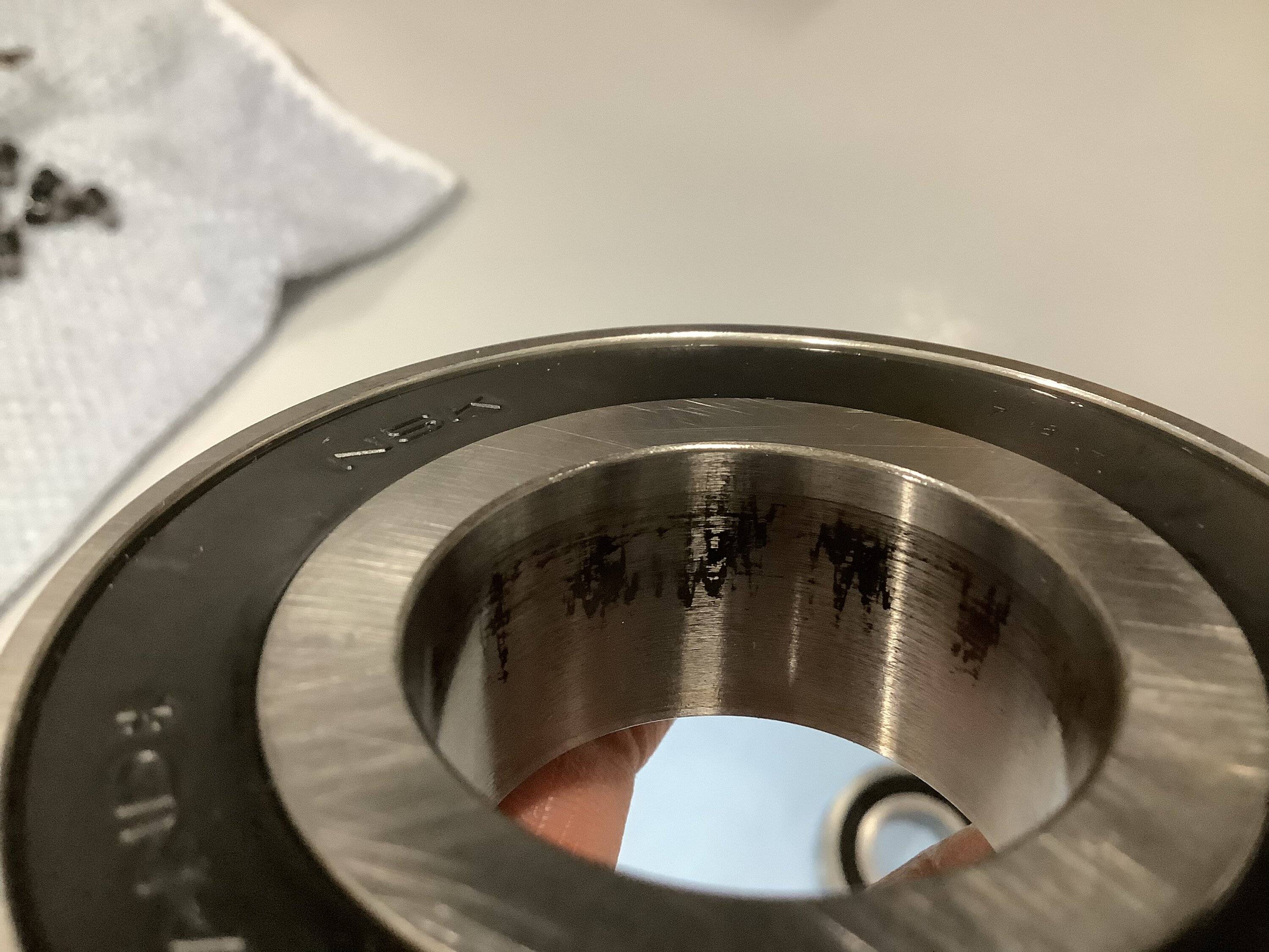

As stated earlier, I never had any problems out of my MT82-D4, but upon teardown, I did notice the following:
The input shaft bearing’s inner race had some oil burn marks around it. I was also able to wiggle the input shaft maybe 3/32” before I pressed it out of the tranny case/bearing. I presume this is what caused the marks around the inner race.
The output bearing was stamped, made in China, whereas the countershaft bearing and input shaft bearing were stamped, made in England.
I don’t know if this would have been exacerbated with more mileage, but this was discovered with just 5900 miles on the odometer. Either way, this didn’t look good at all to me and I’m glad I found it early on.
