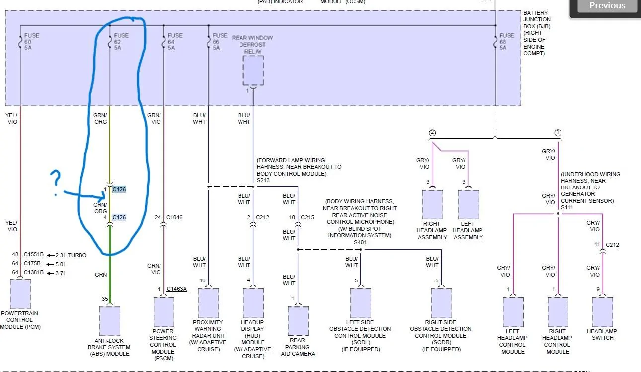

Well that is the P/N for the Plug but it helped me research. The Connector (C126) seems to be a One Wire which runs from fuse 62 to the ABS system. Here is schematic. I think this is the wire since it goes to the ABS Fuse people keep talking about pulling.
Since it is a Power wire and not a Signal wire you can just tap into the wire at the connector, run the two wire through the engine fire wall and under your drivers side dash where you can mount the switch. Keep me posted. I will maybe do this week end just to see if I can spin the tires without TC kicking in.

You mean like this? :

The plug is just a loop. Cut the loop, and wire the switch in-line with it. Easiest thing in the world. You’d be just creating an interrupt in the circuit.
