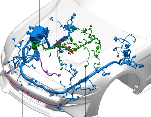

i'm sorry to revive a dead post, but i was looking at this as well, just in case i need to keep my new EcoBoost longer than planned.
anyways, it's definitely not an easy or cheap thing, but i'm sure it's possible to retrofit Magneride, but it looks like it'll require some pretty involved processes, like swapping out wiring harnesses, some of which are fairly expensive. like the engine compartment one which is part number LR3Z-14290-U which costs the dealer $503 and would involve a lot of work like replacing the fuse box and a lot of connectors (blue wires in below picture)
