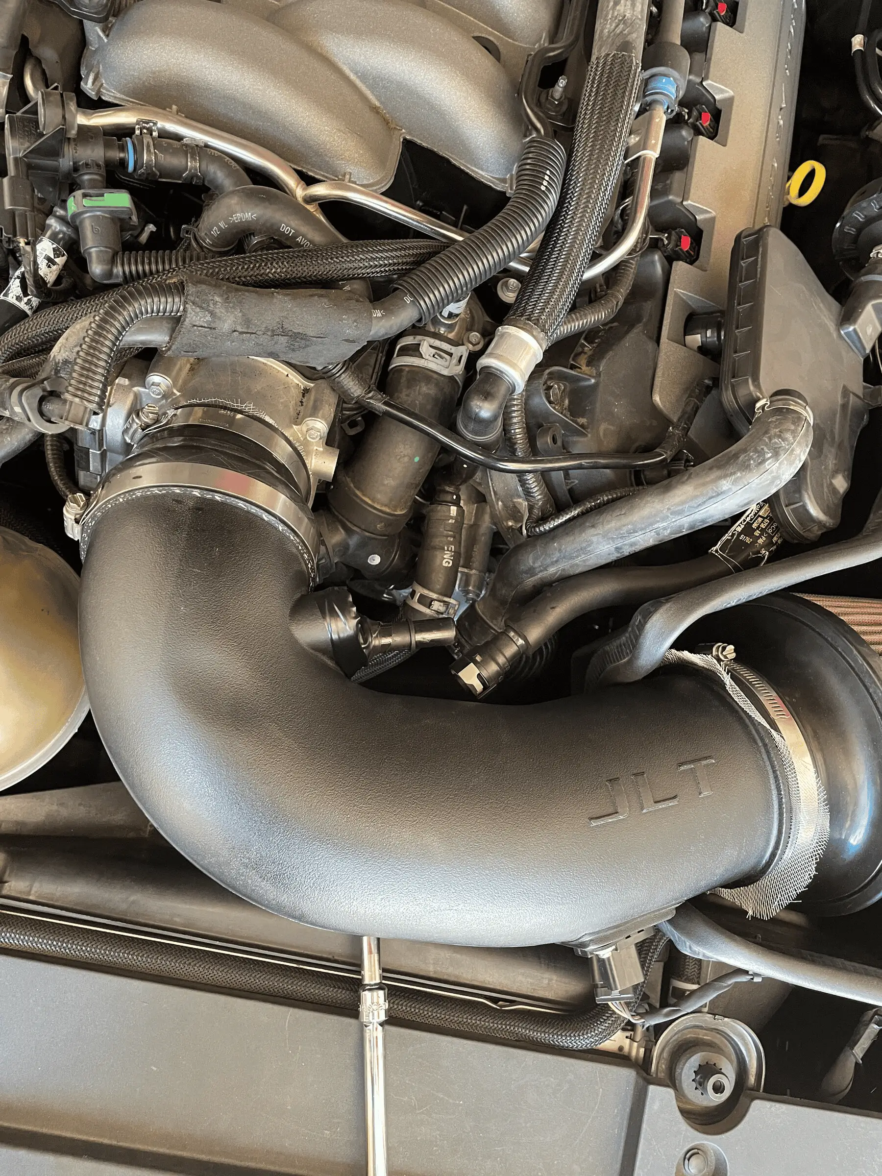

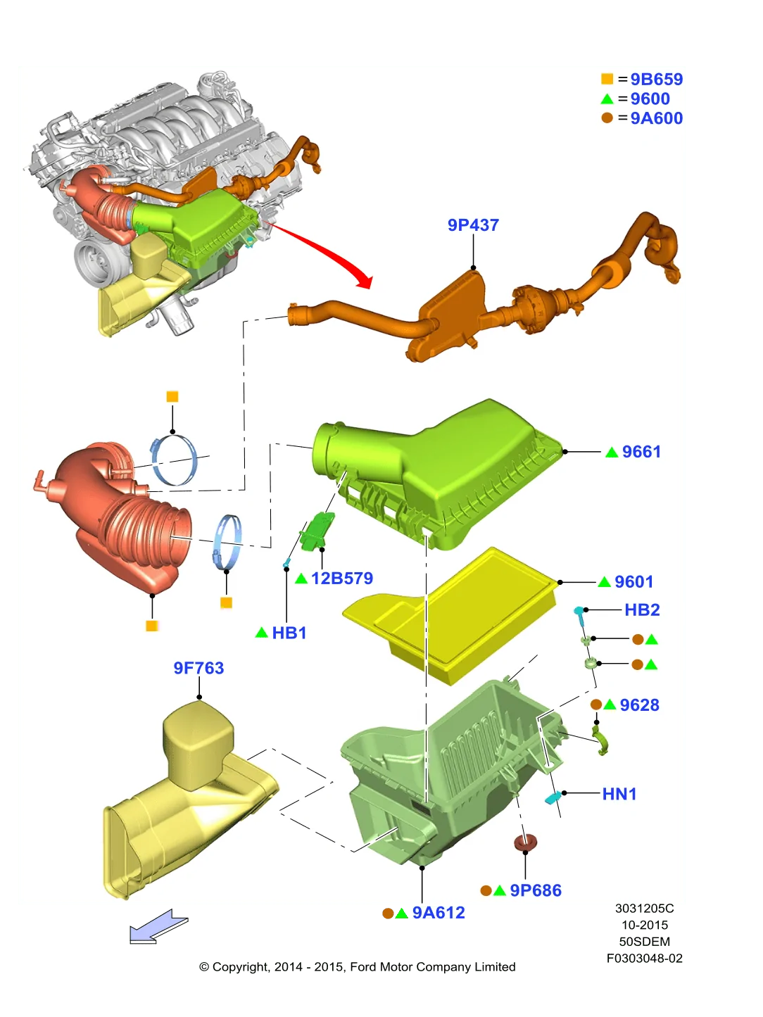

Does anybody know the P/N for the little rectangular Gasket that goes between the MAF Sensor and the mounting flange on the Intake tube?
All I've been able to come up with is this:
3L3Z-12B615-BA
But I'm getting mixed answers from Ford OEM sites.
Thx.

That's something that could be cut from some other material. It's like a flobbery bit of window sash insulating stuff.

Seems there is no added Gasket.
There is one that comes attached to the Sensor. Probably why I couldn't find it.
Sprayed the area with Propane no change in idle misfire. So that's not the problem.
Damn...
Damn...
If you think it's an intake leak just save yourself the time and get a smoke tester. Trust me it will be worth it.
I also couldn't find any part number from the ford parts website.

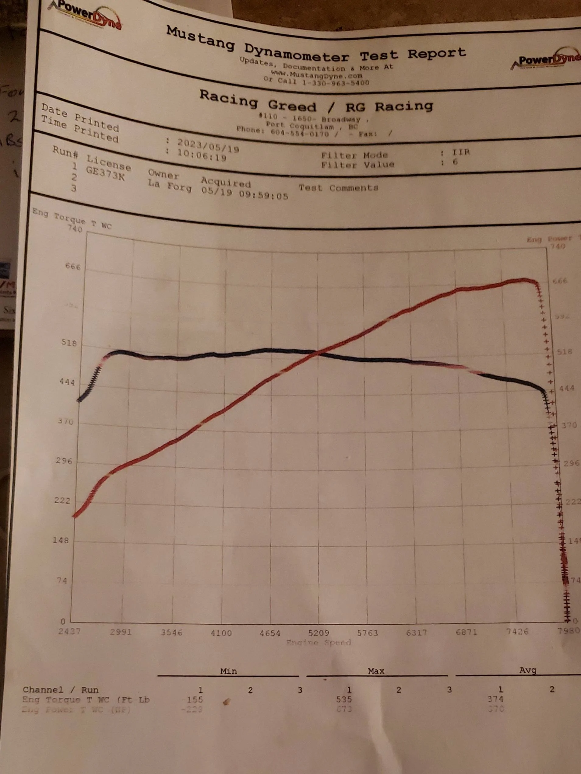

We've done 2 smoke tests, 3 Propane, starter fluid tests, new Plugs, new Coils, new maf, new tuner(tune)
New fuel return system, new gas, HPTuners Crank relearn, inj tested, fuel trims good, no knocking. Of course no codes. Vac at 20.3 on dash,Vac on AEM Gauge 20, Fuel pressure boost reference 49 PSI, AFR good.
Going for a Compression test next week new tuner wants this done before me doing any logging.
But on last tune it went
673 HP
535 TQ
Which is pretty much spot on for a Canadian octane 91 tune.
Would an unhealthy engine be able to pull these numbers?
Whipple Gen 3 3:75 pulley.

Only misfiring at idle? And if it's not throwing any misfire codes then it's not misfiring hard enough haha.
A compression test would be a good start. It's totally possible one cylinder is low on compression but just at a sweet spot where it's causing misfires but not enough misfires to cause the cel.
Do a compression test. I would have done it way before replacing my fuel system.
If a cylinder is constantly misfiring you will get a specific misfire code for that cylinder. Sometimes though, if one cylinder just isn't running right, for whatever reason, it will throw off the car causing random misfires. Usually, you will get a random misfire code.
If your compression test finds something, get a borescope and see if you can identify if it may be piston/ring, or if you are lucky maybe valve/head. Check for scoring on cylinder walls, damage to piston, and damage to valves.
If the compression test finds nothing, then find a shop that has a good engine code reader (snap-on makes a super good one). The one snap-on makes has the ability to count engine misfires and will tell you exactly what cylinders are misfiring. Even if no code is thrown your engine will count misfires and log them. This way you can see if you are dealing with certain cylinders or random misfires.

I got the fuel system cause I was having WOT misfires with boosta pump and OEM pump.
Instead of troubleshooting I just bought a return system which I was probably going to do in the future. It got rid of the WOT misfire but not idle misfire.
I've had it on a scanner but don't know if they were tracking misfires or if it could for that matter.
Nothing showed in the first tuners logs about misfires.
New tuner (Lund) wants comp test, in hindsight I should have done earlier. But car runs good except at idle so thought something mechanical.
Rings etc didn't even come into the conversation once the numbers were good on the dyno.
But if the engine is hurt wouldn't the numbers be even better?
Like I said earlier the numbers were what was expected for my set up. But if something is found in the comp test will check with Boroscope for sure.
By the way thx for your help.

I wouldn't read into the numbers too much.
Who was your previous tuner?
And Lund can't see any data about misfires that I know of. Try to see if you can find a performance shop or even a Ford dealership that will use a snap-on scanner to check misfires. When I was in highschool we had an automotive shop and I got to play around with the snap-on scanner on a friend's sn95 mustang. The scanner was able to read all the misfires on the cylinders. It can also pull up system faults that might not show up as cel. Since you aren't getting any data from the cel I would look into this.
Also how bad is the idle misfire? Have you tried unplugging individual coils to see if you can point to an individual cylinder? Is it a constant misfire or does it do it randomly?

Did you confirm a misfire or just think it sounds like you are hearing one?
So far 2 well known reputable coyote tuners appear to have the same issue so you deff have something going on with the car.
If you were semi local i would deff come out in person and find that issue for you.
We said nothing about not being able to tune the TB angle??? We tune the 132 all the time so not sure why you are sharing miss information??
Also the fuel system fixed the lean condition not the misfire.
Replacing that spark plug that had the cracked insulator fixed your wot misfire
Definitely a car issue.
What would you suggest for confirming the misfire?
My ideas were to unplug coil packs to identify a cylinder that is repeatedly misfiring and use a good scanner that can track cylinder misfires to try and identify random misfires or more complex misfires.
