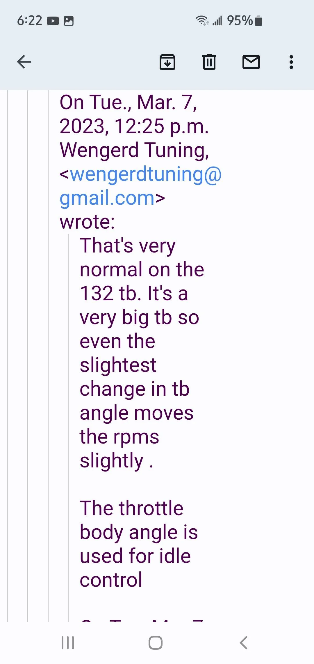

We said nothing about not being able to tune the TB angle??? We tune the 132 all the time so not sure why you are sharing miss information??
Also the fuel system fixed the lean condition not the misfire.
Replacing that spark plug that had the cracked insulator fixed your wot misfire
You keep repeating that it's my car 'NOT THE TUNE'.
Yes I know that, again I'm not putting this on the tune, stop saying that shit. I already said the fuel system solved the WOT misfire.There were different plugs in when it went lean at WOT.
You said the the Whipple caused the idle fluctuations seems others don't think so.
Of course I know there's something going on with my car. You think I'm spending all this time and money on nothing??
Do you think that I and others don't know what a stumble/misfire at idle is??
This your email saying the large Throttle body is causing it.
A jumping idle isn't necessarily a misfire.
Wengerd could have been referencing the bouncing idle you were talking about?
It is known that large throttle bodies on coyotes are hard to tune for and can have drivability issues and other minor issues (like idle fluctuations). This is common for those running the big monoblade throttle body on cobra jet setups.
The car can be just having a hard time controlling the throttle blade and can overshoot/undershoot the target rpm, hence the bouncing rpm.
