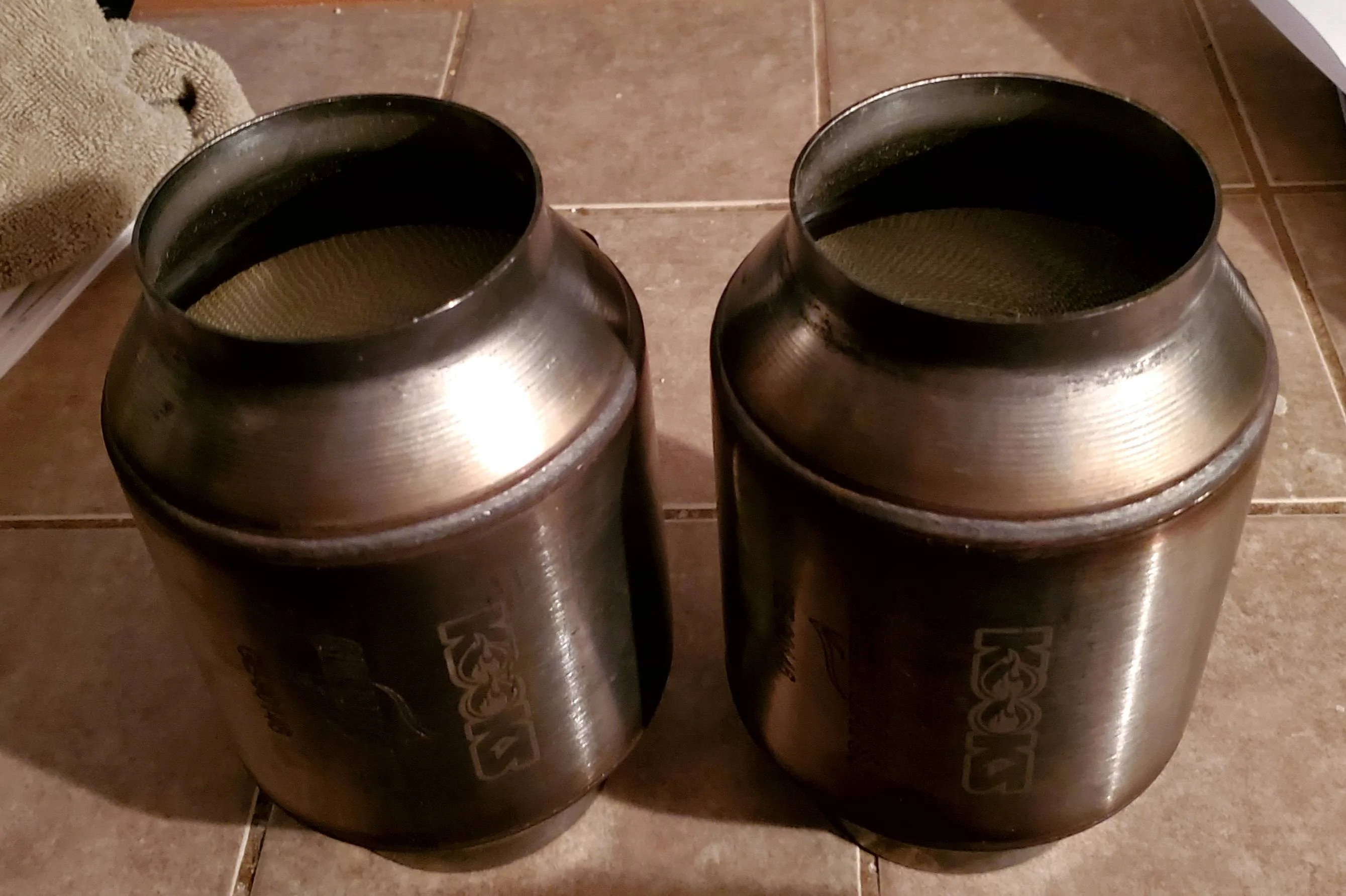

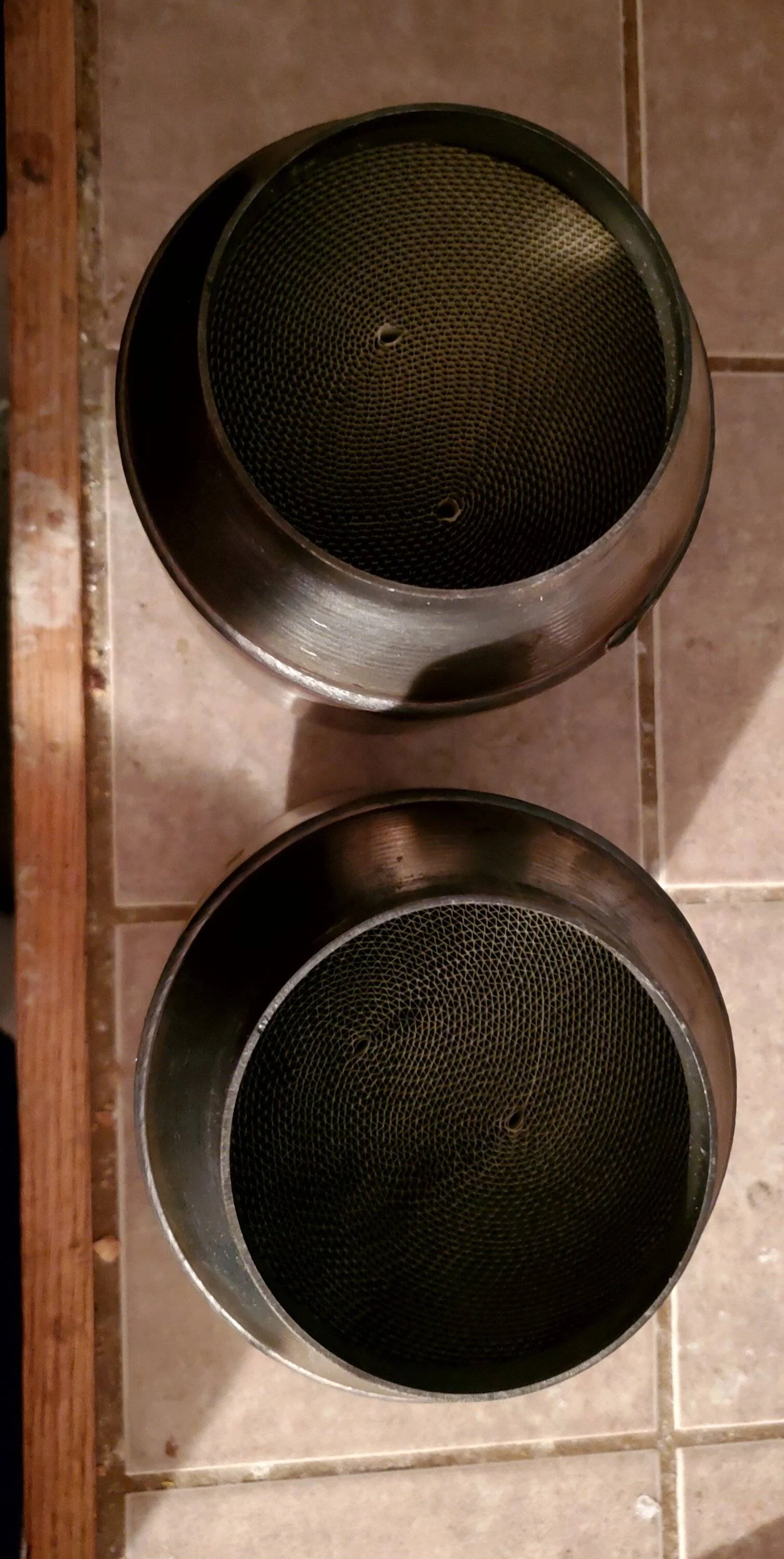

I just got a pair Kooks Cats today so will get them installed this week. Very well made and heavy as fk. I see why they're so costly. But that will take out the question of a clogged cat. Even tho I get no codes ya never know, which sucks. Plus I don't trust the ones that came with my headers.
