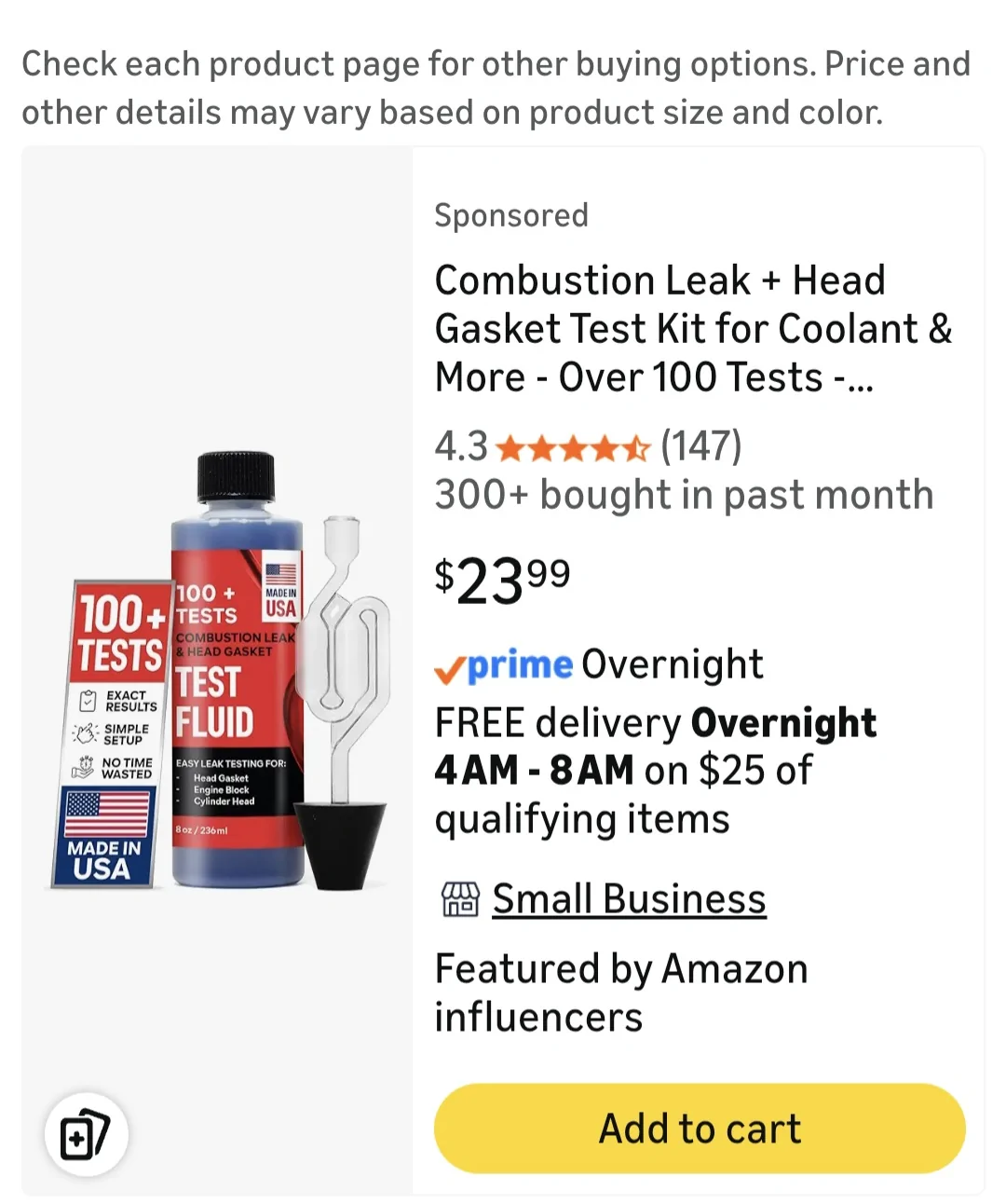

Have the anti-freeze tested for the presence of hydrocarbons. Any good mechanic can do this very easily and its quick and non-invasive.
