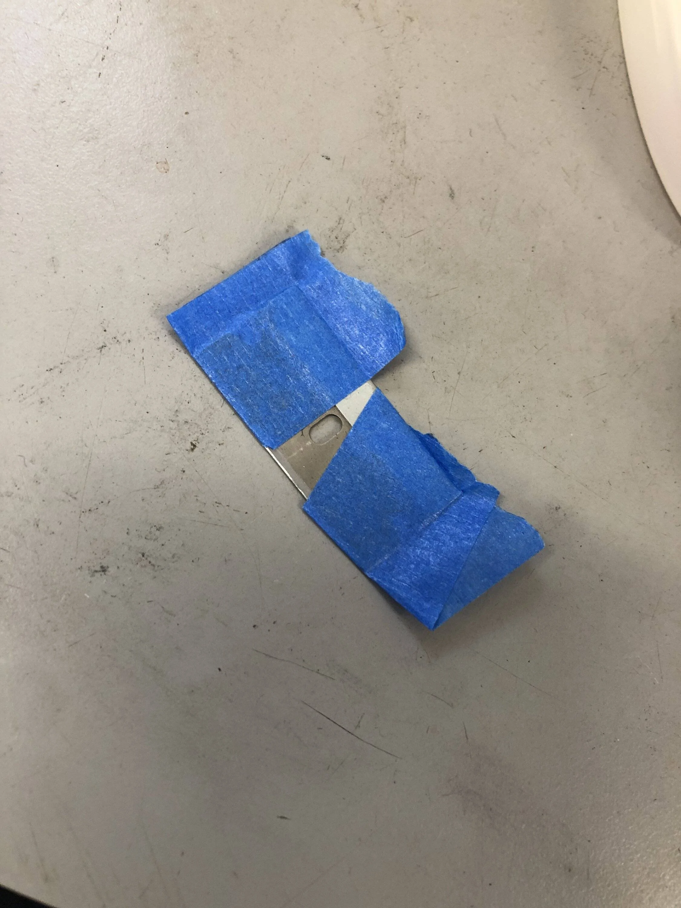

Well guys, I got it off. Didn’t damage the car at all. As you can see in the picture I put masking tape on either side of a razor blade and that was enough distance to keep it off the paint but the pop the logo off.
I tested with a "run razor", but wasn't comfortable with that. I tried any number of things, but this worked and not a mark on the car.

I‘ve taken a bunch off with a razor blade including just a regular decal/sticker, and never had the first problem or inflicted even a minor scratch. You have to hold the blade at the correct angle but really it’s pretty intuitive once you get started.
