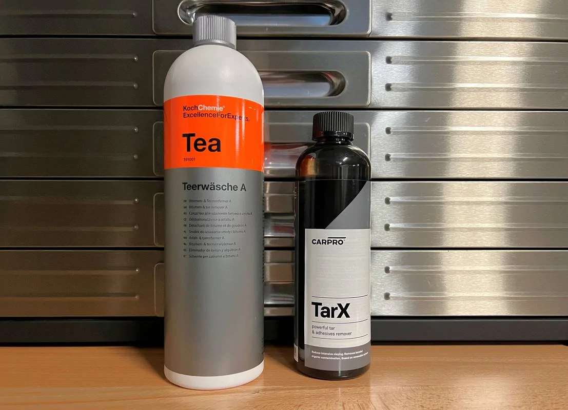

Another thing you can try is soaking a towel in boiling water, then lay the towel over the decal and allow it to heat through. This technique can also be used to remove old PPF or vinyl stripes. Another thing to try would be a steamer.
For adheasive removal and perhaps to soak in behind the decals, use some Carpro TarX or Koch Chemie Eulex -
Koch-Chemie Eu (Eulex) | Adhesive Remover | Obsessed Garage
CarPro Tar X | Automotive Tar and Adhesive Remover | Obsessed Garage
Both of those are used for Tar removal but they also double as an adhesive remover as well.

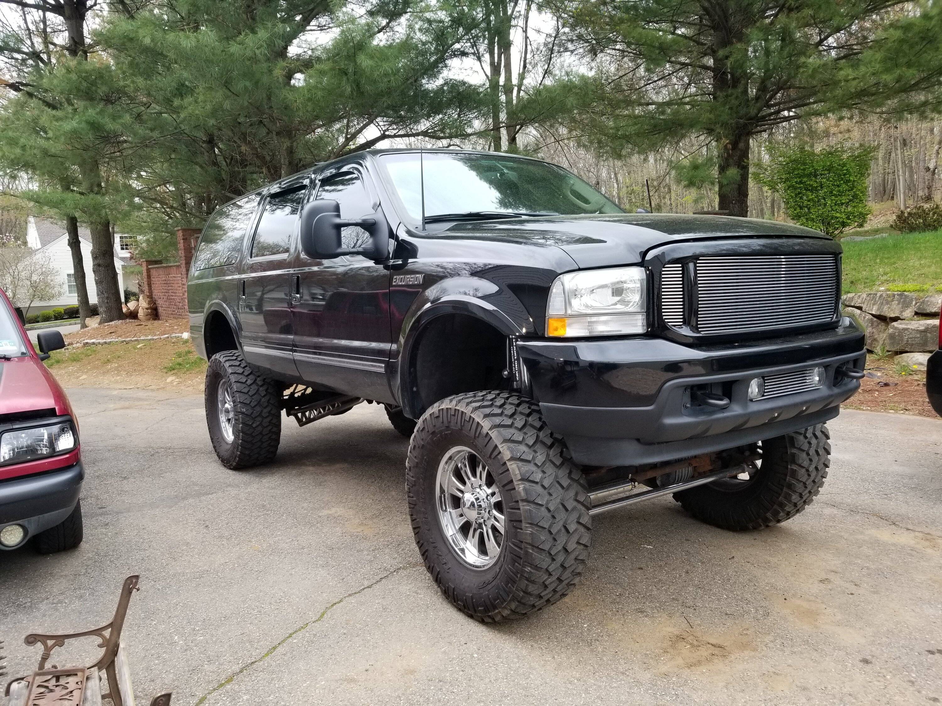

sweet ride, good luck with it... that excursion in the back though!??!nice! 7.3? I had one on 40s, miss it alot!

Thats clean low miles would bring decent money right now, but its too sweet to let go. Heres mine, built 7.3 It could smoke those tires on the stage 3 tune. I miss it dearly.
