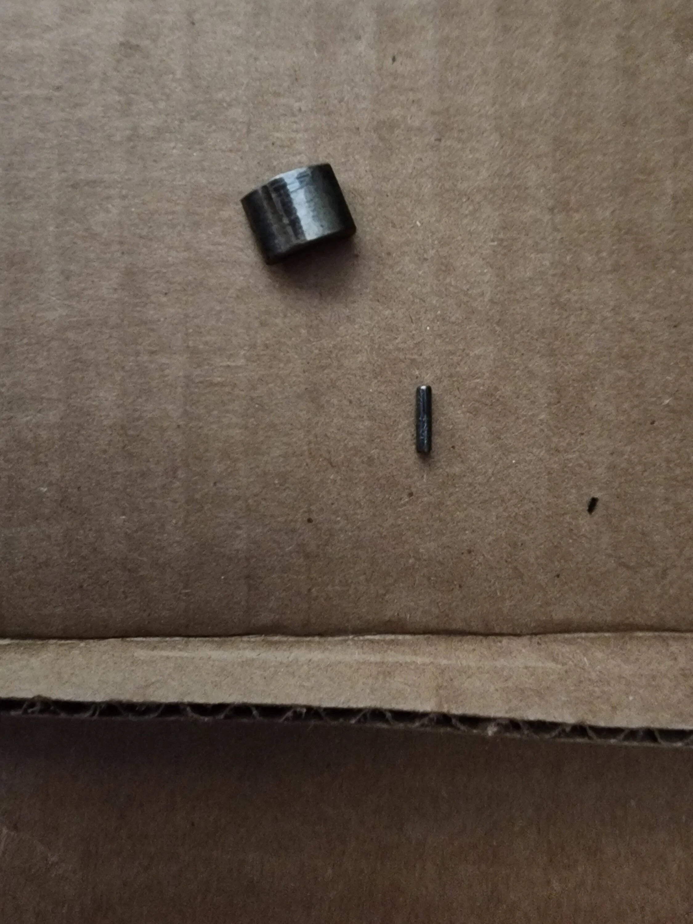

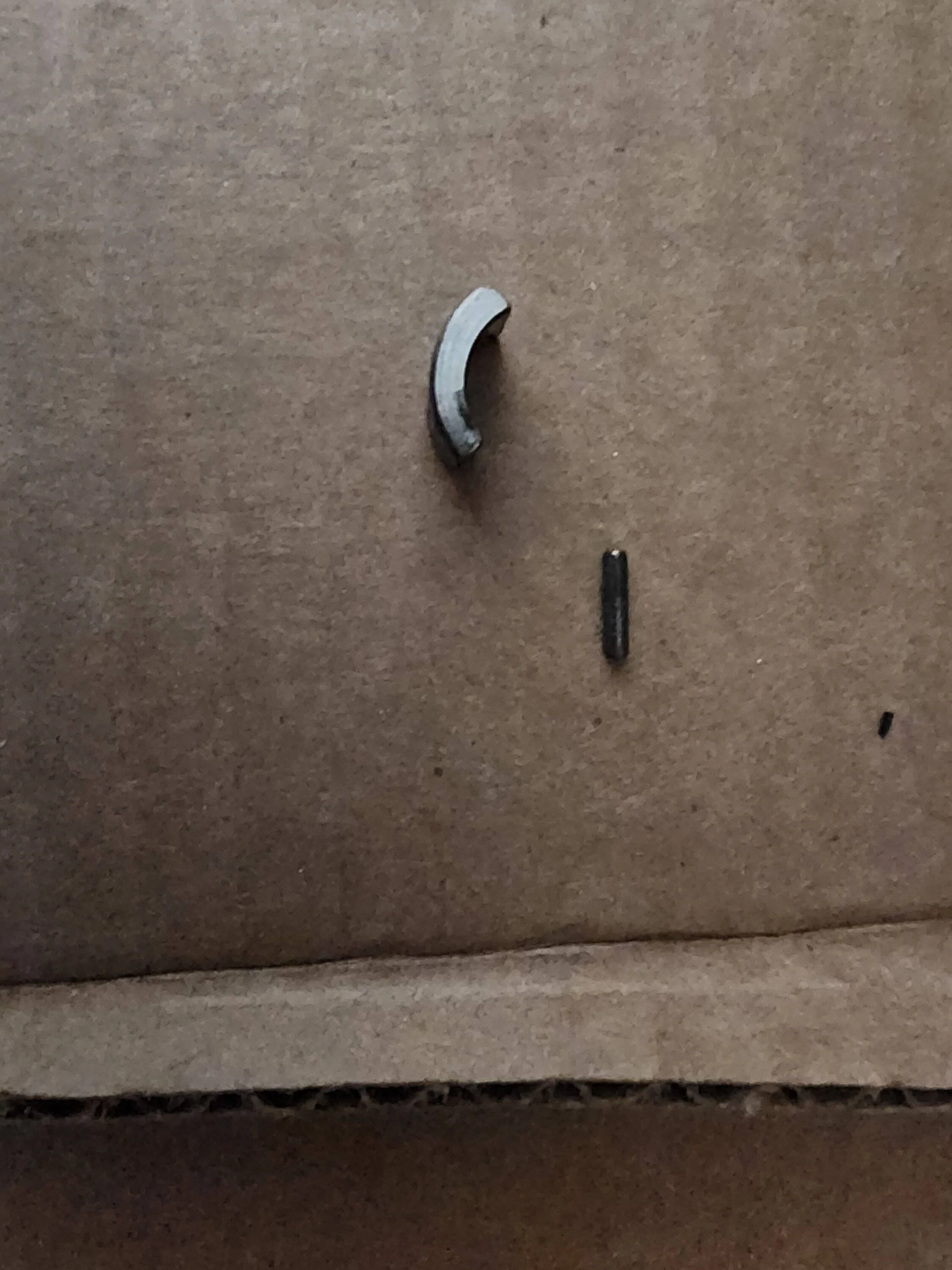

One more thing I completely forgot about was after I changed the oil and got the lucas out of there I found this in my oil. Any idea what it is?
Sorry work has been bat shit crazy and I wasn't able to focus on or post anything about this sooner and now I'm trying to remember everything thing...

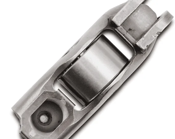

Looks like some of the roller and a needle from the bearing on the cam follower. The million dollar question is where is the rest of it. Could still be sitting on top of the head.
Looks like time for a tear down to me.

I am no expert but the seals are not in the port but on the stem inside the springs.
Yeah, it's impossible for fragments in the chamber to nick that at any stage. If it didn't burn oil before and now it does, there's very likely cylinder wall scoring. A borescope would confirm.
Couple that with a cam follower falling apart and I think this motor is ready to be retired. At least pull the valve covers and scope the cylinders to get more information.
