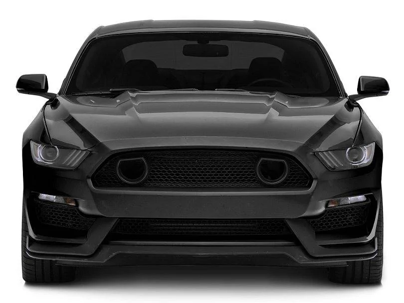

Every single aftermarket OEM style looks bad. Like every GT350 bumper looks bad from every maker, 15 style or 18 style. Maybe they're not allowed to make it exact, but the difference is enough that I don't consider them.

That MP concepts isn't even close. It's literally a GT350 style bumper with a Mach One style grille.

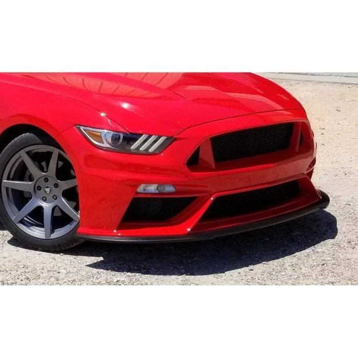

I would do the Anderson concepts TT style, but the built-in grille is a deal breaker, because how would you even black it out?
