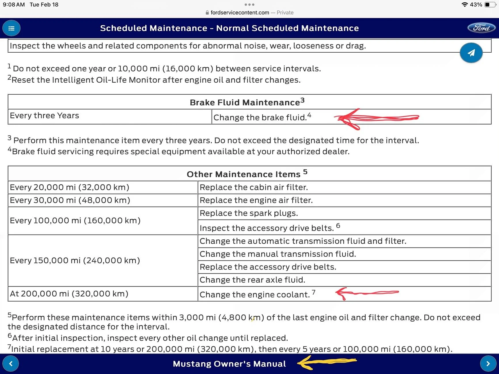

Incidentally the thing that motivated me to post this thread is that I've had my car for three years and haven't changed brake fluid, which I'm looking to do. Out of curiosity, I checked Ford's official maintenance schedule, and, as far as I can tell, there is ZERO mention of recommended brake fluid change intervals... Then I realized there doesn't seem to be any mention of other fluids like coolant change intervals either.
Is there a separate place for fluids or something? Or are they just suggesting that everything should be on an as-needed basis, and they don't want to suggest anything since people might be running different brands?

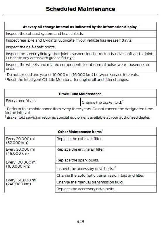

Worth reading the Mustang Owner's Manual. In the pdf version, there's Scheduled Maintenance section from page 441. Brake fluid is to be changed every three years, it's high boiling point fluid so it suffices rather than the usual 2 year interval.
https://www.ford.com/support/vehicle/mustang/2021/owner-manuals/
I'd definitely change the automatic transmission fluid in the typical most recommended 30-40k miles interval.

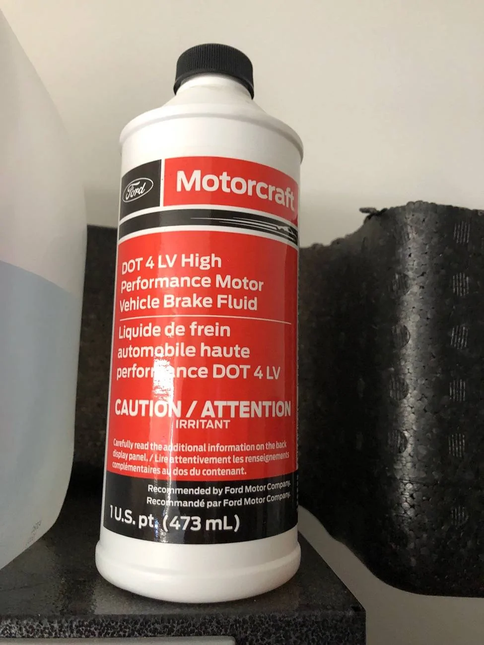

Mine is coming up on 3 years, definitely got the brake fluid on my radar this spring. Already bought the fluid and have the Motive power bleeder..
And this is the fluid I used in my 22 GT and plan on using in my Mach 1 as well...
https://www.amazon.com/dp/B003479F66?ref=ppx_yo2ov_dt_b_fed_asin_title&th=1

note #4, "requires special equipment available at your authorized dealer"
What equipment are they referring to? I assume any competent independent service shop will have what is needed, not just Ford?
