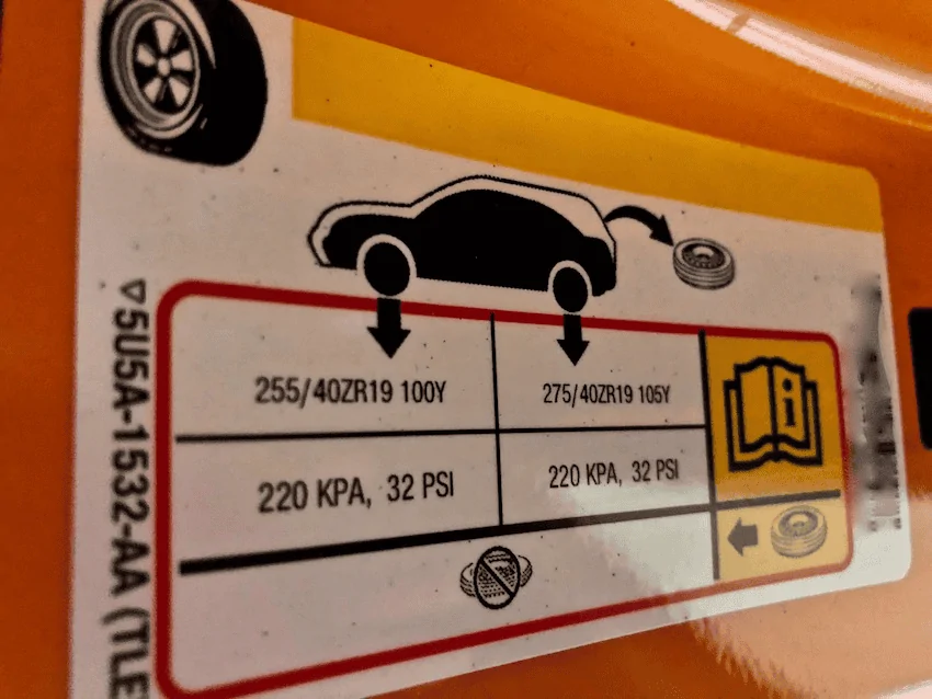

Do they really write you a defective equipment ticket over a clearly stupid load rating value?
Yes, it can happen, depends on what you have been pulled over for. If it happens the car would have to be towed or correct tyres installed before driving off.
Frustratingly, 295/35/19 4s tyres for the rear are 104Y.

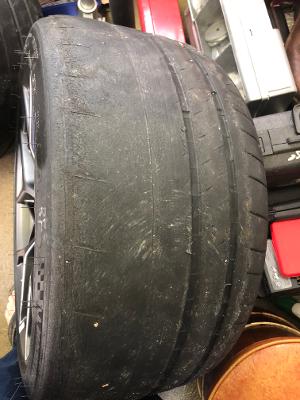

Don't believe that Cup2 Connect is what's on the M1HP. Ours are more aggressive, stickier and less deep groves.
Here's M1HP Cup2 with 100 (Track) miles. Plenty of tread life left but not the Cup2 above.
Back to tramlining, S4's will fix it.

Driving the cup 2s around the Midwest all the way to California, I felt the tires had a very interesting response to the road.
At the end of the day, I believe my var was tramlining all the way through. Driving on the local roads now as well- I feel the same.
Does anyone know if this tramlining is a feature or a bug in these handling package cars? I am gonna get rid of my Cup2s soon and move to Pilot S4S and then take it to Ford for alignment but that’s a few weeks/months from now.
It wouldn’t hurt to verify the alignment specs but in my case, ps4’s cured it instantly. As @shogun32 mentioned you are most likely not going to get the advantages of the cup2’s on the street but you will get the negatives. My brief experience with the cups was that the car felt very nervous like it wouldn’t settle down.
I would live with that, how could police even tell what has to be there in the first place? We don't carry car's technical certificate which is the only paper where wheel and tyre sizes are written. So they check it only at technical inspection.
I'm kinda in same spot but nobody will make a fuss about 104 vs 105 when the tyre has correct size (I have it written as alternative to vehicle's technical certificate, without stated load index as that isn't in TĂśV approval for other wheels that I used as a template either).
It's common that lower profile has bit lower load index. For example PS4S 315/30 R19 is also 104Y. 305/30 R19 is 102Y. The car doesn't mind.
We have a tyre placard stuck to the inside of the door, if its missing its easy enough to check the cars details online to confirm. Its a basic roadworthy check in Aus.

@MLO 351 And how does it work with aftermarket wheels, say 20"? Those are not on the sticker so you'd have some other paper for them. Make that paper and be done with it, I'll send you TĂśV certificate for this size :giggle:
Regardless of wheel diameter tyres must meet or exceed the Manufacturers load rating.

Only reason for the 315s in the back are so you don't confuse the difference compounds. Cup2s are a much stiffer tire with much sticker tread. They want to be hot and driven hard. Some times one tire might be a bit warmer then the other side which gives it a bit if pulling. They do get a bit better after some heat cycling but they will never be the same as a dedicated Street tire. Ford did compound the tires knowing they would be driven on the street and they actually have good wet weather grip, they just lack confident hydroplaning resistance.
Because Race car.
The Mach 1 comes with the gt350r cups. They do not have good wet weather performance. the regular gt350 cup2’s which are a different tire are the ones that are suitable for wet surfaces.
