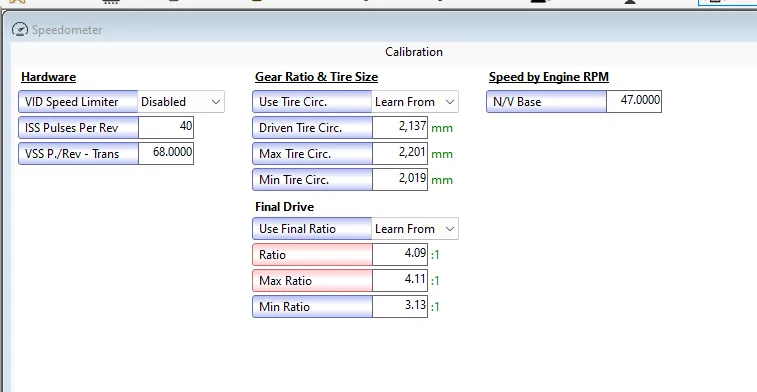

So by your own admission, your addition of the 4.09 gears messed things up? I am not sure Lund should be blamed for that. I am fairly sure on 15-17 cars, you can't really change the gear ratio from just a tune. You need Forscan which may or may not actually work or you need something like Whipple Flare tool to physically change the value of the gear ratio. At the very least it sounds like the gear ratio has caused unintended effects.What I discovered on my own is that not enough is documented for the 2020 cars yet to fix this problem...basically, I knew that the gear ratio value was assigned at a different address because changing the accepted address (for 2018-2019 cars)screwed up other stuff...
Also as WildHorse mentioned, the tune does other things besides increase power. Now maybe you are not happy with what those other things are... but I think this result is at least partially your fault for installing the 4.09 gears without realizing what would happen. You live and learn. I've many times had to re-do things because I didn't do all the research I could of or wouldn't think to look.
