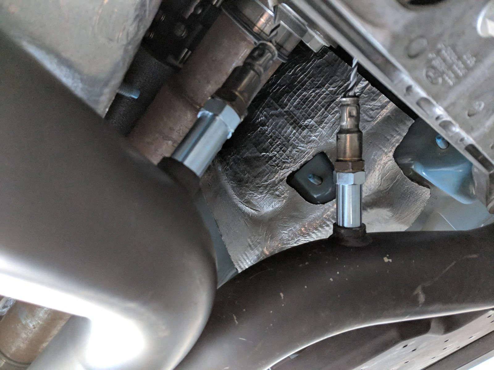

I've got my O2 spacers on. I'm going to flash back to the stock tune today after work. If I get them to light up, I'll go back to my tune that supposedly has the O2's on and the emissions controls all there and test it again to see if it sticks. If not, then I'm out of options, but I think I can pass just fine with those two red.

Good luck man, you should be okay with the 02 spacers and stock tune.
I will be adding cat deletes now since my car won't pass with cats anyway. She will appreciate the extra ponies.

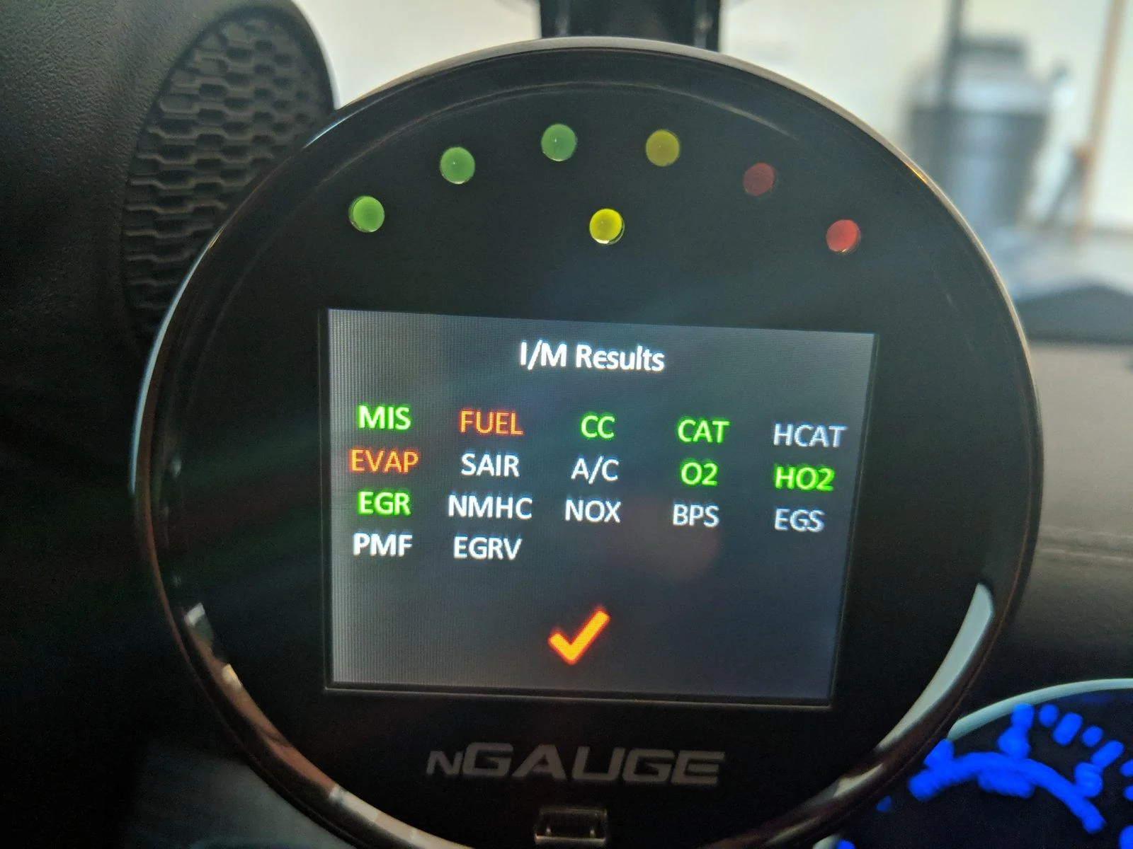

Stock tune with these:
Going to flash back my Lund 93 tune with emissions on. Not worried about EVAP because that requires more driving so I know it works.
Man the stock tune sucks so bad, lol.
