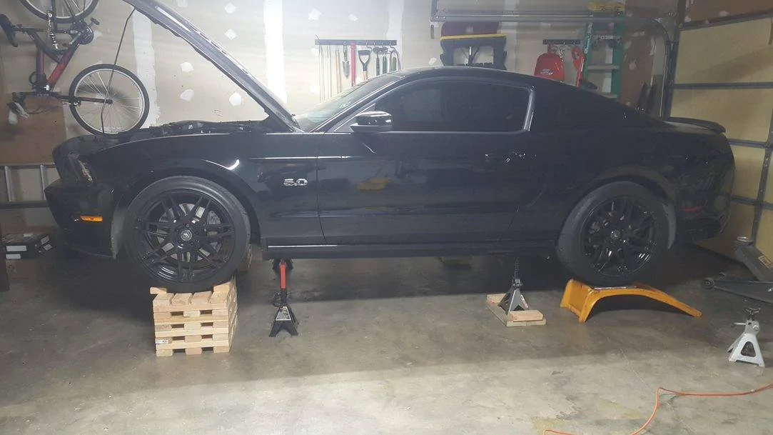

Oh ok. So I need to retorque with load on the car. I should be able to do this myself then. I have 2 metal stands & 2 wooden stacks that I use for my cars for when I do jobs like the clutch or trans. Cant seem to find a pic of the metal ones but got one of the wooden ones. Thanks for the tip good sir!

That would do it!
