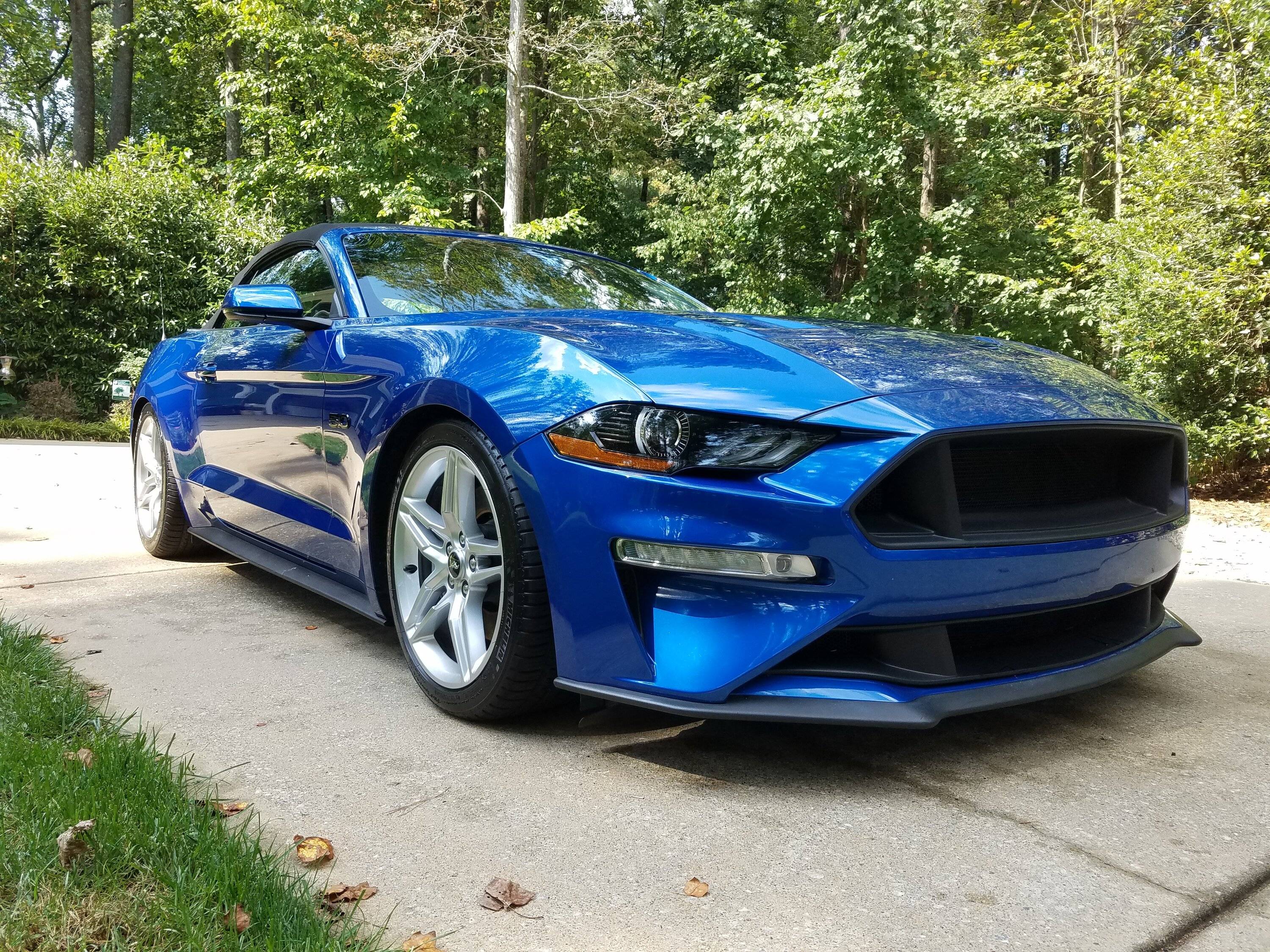

Yes to the spacers. The middle size worked for me with my Steeda progressive springs on '18 GT vert.

Got any side on pictures? I don't want to slam it, it's just a weekend toy not a daily. But our roads here are shit

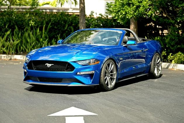

Here is Rodney's Convertible - running on Progressives:
