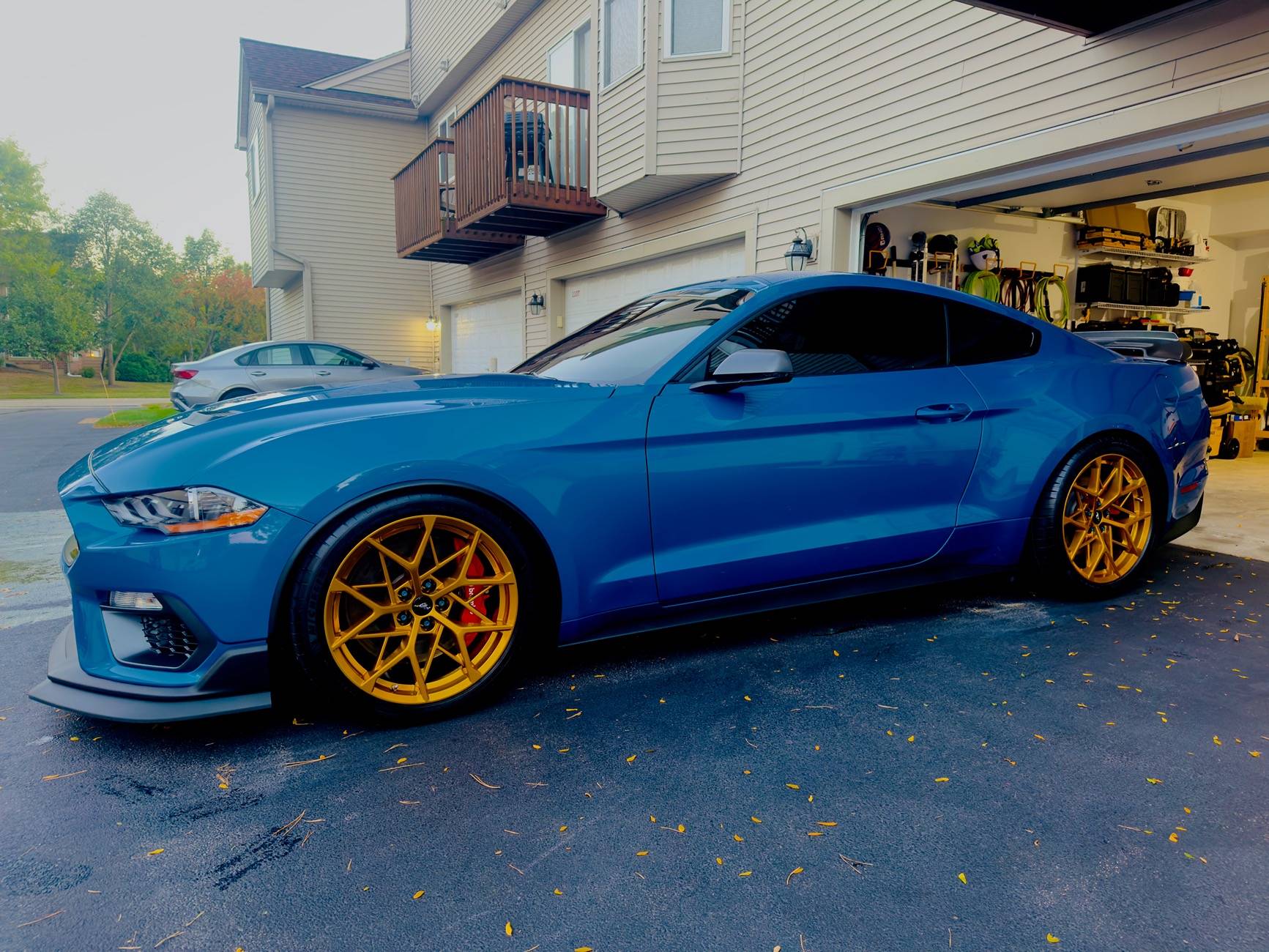

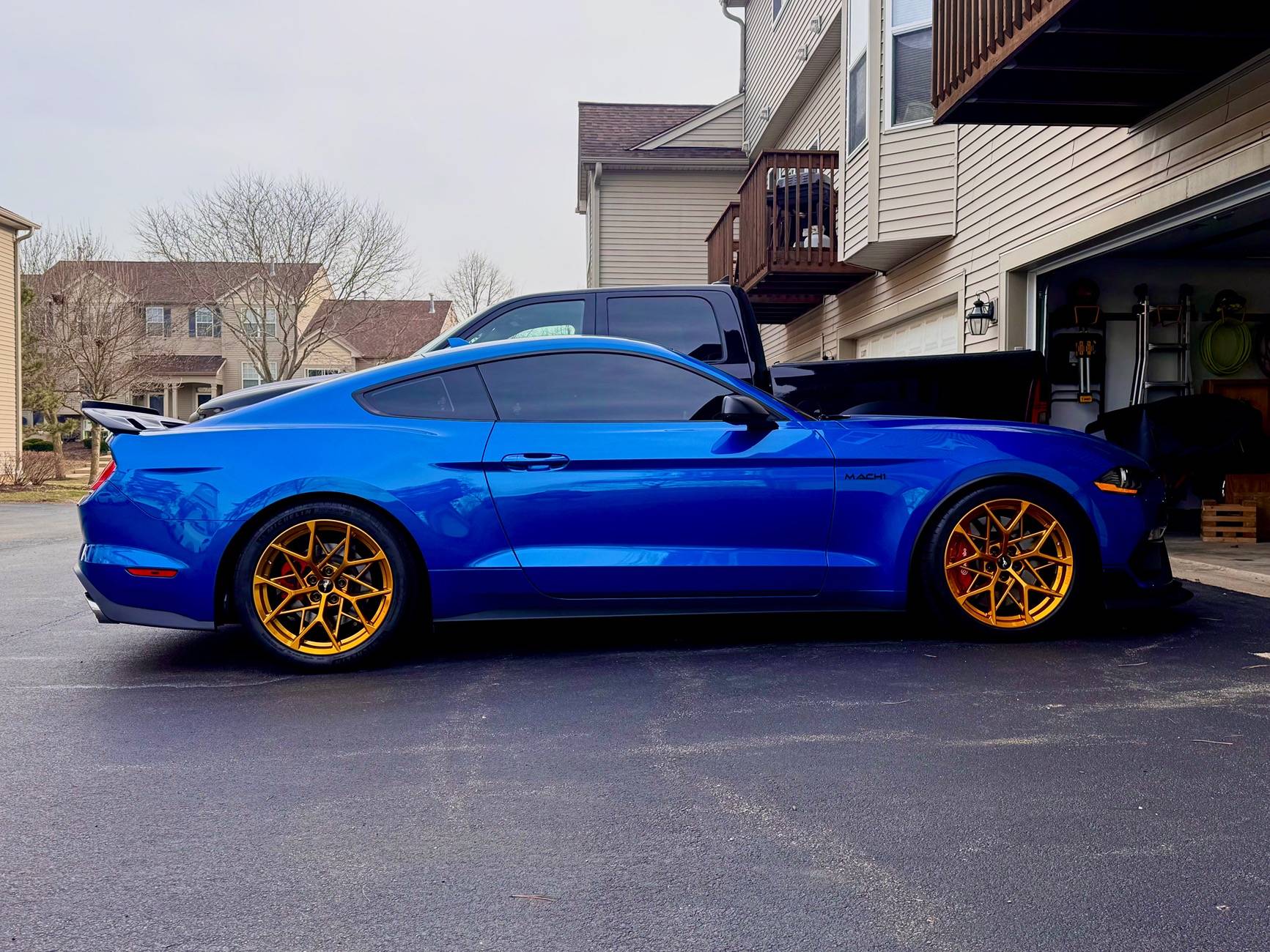

Don’t overthink this. The one dude on here is out of his mind telling you that you need new shocks and struts amongst other things. It makes zero sense to me and I am never the one to cheap out on stuff or take short cuts. I lowered my Mach 1 on the Steeda Progressives and the ride height was great, no impact to ride quality and no issues with the alignment. If you are super worried about it I can sell you my Ford Camber plates as well since I am not using them.
This is my car on the Sport Springs.
This is it on its new setup with the Steeda Dual Rate springs.

That looks sweet. Thanks. I do have a tendency to over think things LOL. It’s just that it’s my first Mustang, it’s really nice, and was a little on the expensive side (at least for my budget) and the last thing I want to do is screw it up. You have the look I’m wanting to go for though. Nice car my man!!
