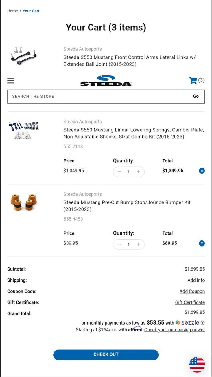

I respectfully disagree. $2-3K, for doing lowering springs properly? Are you nuts?
Math is hard for some.....
Springs + Struts + bump stops kit+ bump steer kit + camber plates (may be optional) + install + alignment.
I don't even have to add this up and can tell you this is $2K +
For 1” drop lowering springs, none of this is necessary…

OP has a Mach 1, so magneride. Shocks, struts, bump stops and springs you listed won’t work on his car. Just saying this for info, don’t want the OP to place an order based on this parts list.

Yes, it has MagneRide. I was looking at the ones specified for it. I was just hoping to get a set, install them, get the alignment checked and let her roll. But if I have to do several other things as well just to get rid of wheel gap, it’s just not worth all that to me.
