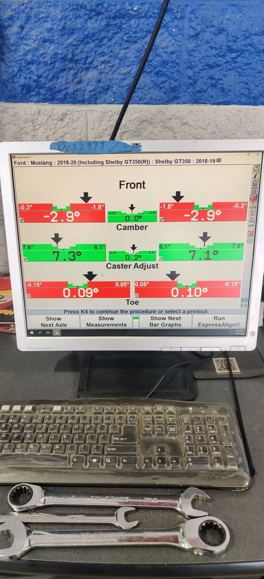

Hello everyone. I just installed FP lowering springs and FP adjustable strut mount plates to my 2017 GT350. I achieved the stance I was looking for but have a question if anyone has run into the same situation. I went for an alignment today and they couldn’t get any more positive camber than 1.7 degrees on the drivers side. Passenger side was 1.1 and didn’t need adjustment. The car was lowered 1/2 inch with the springs, so not earth shattering. We rectified this by installing a camber bolt on the drivers side and got it to spec. Anyone run into the same problem with these FP plates? And as far as the camber bolt, it was placed in the lower hole. Just want to make sure that is the right location and not the upper hole. Thanks...

Yes the camber was at 1.7 and couldn’t get it to 1.1-1.2. I’m assuming I cant move in a positive direction and only go negative from there?

OK - you mean negative camber then and you can’t get it closer to 1.1 deg neg. I misunderstood your post.

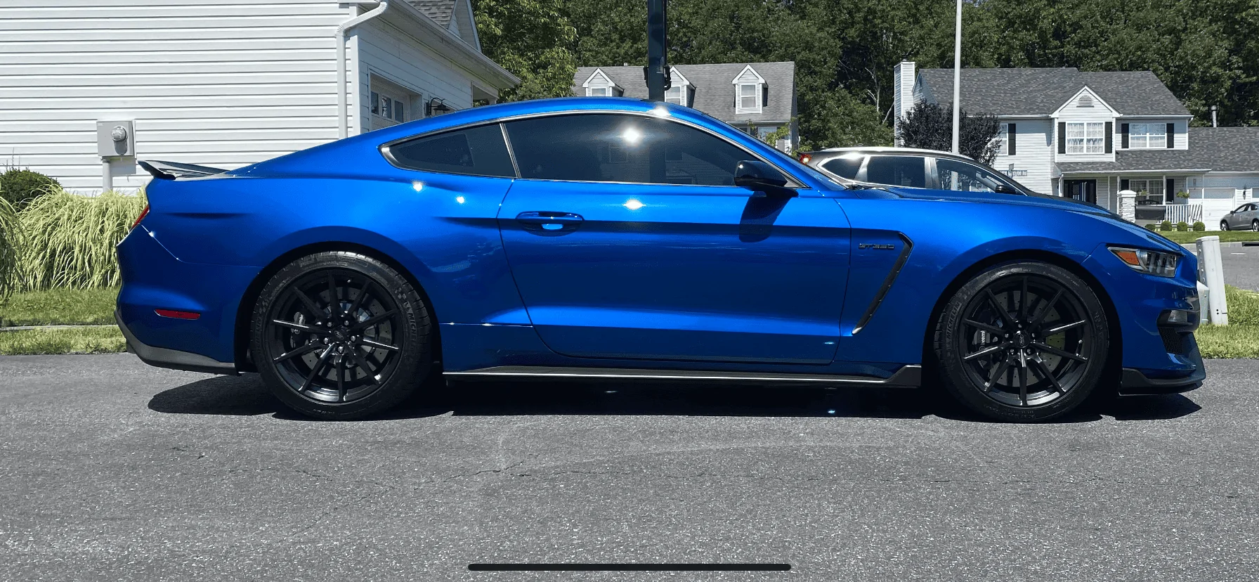

I’ve been overthinking this...and after speaking with a buddy of mine that’s exactly what we’re going to do today. Take out the camber bolt, put back the OEM strut to spindle bolt, and run at least -1.7 on both fronts. Done. Here’s how she looks with the drop by the way...

So we got it on the alignment rack and could only get -1.7 on the fronts. We re assuming the plates were installed wrong and will disassemble.
