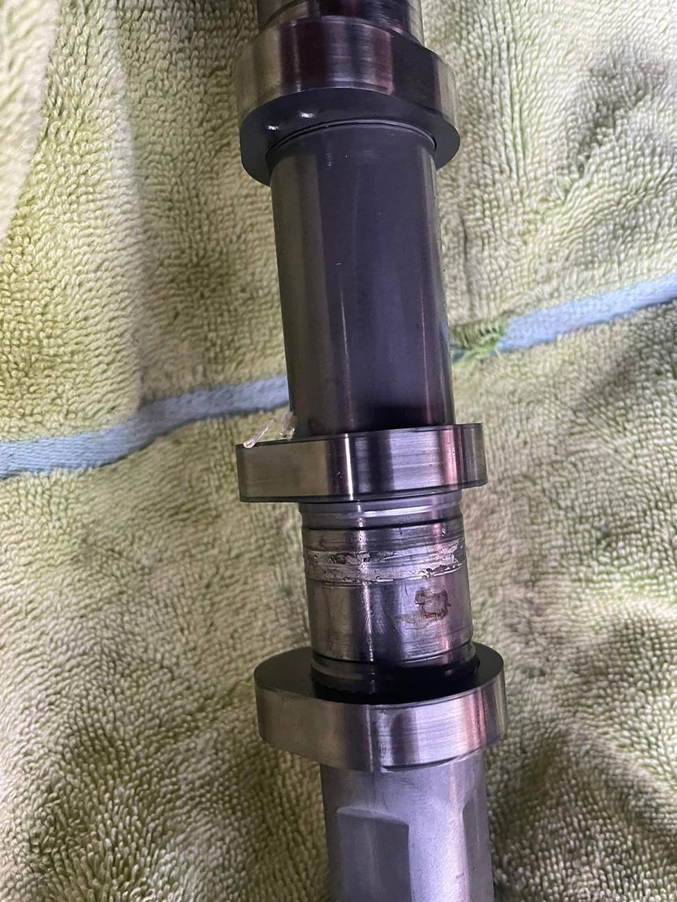

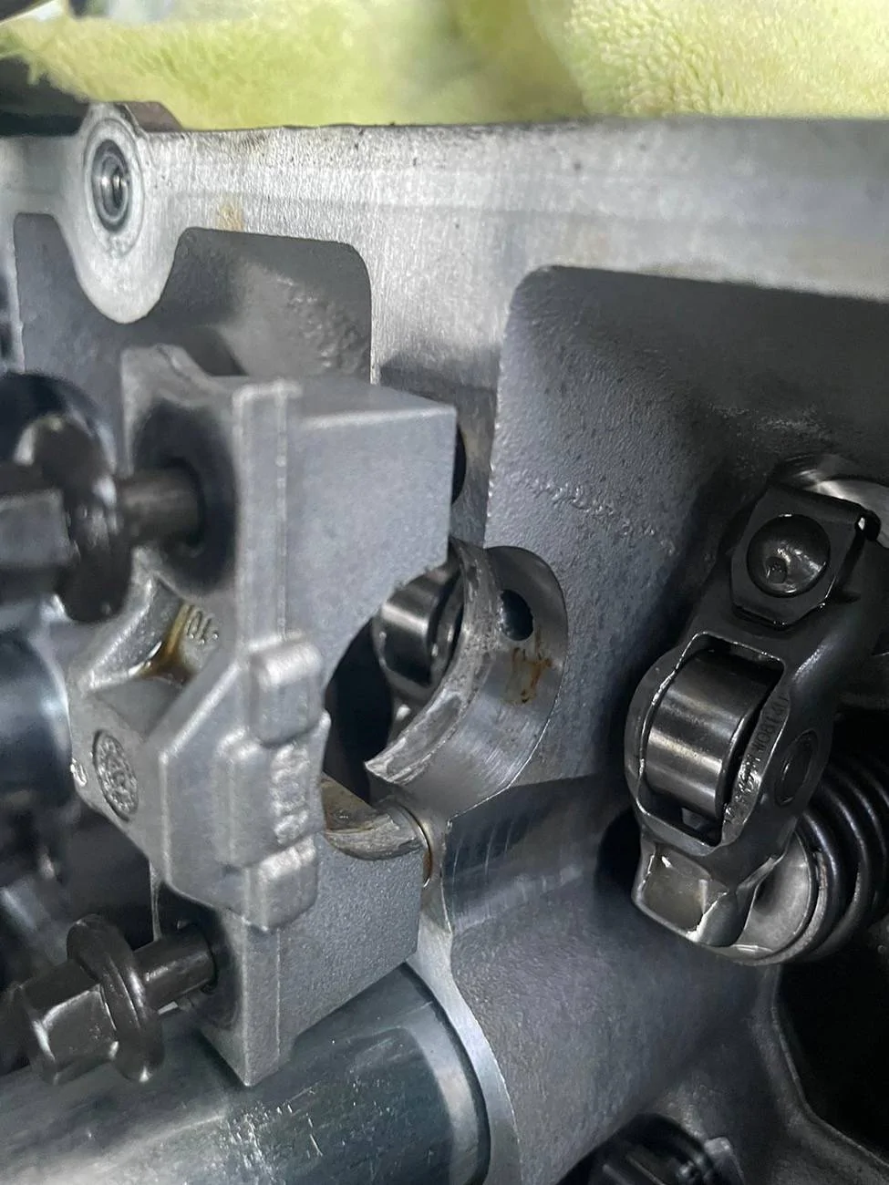

Well update on this. the no Oil caused this and made the Cam got suck which broke the chain.
till now by the test I have done only 1 valve was bad. But I am replacing the whole head with new valves and cams just to be sure. ( piston heads have been checked and they were good. the thing is they the car was started but not driving which I think is why my pistons are ok)

That's a lot of metal to go through the engine. Hopefully the mains are not damaged.
