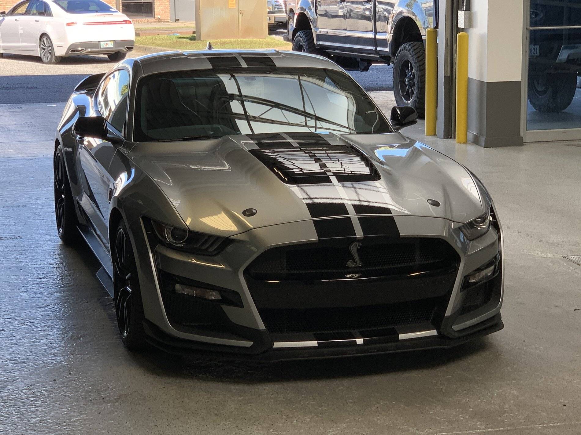

Well, I’m at the dealership waiting while they install the new part. Hopefully this will be a good fix. Apparently the side splitter/side board had to be painted prior to installation. I had no idea that these were painted parts.
Here’s a pic of it waiting for the work to be started. JMO, but I think the C.Quartz shine is looking good.

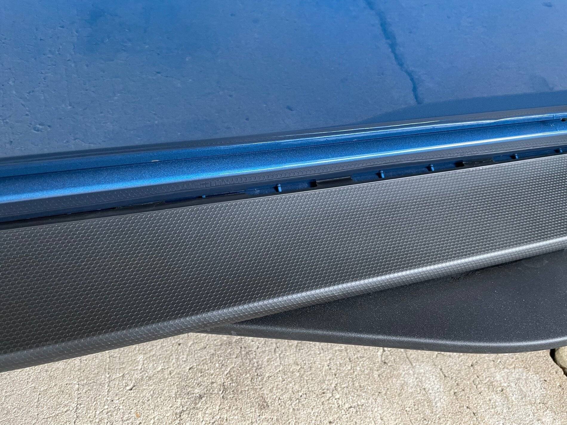

Not super stoked. Noticed mine is loose on the passenger side too today while washing the car. I'm 99.9% positive I didn't take delivery of the car like this but have no idea how it could have come loose on its own.
Also not super stoked to learn that the splitter / splitter extension parts aren't sold individually by Ford. Very hesitant to have the dealer touch the car as I've had really bad experiences with dealerships in the past.
Anybody here installed the Anderson Composites carbon replacements? It looks like they are at least sold separately from the unpainted rocker piece. If so, can the fasteners be re-used or are new ones needed? I tried to look online for OEM part numbers but not coming up with anything...

Update on this issue: a mechanic friend of mine put the car on the lift, took all the bottom pushpins out, wiggled the splitter a bit and it snapped back in place very easily. Not sure what the deal is/was. I'll keep an eye on it to make sure it stays put.
