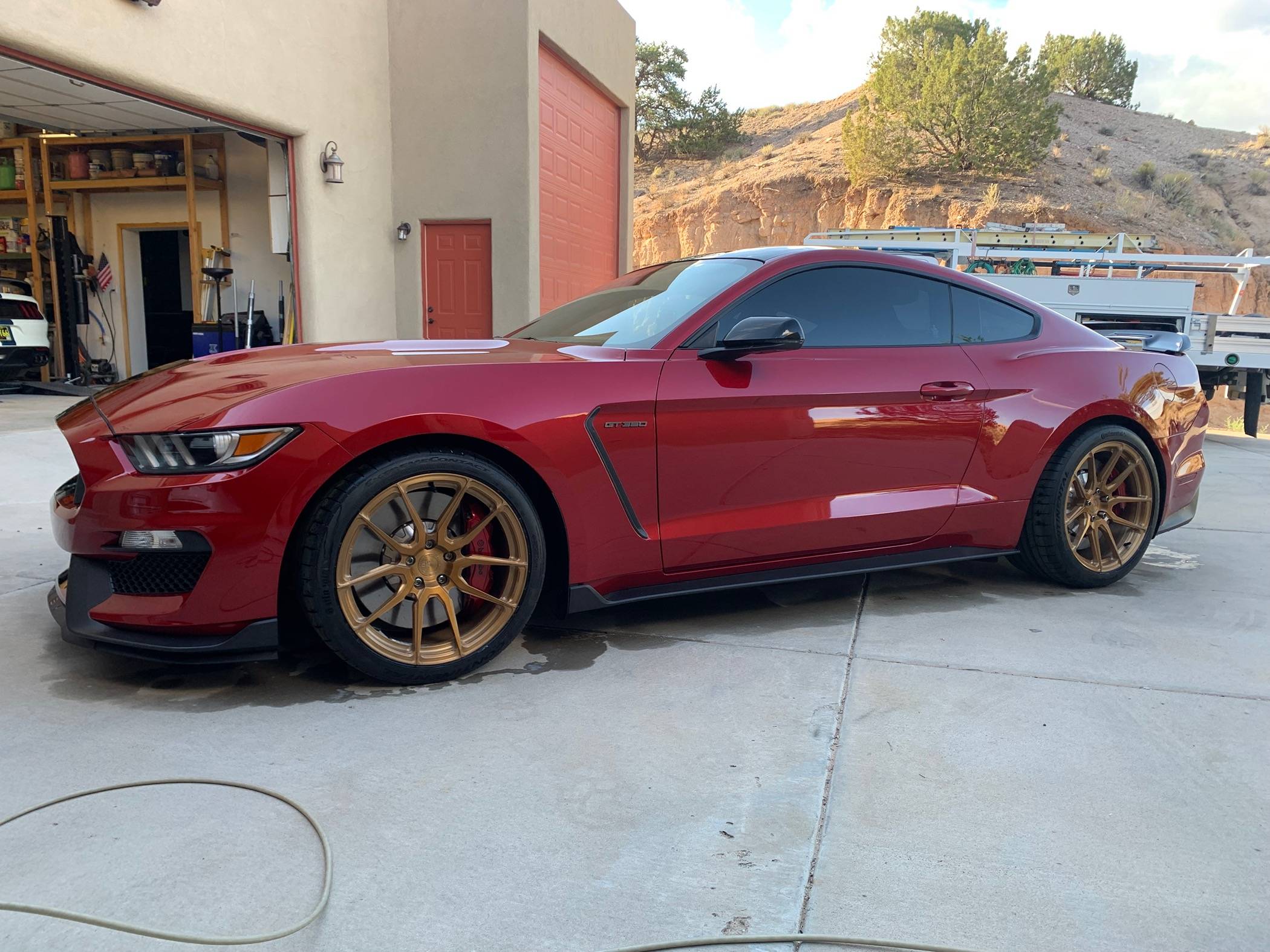

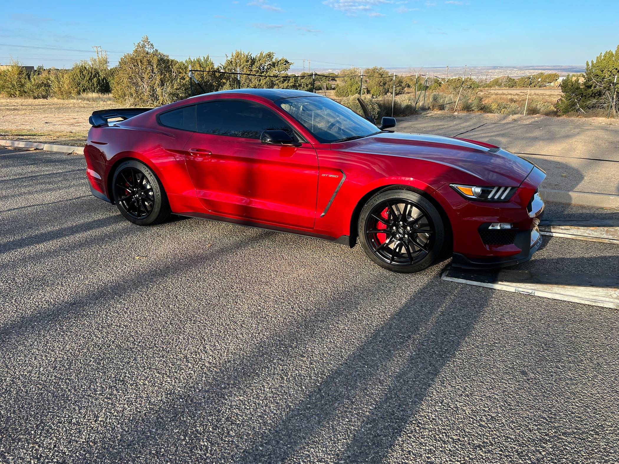

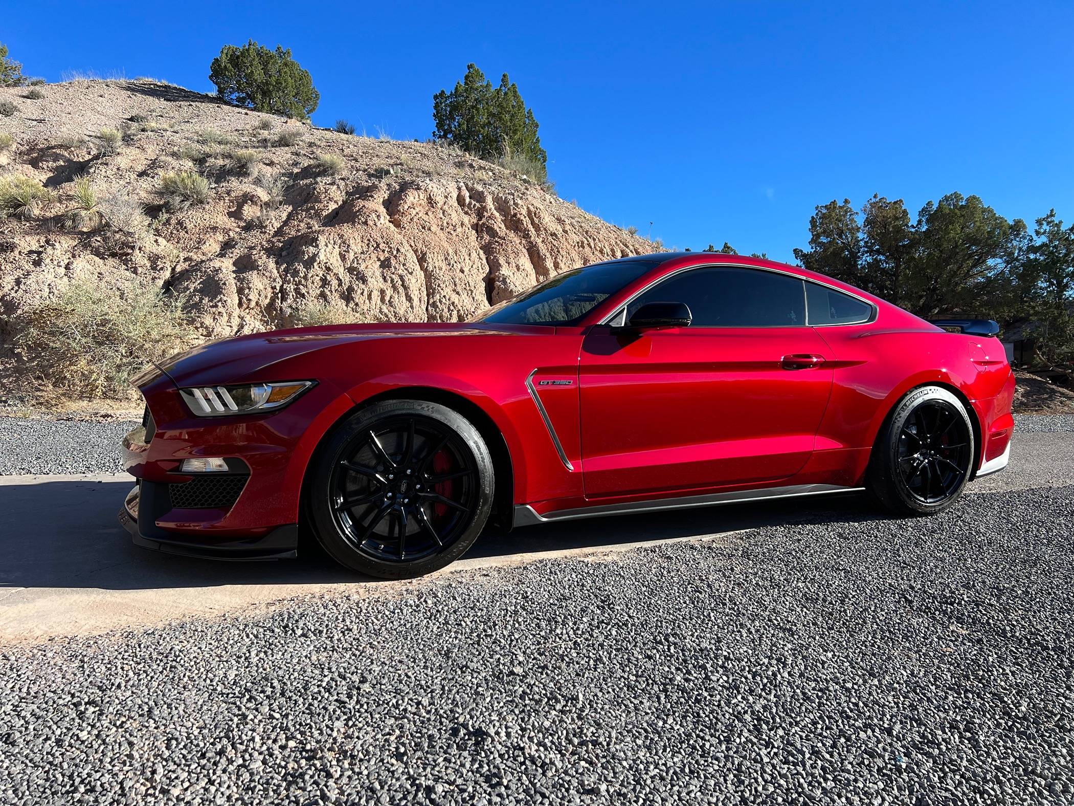

That’s a new one. Regarding the rake getting worse. This is bmr’s with factory wheels on my old 20, and with r spec bc forged. And then the fp springs on my r.
Looks good. That red is one of the best colors for these cars. If I had to do it again, I would look hard for that color with some sort of stripe. Especially with those gold wheels.
Did you do before and after measurements? My change was coming directly from the DSC. IIRC, 20mm front drop, 11/12 mm rear drop. This was after taking the car around the block to get things settled. And the rear number never changed after that.
