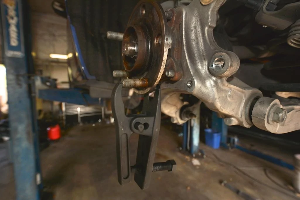

Lots of good info in this thread, hopefully its ok to revive a semi old thread. Glad I found this thread as funny enough I had found that you could go with 1/2 ARP on the S550's. I plan on going with the ARP 100-7703 possibly in the near future. I miss the longer studs I had on the 07' racecar.
BTW I plan on trying the ball joint separator method to remove them and using the Lisle wheel stud installer tool. In case anyone is interested, here's a vid of using a separator to remove the studs.

I went with the 7703 (or 02 ... whatever Cortex does). Love em. Had a local machine shop take off some length and clean up the threads.
Yes, the ball joint tools will take out the studs. I recommend some kind of penetrating oil first. This technique will prevent damage to your wheel bearings. Pretty easy actually. And keep the threaded rod greased up. I greased after every other stud. You can get through at least two hubs worth of removal. My Harbor Freight tool took a dump after using the tool to put studs back on (after 3 I believe so don't get too optimistic). The threads just came off the rod. Note: the front hub is really easy to take off and a hydraulic press will work much better. I only used the technique on the rear (didn't want to mess with the drive shaft and all the one time use bolts on the hub).

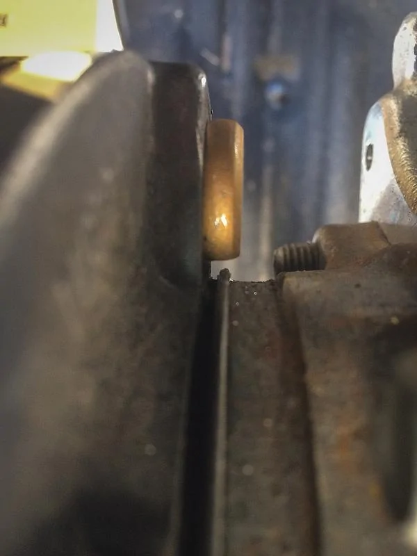

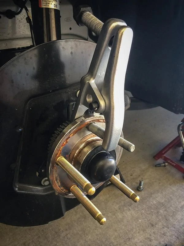

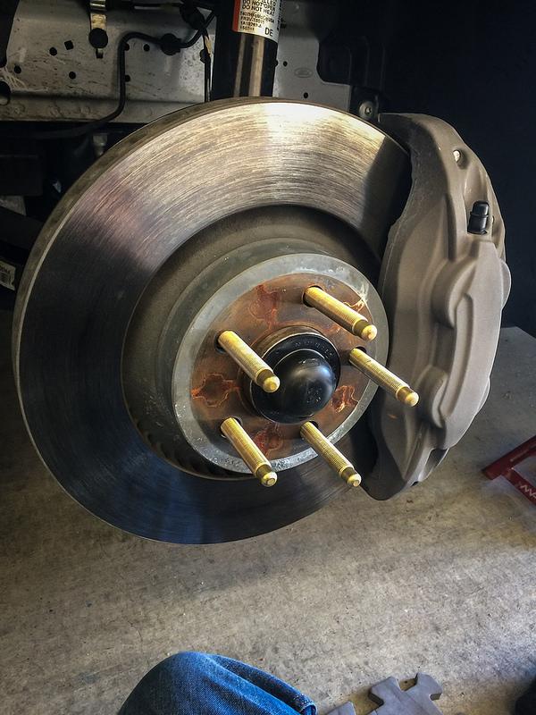

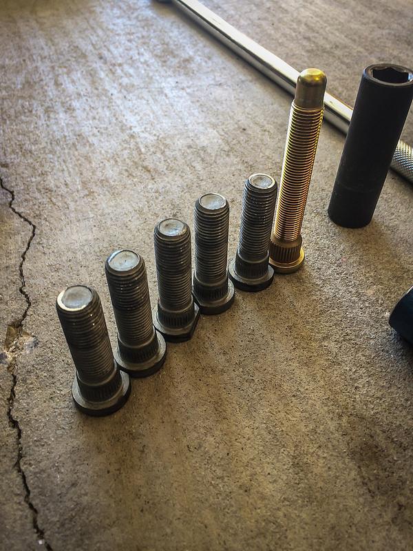

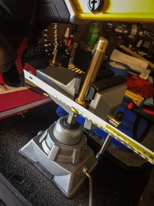

Got this done over the weekend. Having the right tools made this job easy. There were 3 studs that the ball joint tool kept slipping on that I had to "tap" out with the mini-sledge. Being that the car was so new, those 3 studs took little effort to tap out.

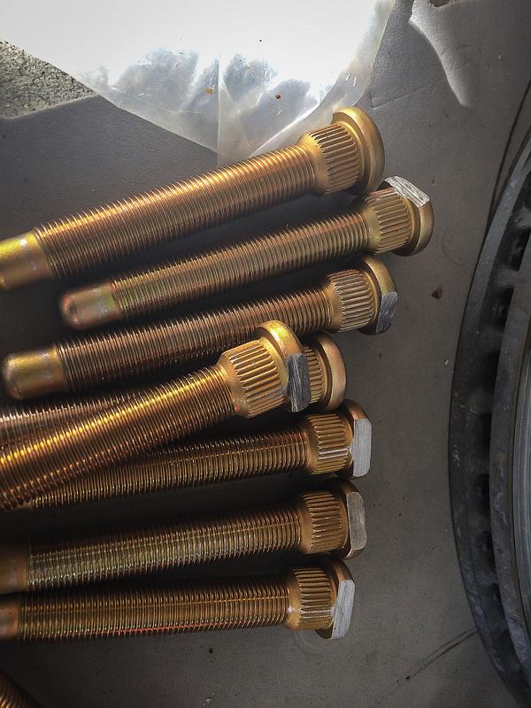

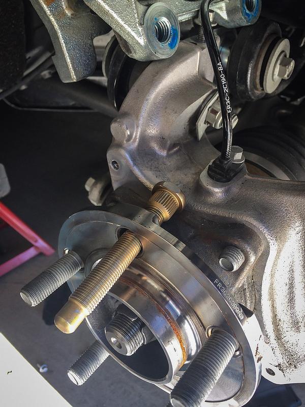

On the rears, you do have to trim the head so it does not interfere with this lip behind the hub..(I'm not sure what this part is called).
You do not have to remove the hub for the rear. This spot was the only place I could get both the factory stud out and ARP stud in. It's like a small cavern that they could easily slide in and out of.
