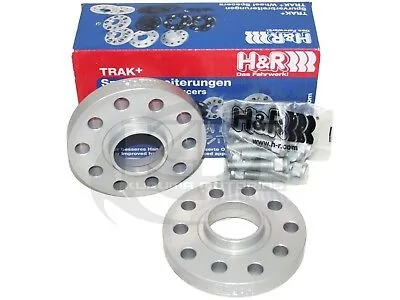

What sucks is I couldn't find any 15mm bolt on adapters. I can't remember if I found one with a 70.3 center bore, but I found NONE with M14 studs. So that would mean 10 new studs, AND 10 new shorty lugs, and more labor. Maybe someone should look into manufacturing some <hint, hint>
I installed these 15mm spacers on the rear, not really easy as you have to remove the hub to do it. There is no “poke” but makes quite a difference combined with the SVE 1” lowering springs.
I will be doing the front this week with the same spacers. I don’t think I will have to remove the hub for the front.
