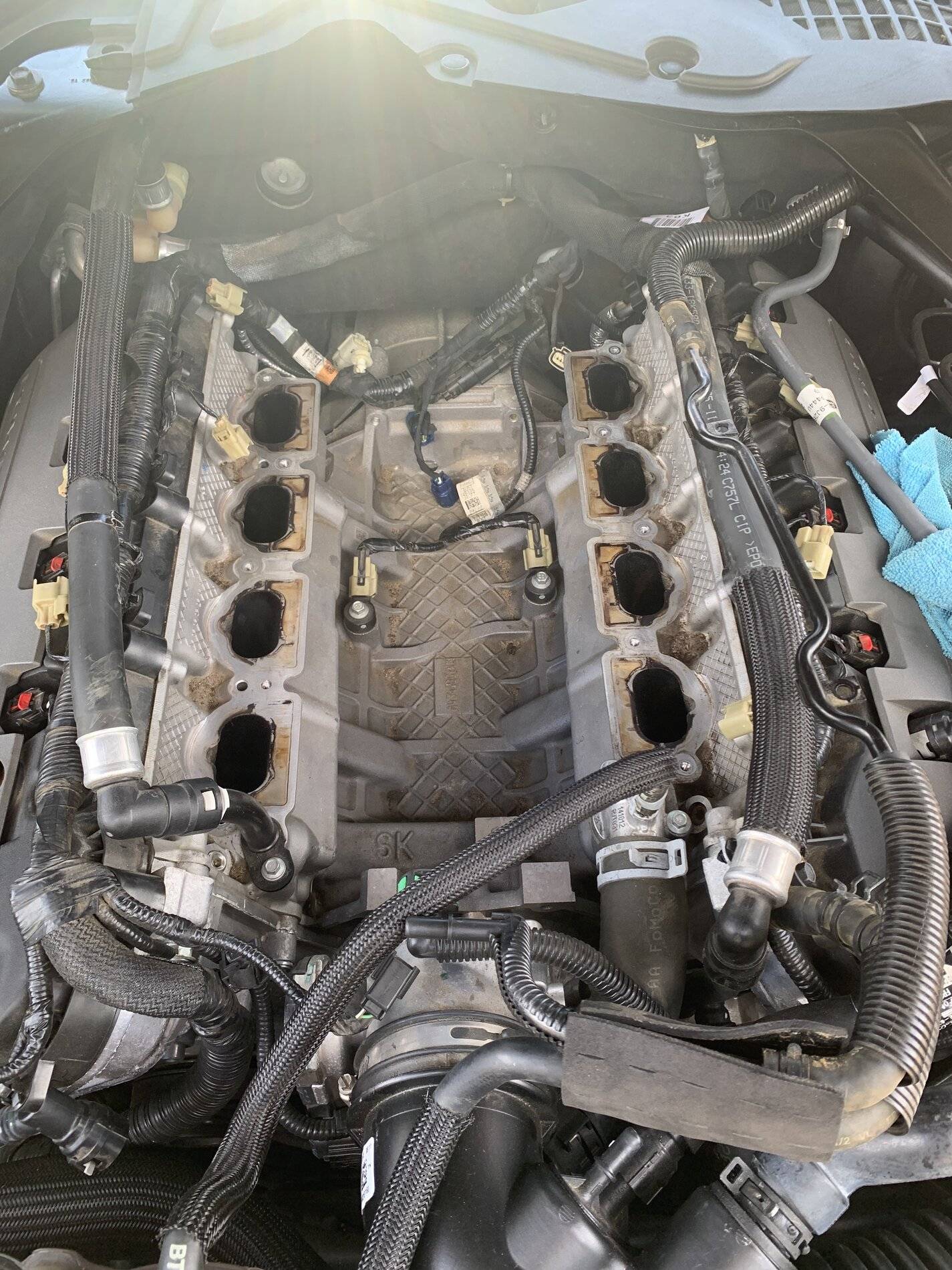

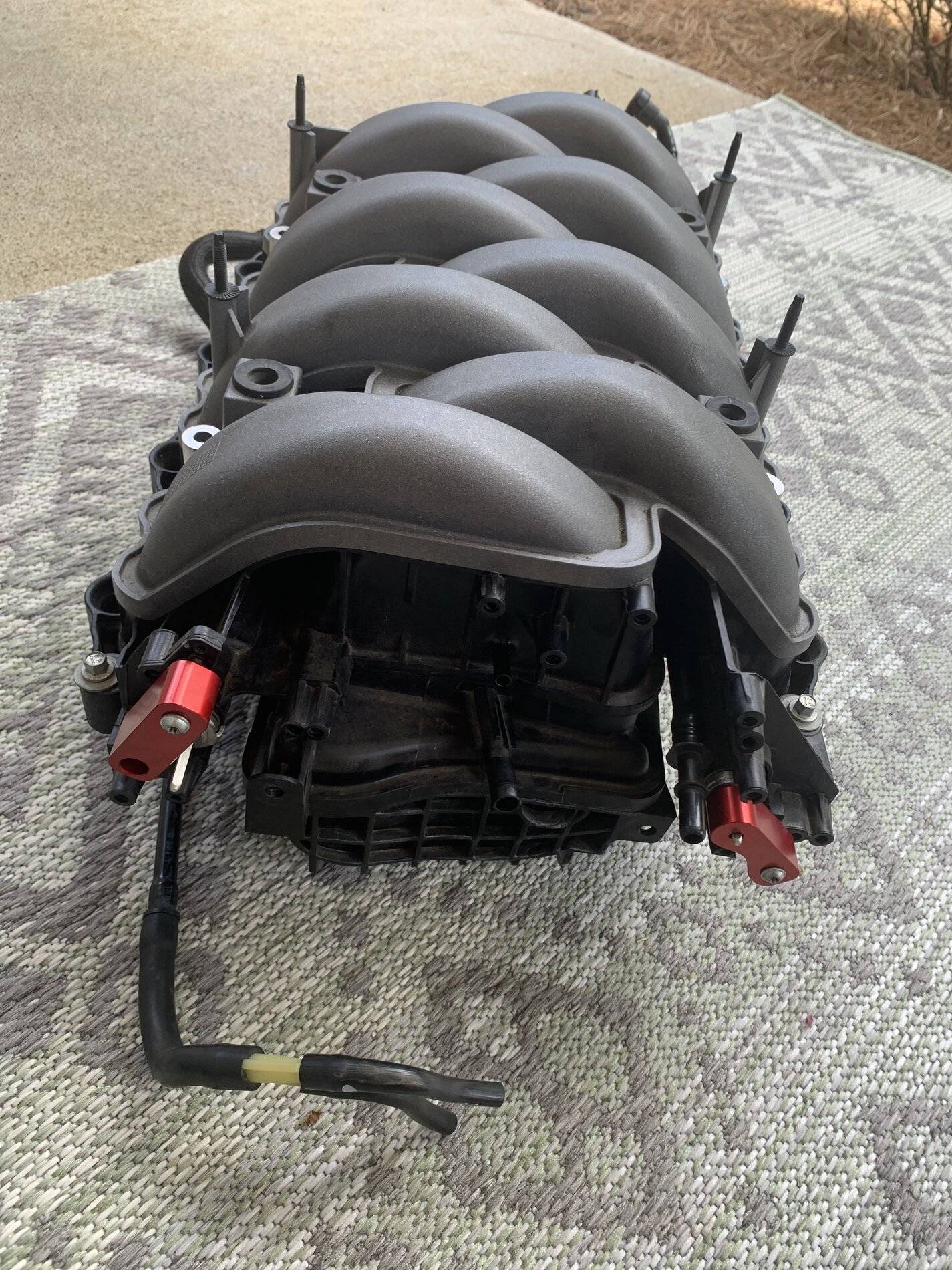

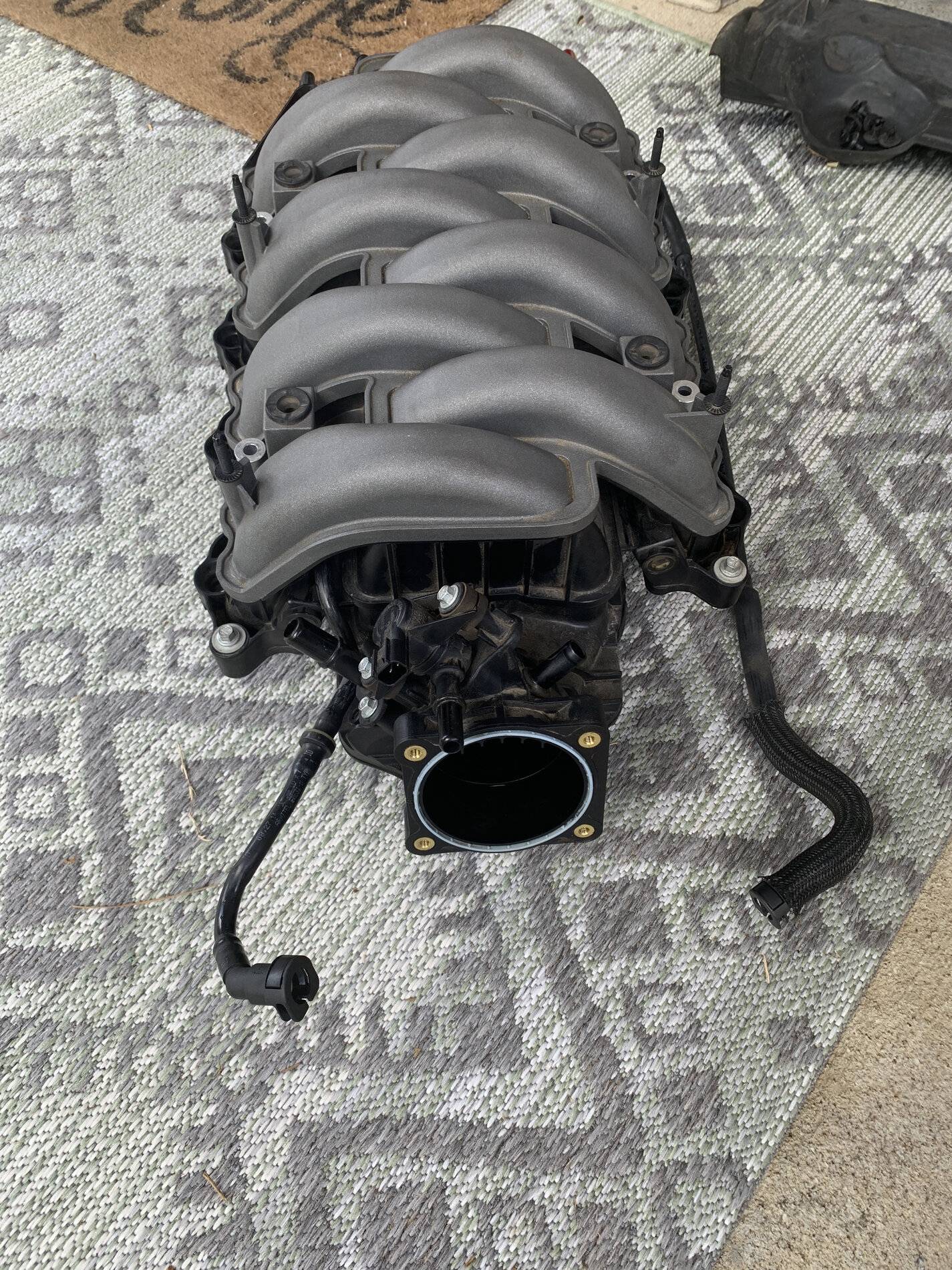

After putting headers on, I cracked a sensor when lifting up the engine. Right behind the manifold that has happened to some and I didn’t know to disconnect it before hand. Replaced the part but I’m still getting a check engine light because of it so a 60 dollar part vs the price of an 18 manifold right now is a lot better for me.
From what I read any actual loss in low end is negligible
SmileForTheRearView
SmileForTheRearView
Jul 24, 2020
73
Tennessee
2015 Mustang GT
Does anyone know what needs to be capped off? I’m sure that one on the back of manifold does
