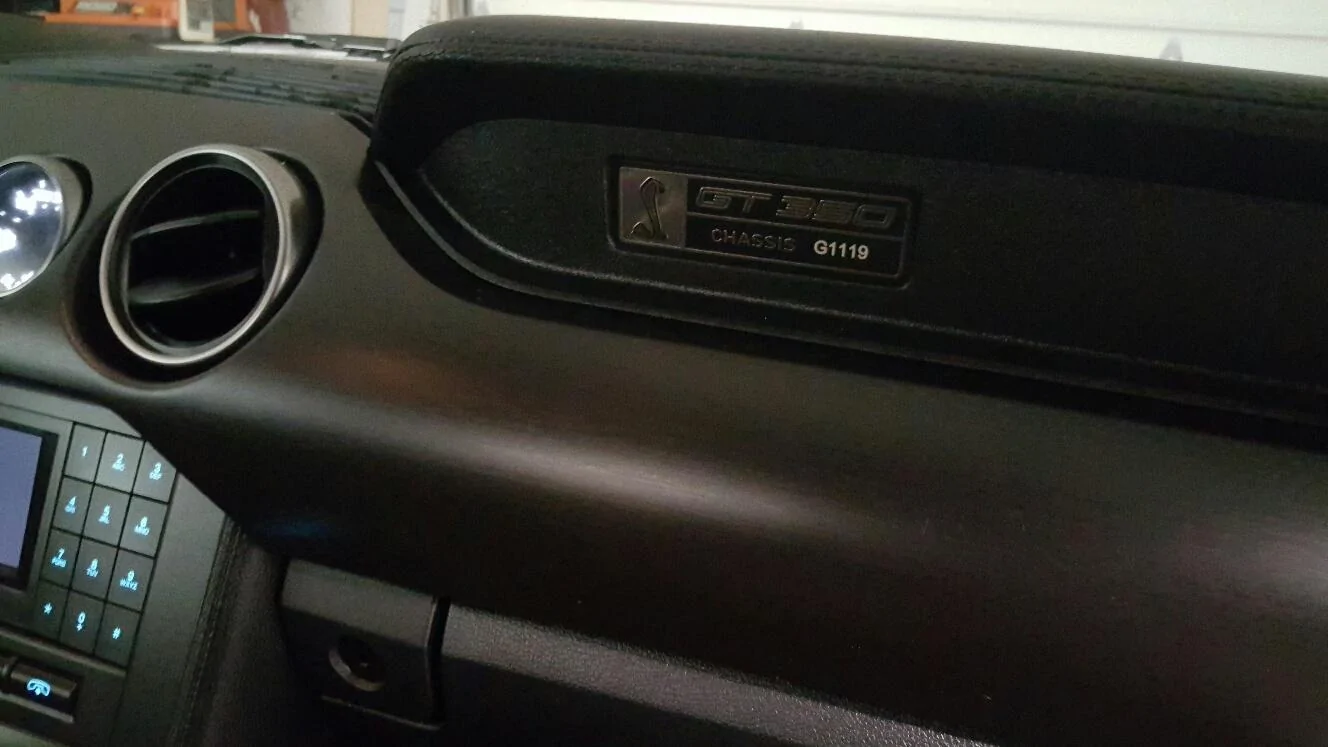

I am not exact on chassis # but I think it is around 1600 or so.
Interesting....Base versions don't have the chassis number mounted above the glovebox easily seen from the driver's seat? The chassis number of your GT350 hasn't been etched in your memory?

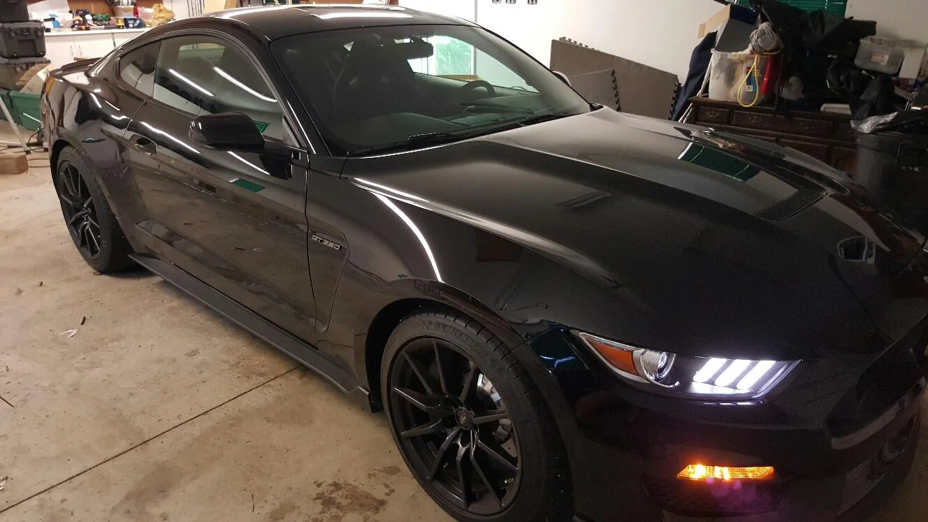

The base does have a chassis plate. My build number was 1119. Went out to take a pic and waiting for it to pop up in email so I can upload. Don't know if you are being sarcastic or questioning the validity of my ownership?
