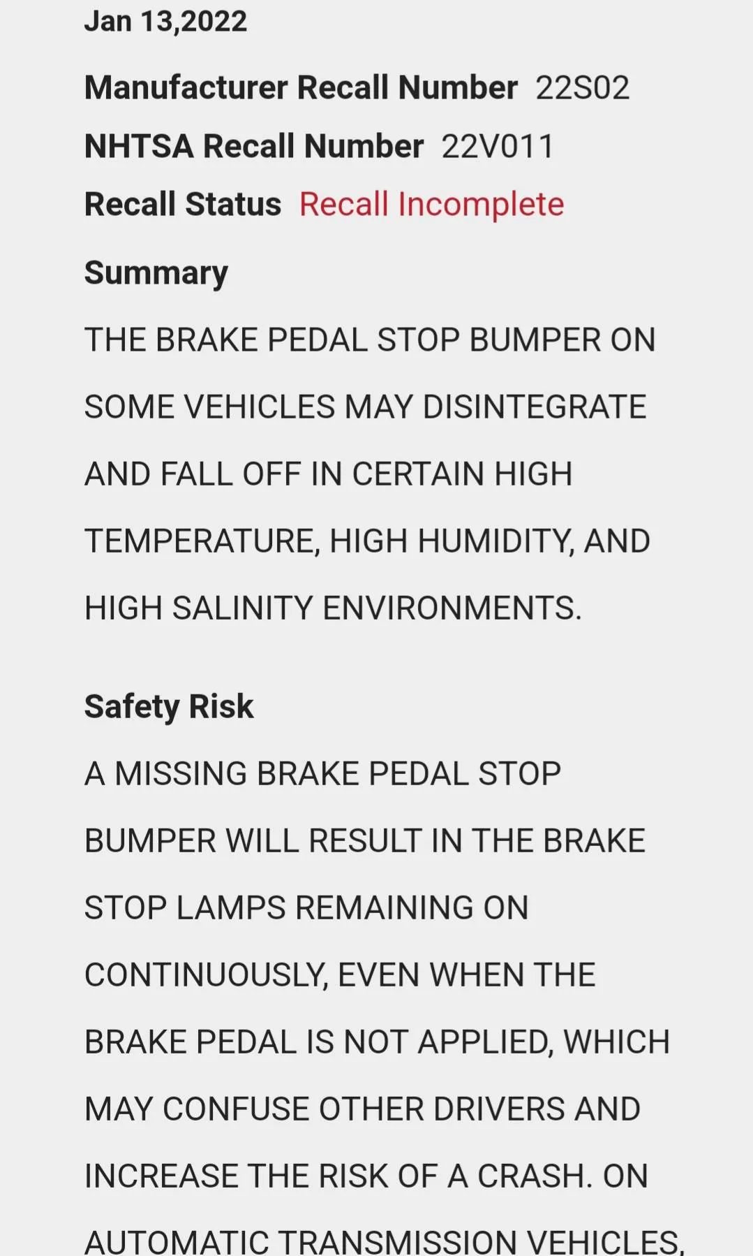

Check to make sure the brake pedal bumper and the clutch pedal bumpers (if manual trans) are not missing. Those will cause intermittent drivability problems.
See this below thread which contains many images, DIY and the recently released official NHTSA docs near end of thread. Even though Ford states in the docs it affects 2015's clutch pedal bumper AND brake pedal bumper, , there's many threads on here where members have posted other model years where the problem exists.
https://www.mustang6g.com/forums/threads/brake-light-switch-near-pedal-failure.122100/

This just happened to me while at Daytona, 2 years of battery drain, brake lights randomly would stay on. Yesterday when I got here the brake lights would not go out. Then driving, it was in power reduction, trip to Autozone and a zip tie installed in the hole the bumper goes solved everything. Found out about it from this forum, checked my vin on NHTS and found the recall. Also I now know what those little pieces on my floor are.
