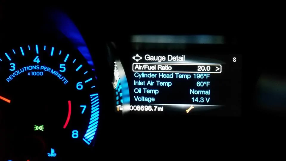

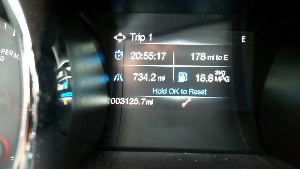

I have a 2015 GT and sometimes when it rains really hard I get a wrench light that comes on. I have checked it for codes and find nothing. I thought it might be the C.A.I. I had put on. So I went back to the stock air intake this winter for now to test it. But we have not had heavy rain. So I am still waiting to see if it makes a difference. I do think it is the vents in the hood that let water drip on to things. I noticed on the passenger side there are electronics that get wet. I plan on changing the hood since mine has the Corrosion issue and Ford will not fix it. I am going to get a hood that has no vents in it. I am currently looking at the Cervinis cowl hood.

I have had at least 2 documented times of this happening. I now have 35k on the car and maybe it has happened a couple of more times since then.
