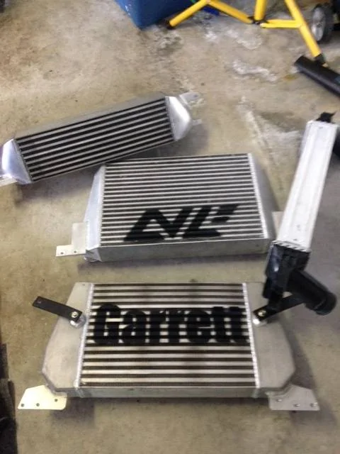

What is a good IC for a daily driver that is never tracked but driven spiritedly on a whim? I removed the grill shutters if that helps when it comes to sizing
Don
The picture below is all the units I've had on my car with the stock one thrown in for comparison. MAPerformance street on top, Levels, and then the FFTEC w the Garrett core on the bottom. The street units (the single tier stock-style as opposed to the double tall units) are more than enough for daily driving. I summed up my experience here: https://www.mustang6g.com/forums/threads/the-big-intercooler-thread.15352/page-41#post-1513780 which is a good thread to read if you want. I call the small MAP unit the little intercooler that could. They all performed just about the same. The smaller units will heat soak quicker but will not get as hot as the bigger units. The big units will dissipate heat a lot quicker when getting into boost but I noticed their peak temps in traffic would climb higher than the smaller units, they're also heavier too, which is something to consider. Whatever you get I'd suggest looking in the classified section first as intercoolers are damn near a lifetime part and super cheap used.
