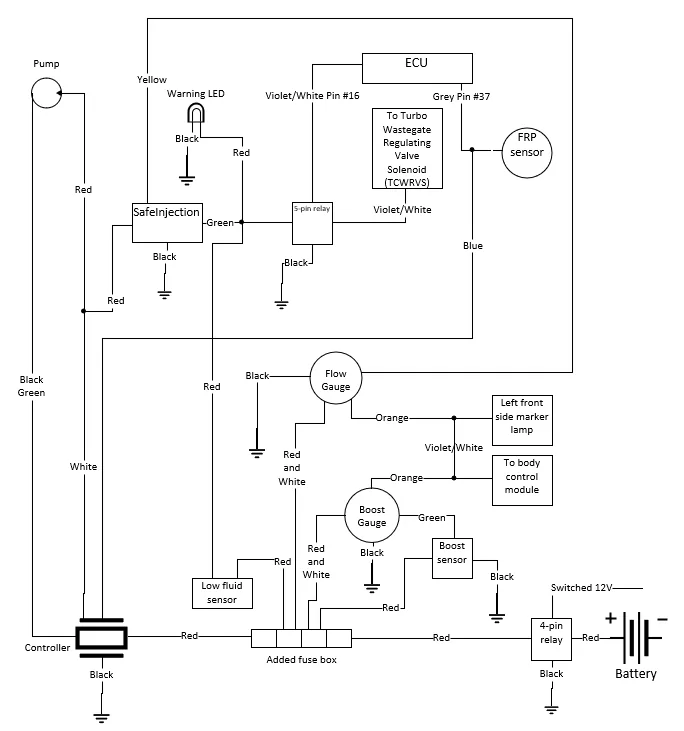

No need for a low level failsafe IMO. The sensor should be installed above the feed. The Snow gauge flashes when fluid gets low. For me that leaves me with a few Pints. The gauge will flash with stars if there is a leak or clog.
The low fuild sensor is installed above the feed, not sure where else you'd put it. As mentioned before, Snow Stage 3 doesn't have any built-in failsafe so it won't do anything if there's any kind of disruption. While only failsafe I have now is the low fuild level sensor and a warning LED light, I wired my setup the way I did so I can add the flow sensor that'll also automatically trigger the failsafe as soon as there's a disruption (e.g. no fluid, failed pump, hose burse, clog, etc), which will be much faster than a person noticing the warning light and lifting off of the throttle. As simple as the AEM controller was, one advantage it had was that it had a wire to trigger the failsafe. So it sounds like Stage 2.5 comes with a flow sensor and built-in failsafe that 2 and 3 lack?
I don't think that's true. The SafeInjection unit was discontinued some time ago, and there is still no reference to it or any other kind of failsafe device on Snow's website, on the St2.5 page or elsewhere.

True. There is no fail safe built into the 2.5 kit. The gauge will alert if the tank gets low, there is a clog or a leak. I am not sure how the system knows about the later two.
I looked into the AEM fail safe (flow gauge) and saw nothing but bad reviews.
