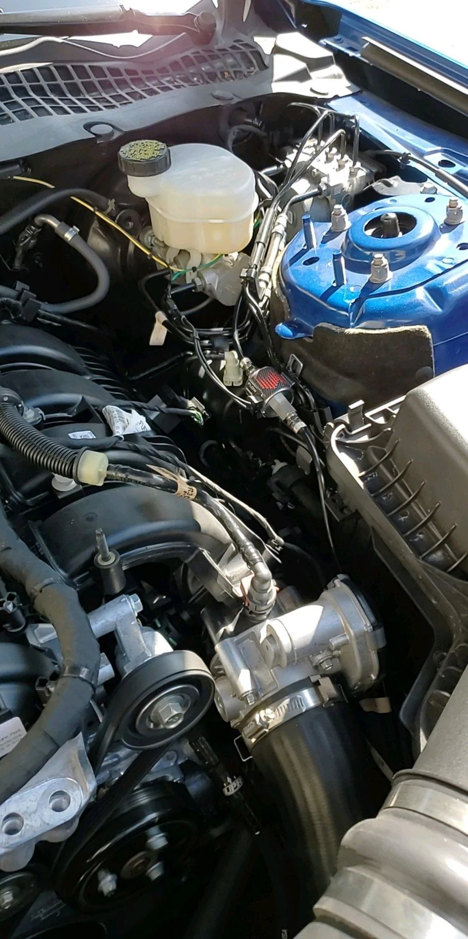

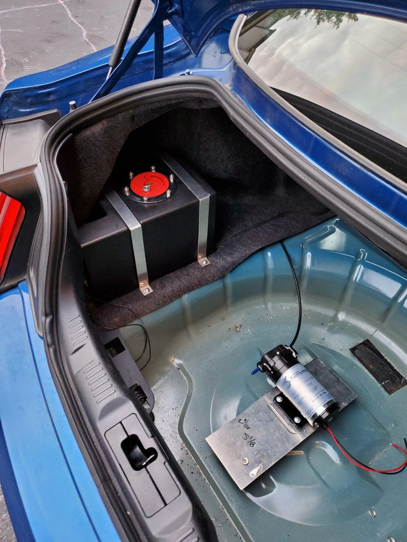

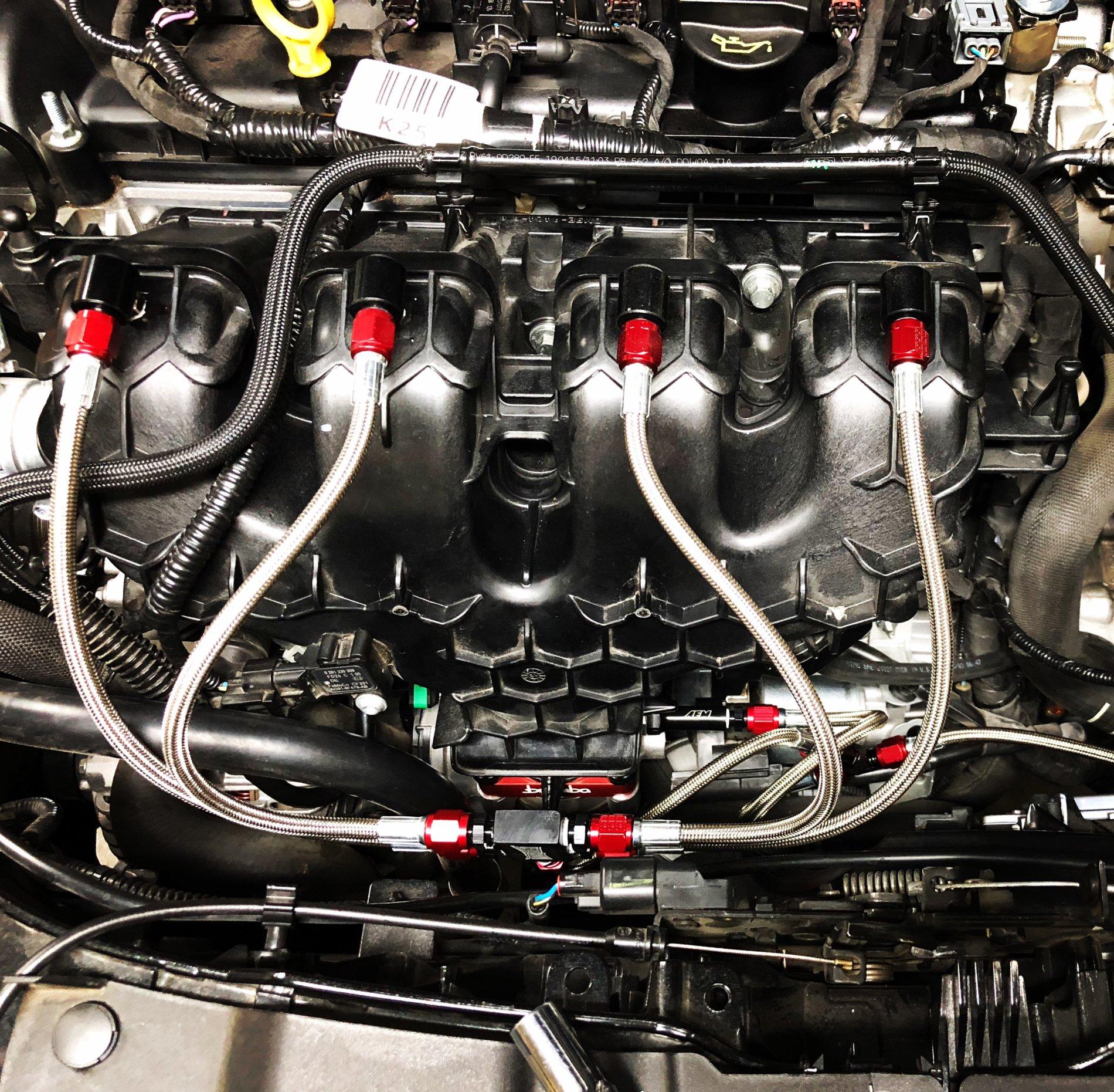

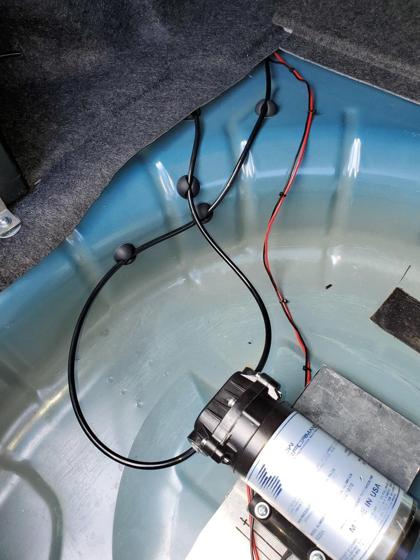

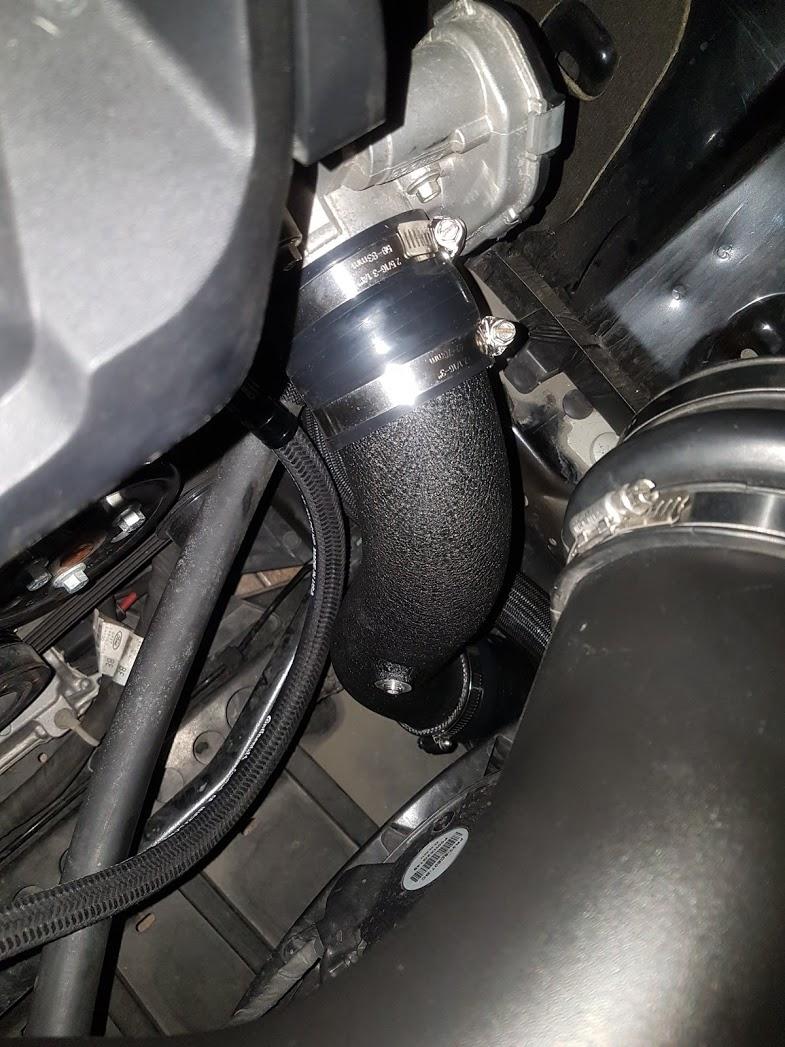

I have just recently installed the Snow perfomance stage 2.5 kit.
Optional parts I choose for install was a relay kit and solenoid and Cp-e charge pipe with meth bungs.
I used an ATP map adapter.

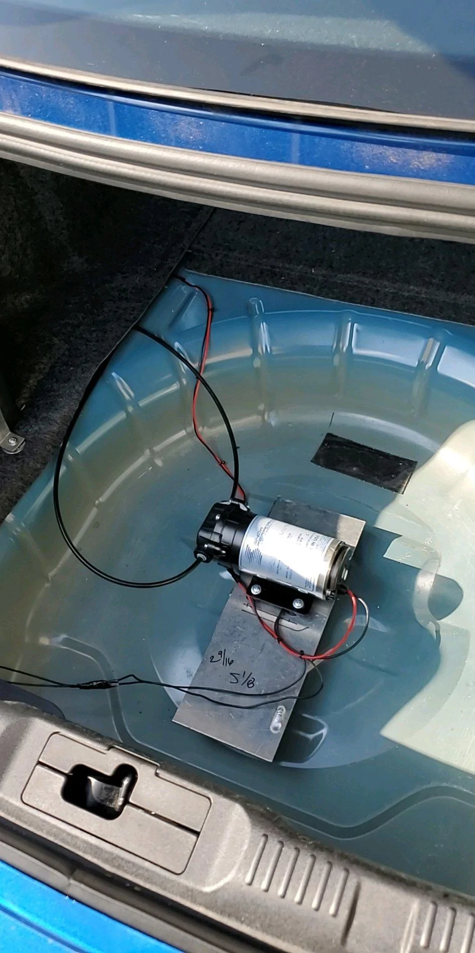

The install was a breeze and I refused to splice into any factory wiring. Everything is standalone. Note... that, pump bracket is temporary lol
Unfortunately, I did have to drill 4 small holes to.mount my tank.
Right now I am just using distilled water with a #3 nozzle injecting at 9/24 psi. Estimated tq on the accessport showed 409 tq from 385 without . Not concrete by any means. Also water did not effect the AFR. I did some pulls and noticed timing stayed higher in the top end. I can post the log screenshots later. If anything, the added timing was probably from cooler charge temps.
Ryan recommends full Methanol and I am waiting for a #6 nozzle and the green light to start injecting. The local speed shop sells M1 for 8.00 per gallon.
Also... I did use pushlock tubing, which I will be replacing with braided hose eventually. We will see how the push lock holds up.

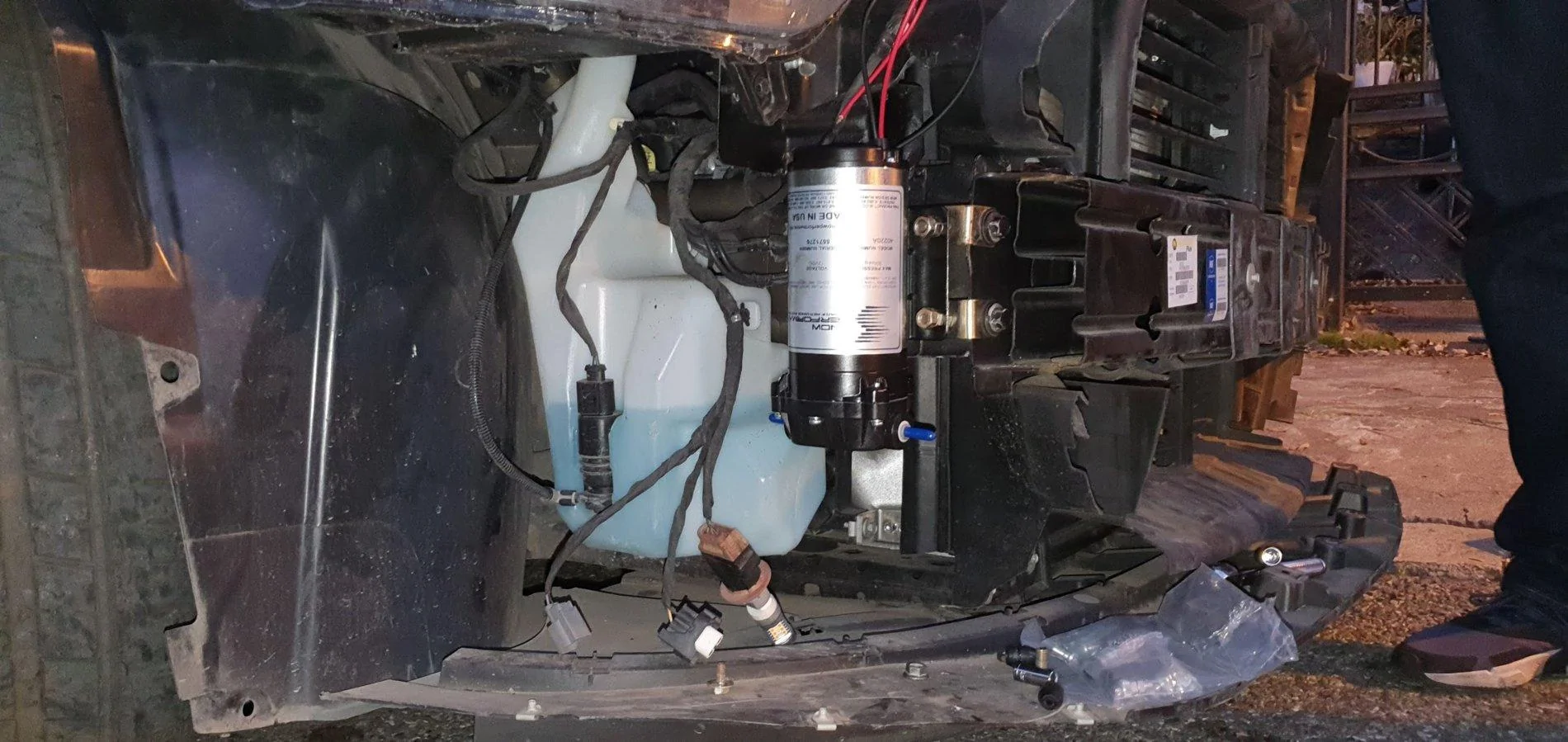

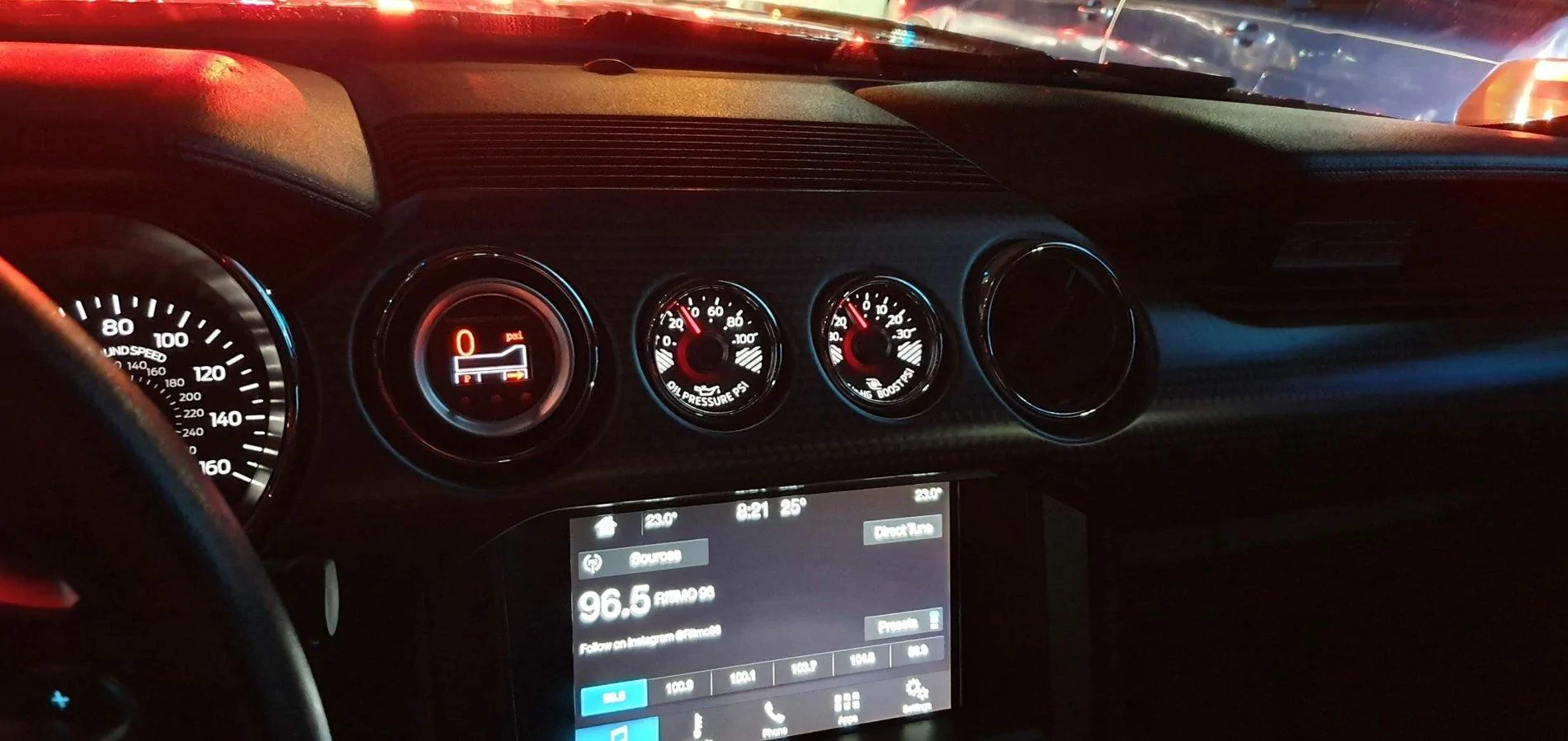

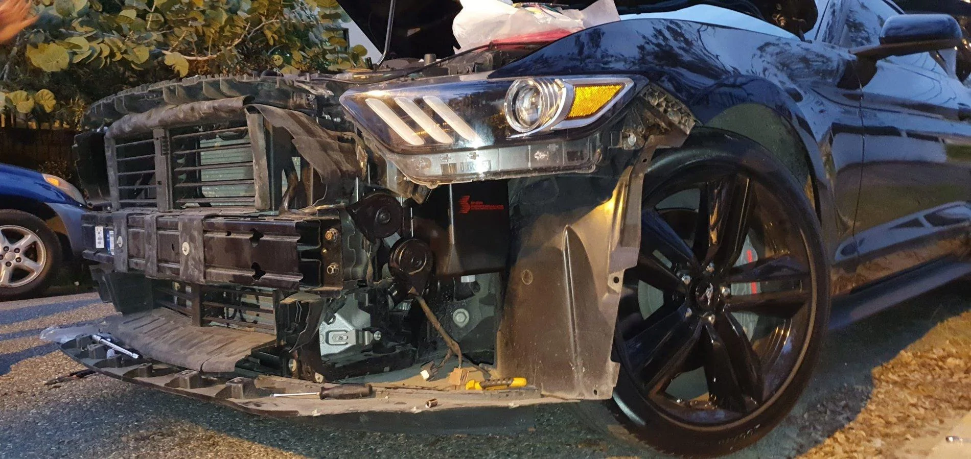

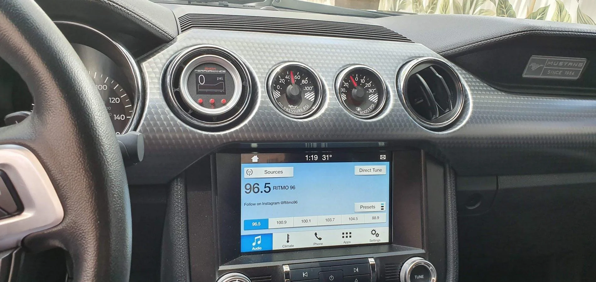

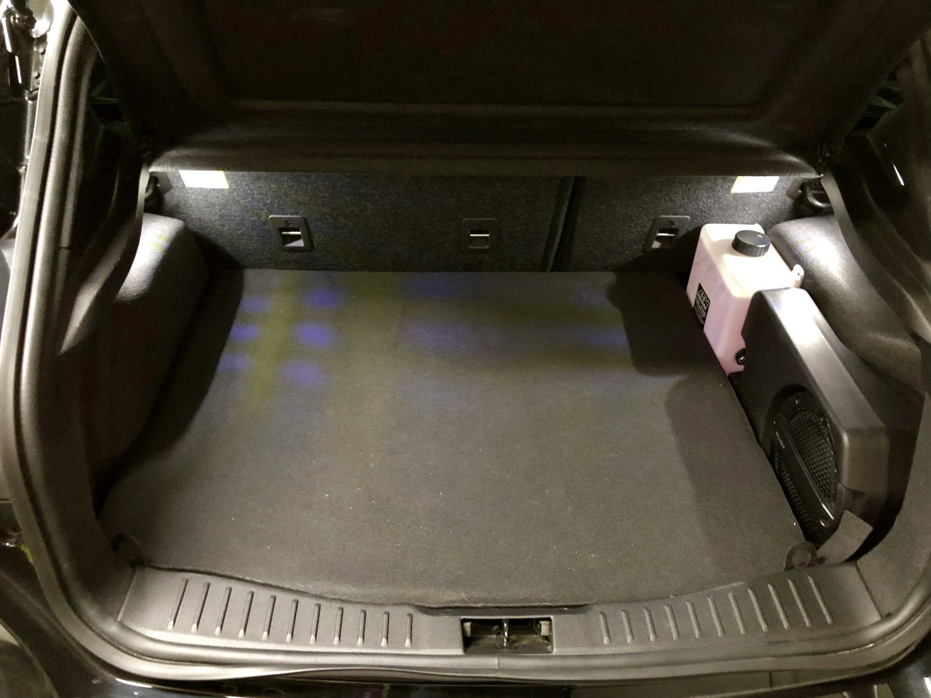

I also went with Snow Performance 2.5 kit
My tuner (Adam from Tune+) recommends 70/30 mixture:
"70M/30W is what these cars like the most, and gives you the best gains from both octane increase and charge temp decrease. The pump can handle it without a problem, 70/30 is not flammable and that is why we run it with water. Some customers run 100% meth, which in my opinion is not safe for the person itself because of it being flammable and methanol flames are clear and cannot be seen. "
this is my setup

Very nice looking install. I wanted everything accessible and easily serviceable.
I will probably move everything up front eventually, but for now the system is working.
As for water to meth ratio??? I don't know...
I feel like the 100% methonal is being used as additional fuel. Seems to me like methonal is best injected as close to the valves as possible. I like the water idea, because I don't feel comfortable with using the water/meth as a crutch. If somet6was to fail, than definitely BOOM
70/30 sounds good to me

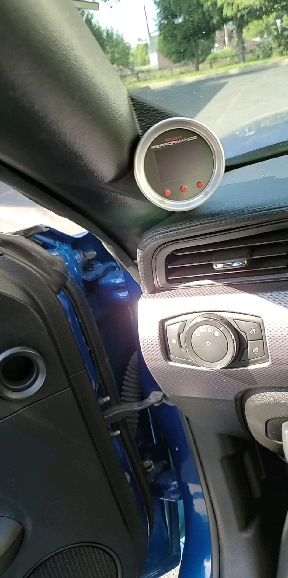

this is my setup
How did you mount the gauge in the air vent?

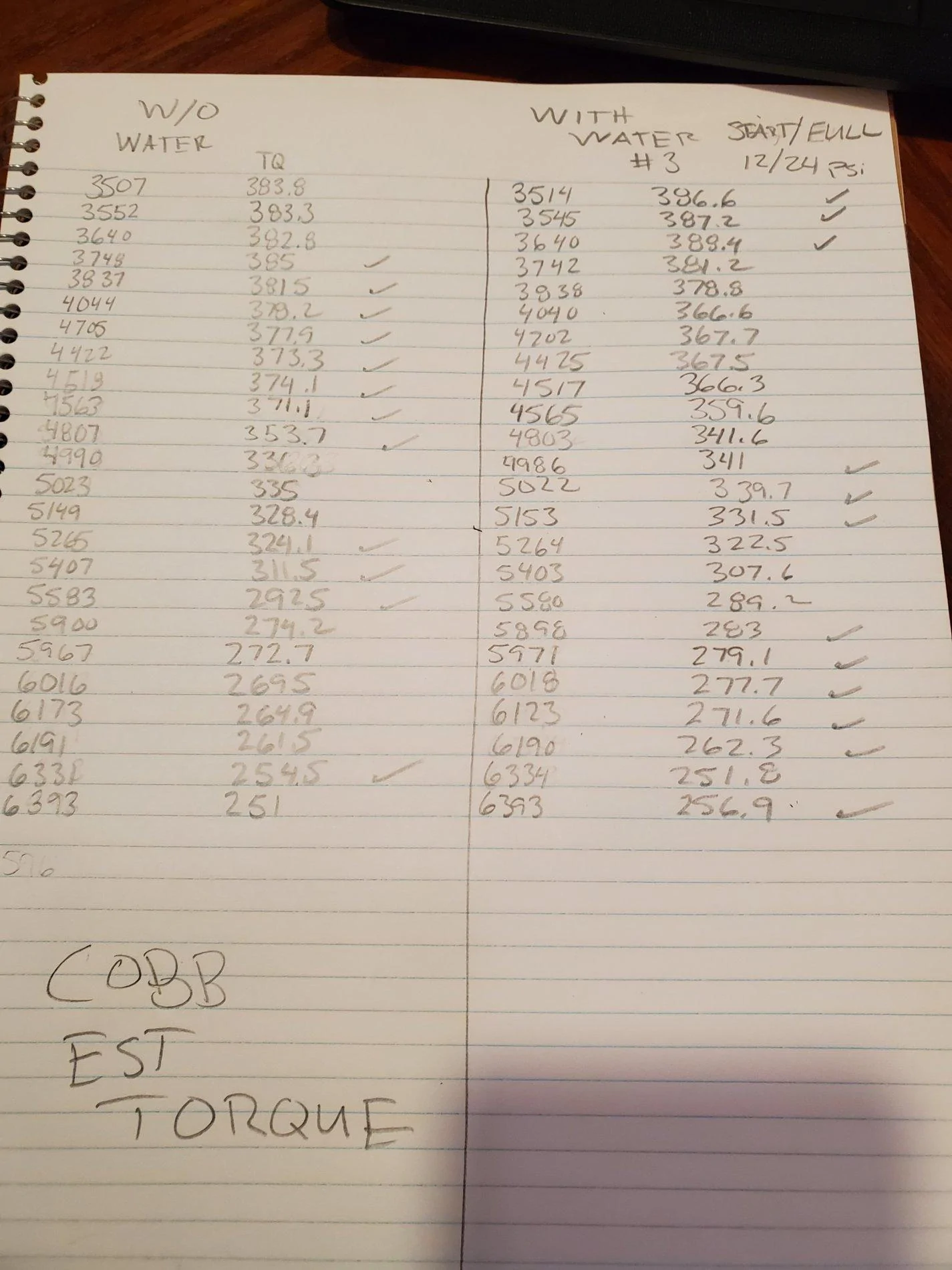

No need for a low level failsafe IMO. The sensor should be installed above the feed. The Snow gauge flashes when fluid gets low. For me that leaves me with a few Pints. The gauge will flash with stars if there is a leak or clog.
My engine is actually idling better and feels smoother. Tail pipes are black. I think I have been blowing carbon and soot out from the intake ports. If anything.... water works pretty good for detonation suppression and possible intake port cleaning with a small nozzle. My afr is unchanged.
Playing with the Cobb estimated torque log. Take it for what it is, but this is what I got.
Peak was 413 tq without spraying and 401 while spraying at the lower end of the rpms.
I didn't include them because my rpm and speed wasn't constant till after 3200 rpm.
These numbers are just for fun till my tuner gets back to me. Seems to me though that I should drop down to a number 2 nozzle and retest with the same settings. From 3800-4800 I believe, the engine is getting too much quench. Same effect as using too much octane .
