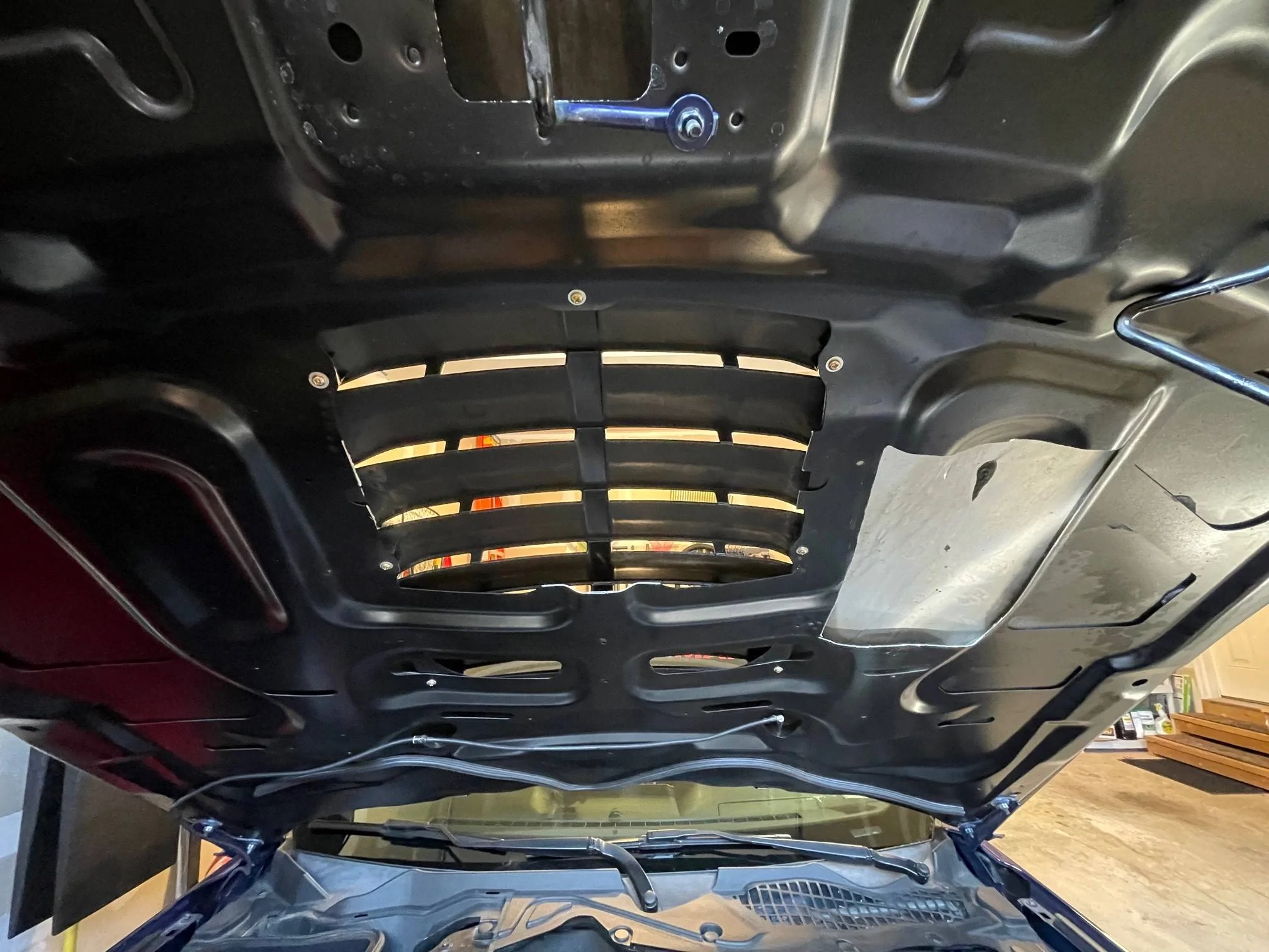

I used to have a fully louvered OEM hood with aftermarket pins and, while it worked, it would wave like an ocean down the straights. I hated it. So I bought an aluminum MP Concepts hood and had to cut a little away to fit over the airbox properly (see photo) and I cut one of the support ribs closer forward to the radiator to allow better air flow. Stopped using the hood pins. It doesn't wave at all and moves air very well. Also comes with a rain tray I never use
First, let me say that’s a clean and very pretty car you have there. Secondly, it’s interesting that your louvered OE Hood was susceptible to flutter. My experience was the opposite. Once the Race Louvers went in the high speed fluttering was a thing of the past.

Who knows but I know something had to change. It wasn't the cleanest install by the original owner (that's how I purchased the car used). The placement was a bit different than yours (side vents more forward) and I think the hood pins all conspired.
