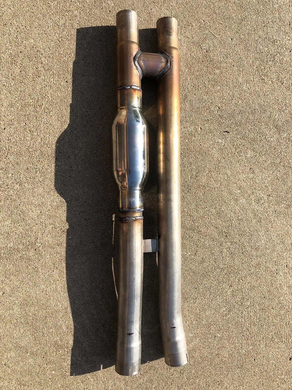

My mach 1 has stock manifolds with catless 3" exhaust pipes and a 3" double H-Pipe running into the stock active mufflers. I installed a pair of Vibrant bullet resonators into the double-H (2-M fabrications) to prevent any rasp and it's definitely louder than stock but deep and mellow until after 4000 RPM when it "sings" much louder. I don't know if it will meet noise restrictions at my local track, Waterford Hills, but I'll find out soon enough. This is the only sound clip I have of my sone learning to drive a stick. (His Mustang GT has catless headers with 3" single X-pipe and 3" straight pipes to the tips and it's ear splitting obnoxious.)

I actually made my own with a single resonator a couple years ago and ended up taking it off and going with a straight H pipe. Maybe if you have headers, it would be a good idea, but I don’t think it’s loud enough with the stock cats.
