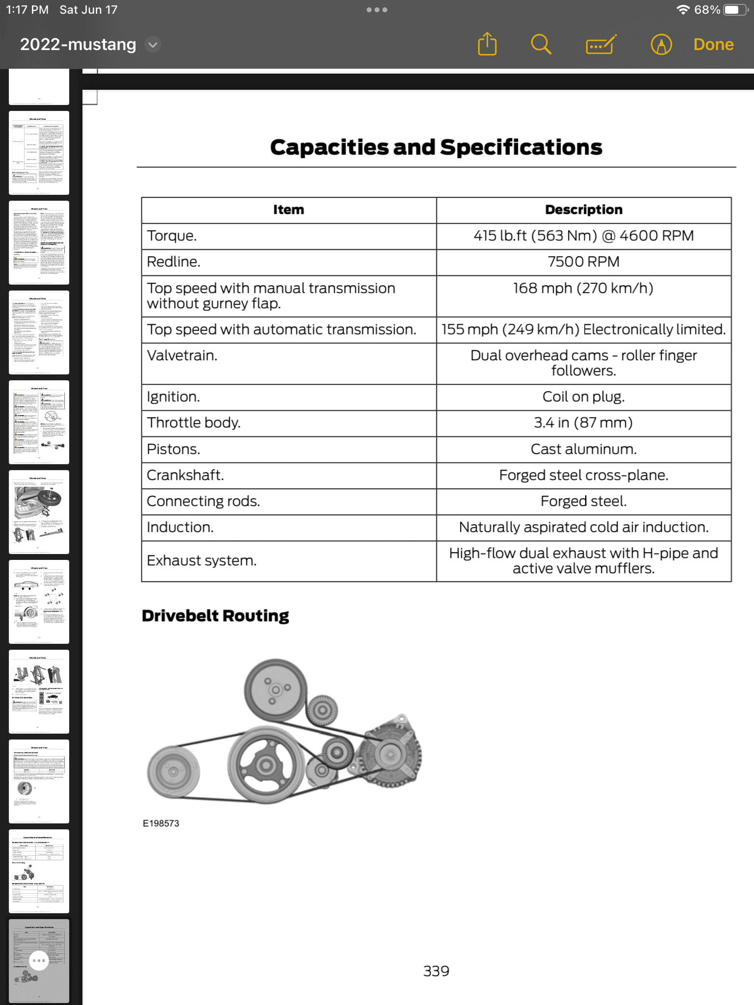

Ran into this on the Ford Manual. Apparently already has a high flow H pipe. Trying to weigh my next upgrade. Max speed for the automatics is electronically limited? Can a tune fix this?

Correct. Inside the resonator is a H-pipe config. The GT350’s have an X-pipe config in there.
Not sure why Ford encased them inside those resonators, but I’m sure it has something to do with additional sound muffling to dial it in to 50-state legal specs.

The auto is electronically limited to 155-first I recall seeing that? I thought the auto could go 167.

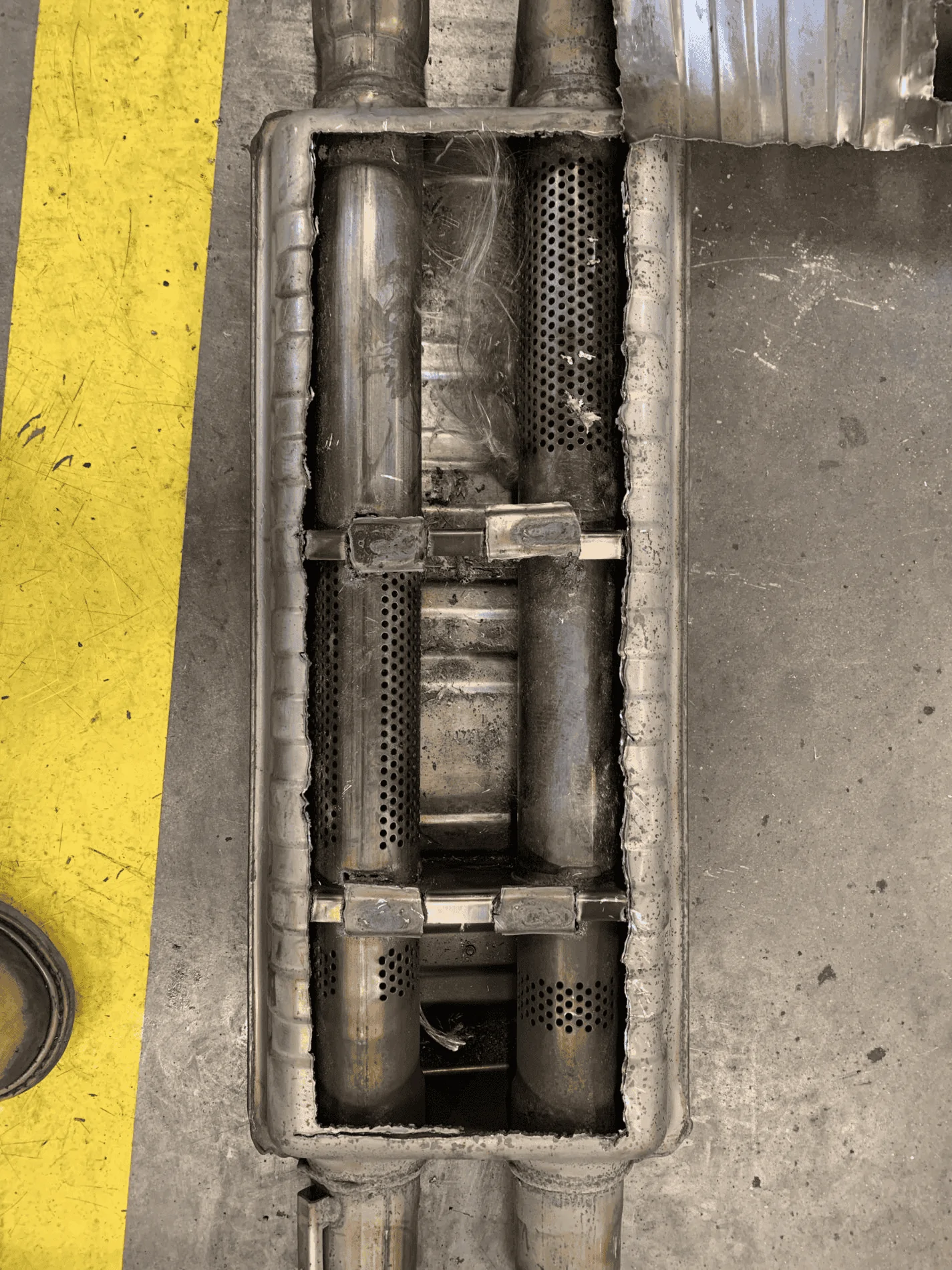

The stock resonator is not an H-pipe, it is two straight through pipes.
This off your Mach-1?? The Mach-1 and GT resonators look exactly the same. (I have both) Then I’m thinking we call Ford out on this—so lame. Would be interesting to see a GT350 config from the factory
For the ā€œX-pipeā€; See if they are ā€œmisleadingā€ there as well.
That is a pic I found a couple years ago when I was looking into replacing the resonator on my 2018 GT, it is not from my Mach. But from the outside, they look identical. I did cut out the resonator from my Mach and looking into the ends, there does not appear to be a crossover to make it an H-pipe. Wouldn't make sense from a production/cost standpoint either.

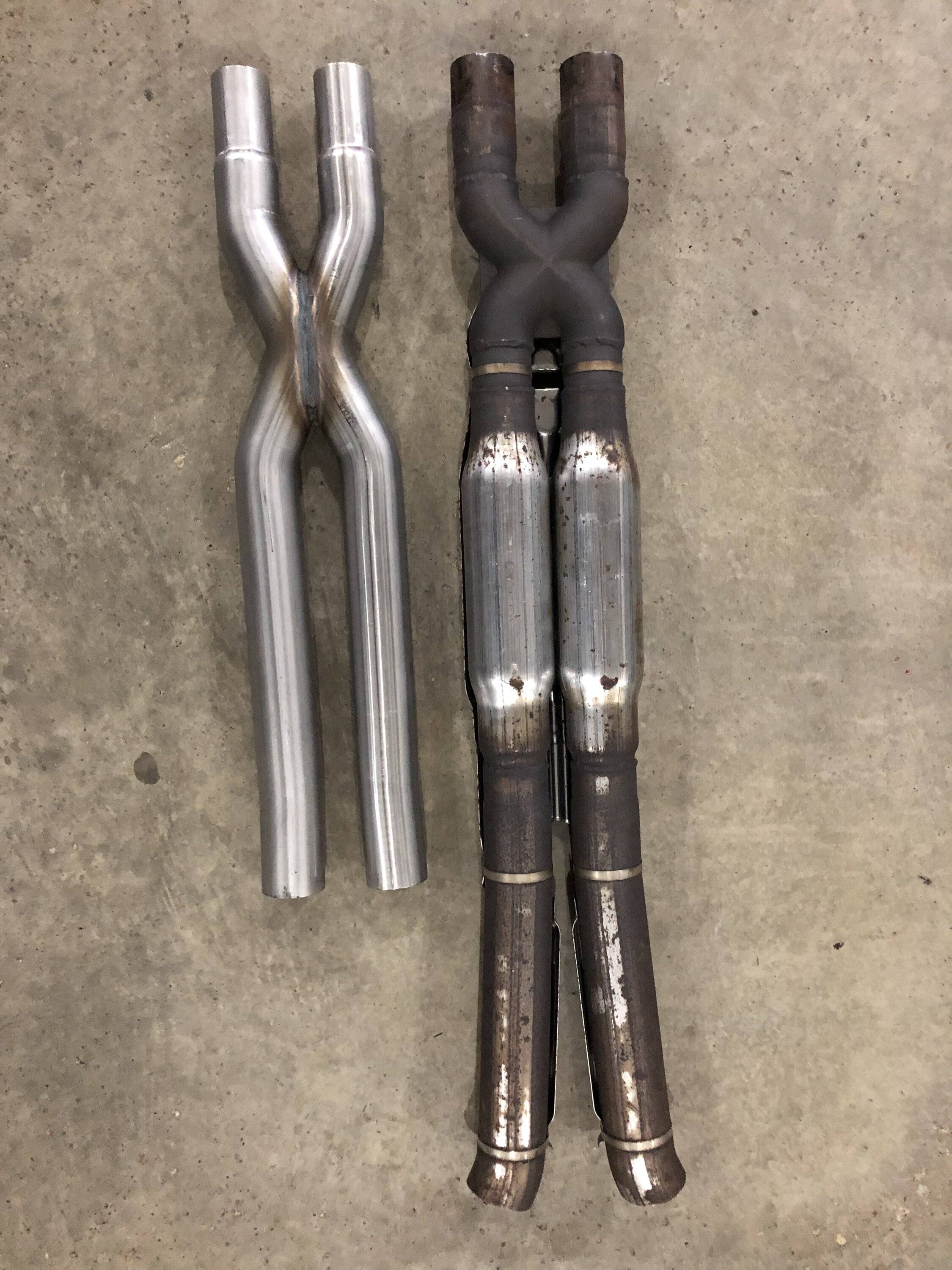

The GT350 X-pipe is a legit X-pipe, here a pic of one next to a Ford Performance X-pipe:
