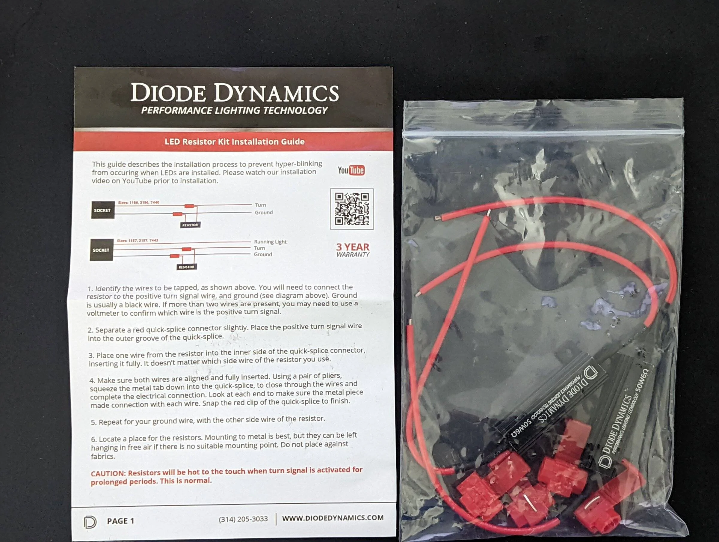

I bought the resistors along with the turn signals so I don't have to go in and change anything. They're pretty cheap. Good to know there are other options.

Do you know if the resistors plug in? The last time I had to use them was on a Chevy truck maybe 15 years ago. I had to cut the factory harness and splice them in. I really didn’t like doing that lol. Much prefer plug and play!

Yeah, not plug and play but still easy.

The only thing that flashes wrong is inside on the dashboard. It sounds like a horse galloping. The turn signals themselves function normally. Resistors or disabling the bulb out code in Forscan will fix the dashboard blink rate.

I wouldnt want to use that type of splice connector in my vehicle though...they seem to sever/damage the wiring inside of the insulation.

I believe you just splice into the turn signal wires off the aftermarket ones so even if you want to go back to stock, you aren't ruining anything. I've used these in the past with these quick splice options and they work fine. The connection is enclosed tightly and you don't have to worry about debris or water or anything shorting it. The good thing is there are multiple options you can do to make this work.

I agree these are easy and quick, but they are not water proof / resistant. Unfortunately, I have seen these cut the wire almost in half when using.
Found this out the hard way when we moved from the States to England for three years. A local shop used these to splice into the existing headlight wiring to conform to the British lighting rules, and when I looked at the connections 3 years later to return it to a stock configuration, found the wires were partially severed.
I prefer to cut/crimp or use OE style connections, but that probably me being overkill.

Nah, that's pretty fair. Mine is a garage/fair weather queen so it won't see any sort of nasty weather.
