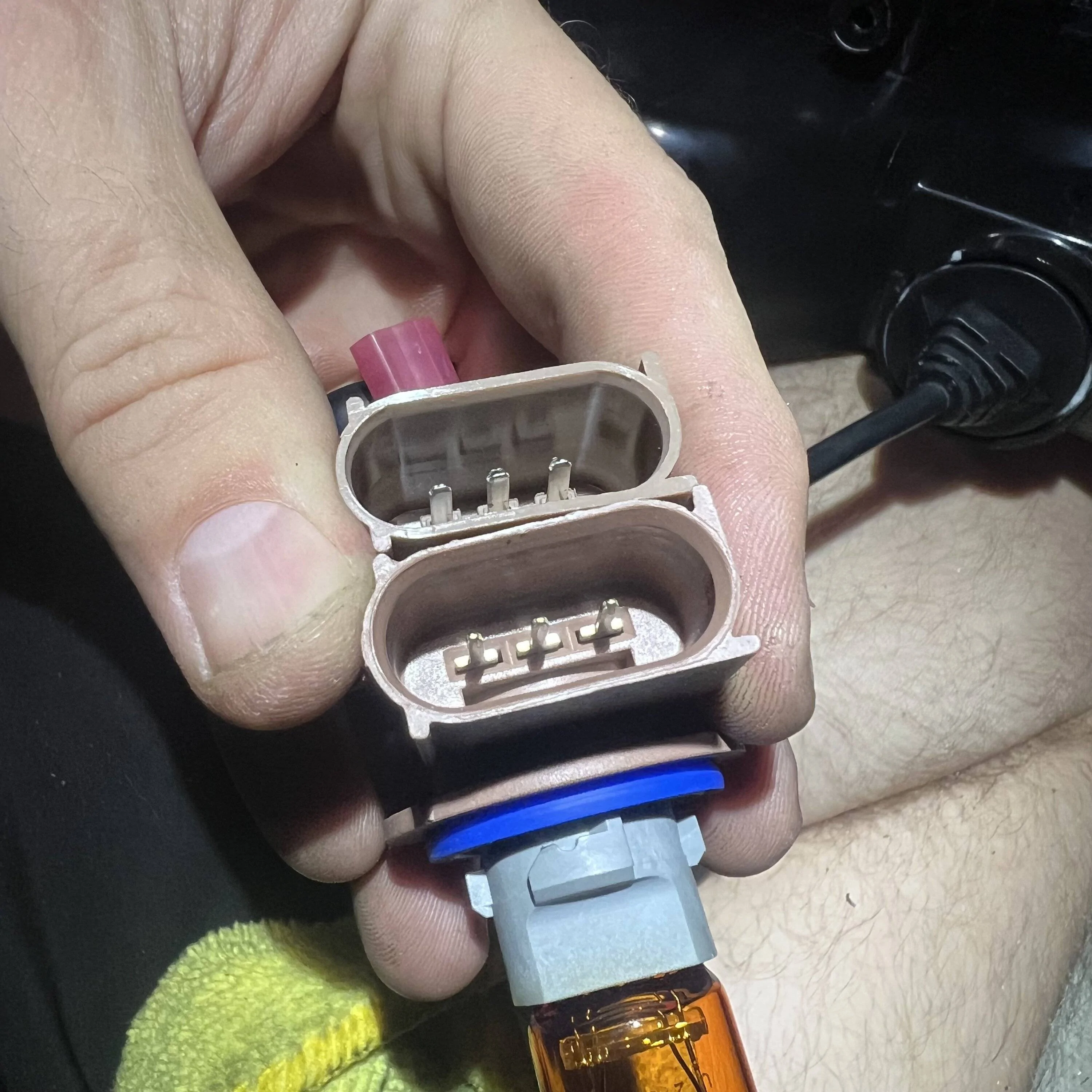

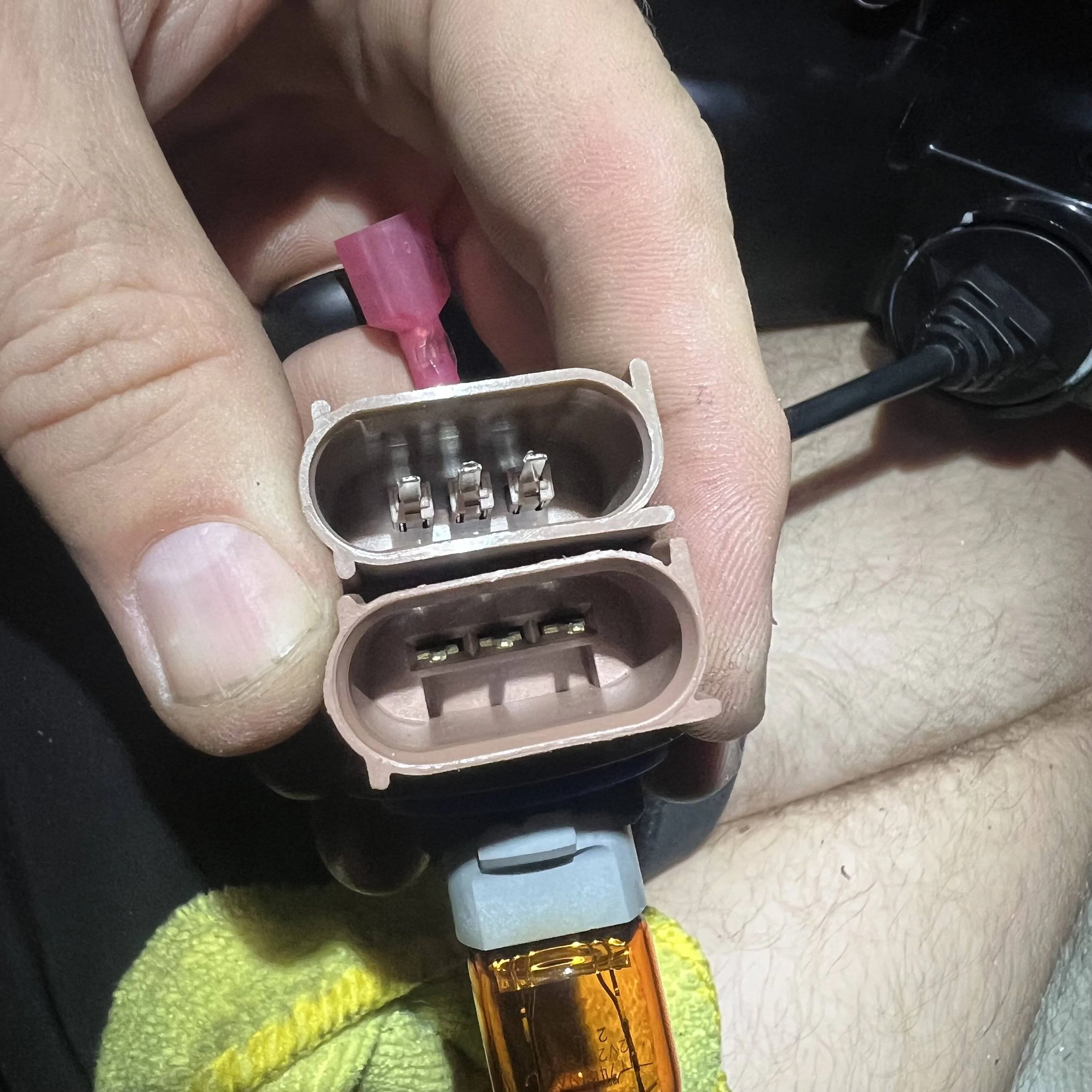

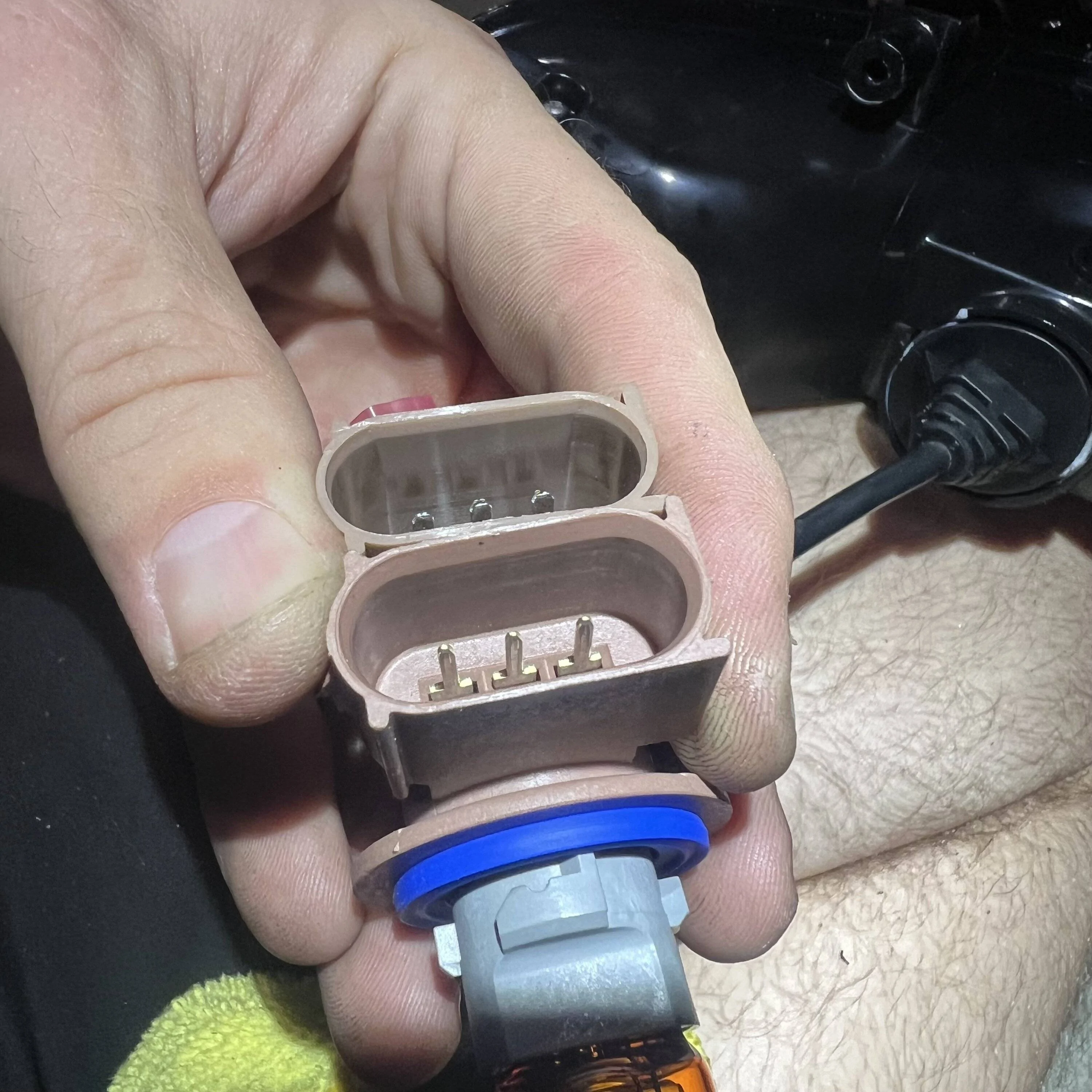

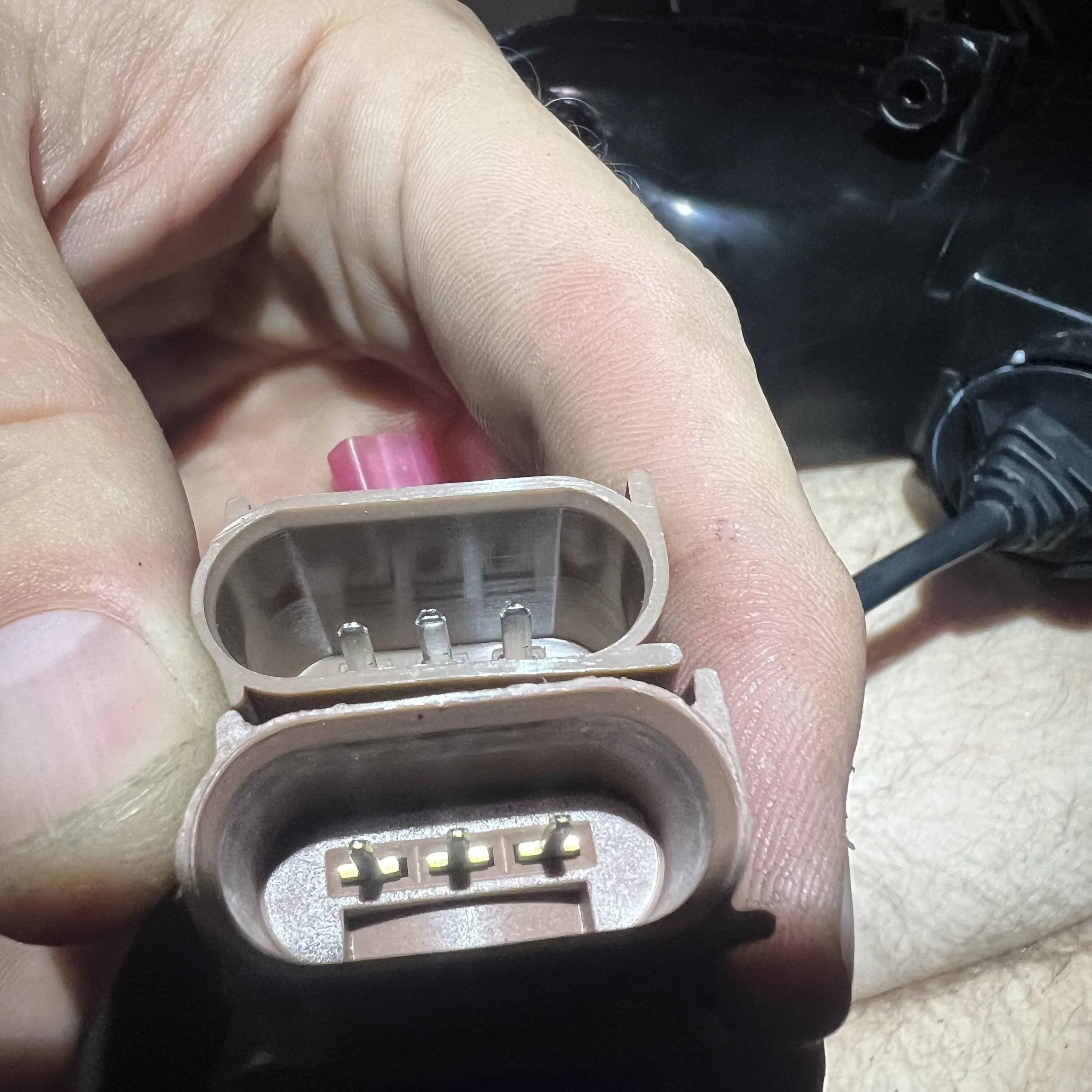

Checking in. I have a 22 Mach 1,
Bought the 15-17 diode dynamics smoked led kit. The harness for the diode dynamics won’t plug into the main turn signal harness from the car, almost like the pins are too thick.
pics attached, OEM on bottom DD on top. Anyone else have this problem?
Did I not get the right kit, should I have ordered the gt350 one instead?

Alright, I had to bend all the pins on both diode dynamic connectors but they work now and look great. If you didn’t know btw, the gt350 and 15-17 kit are the same part, so doesn’t matter which one you order.

My installer didn't say anything about doing any similar modifications when mine were installed. Simply plug-and-play. I wonder if you got a bum kit somehow. Looks great, though!
