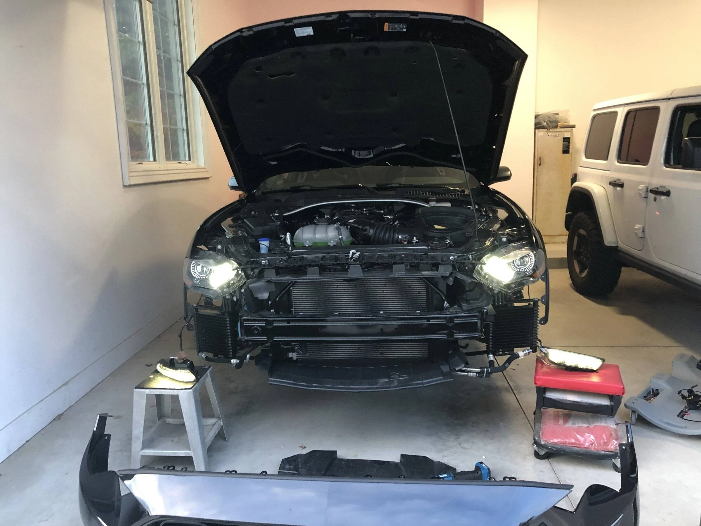

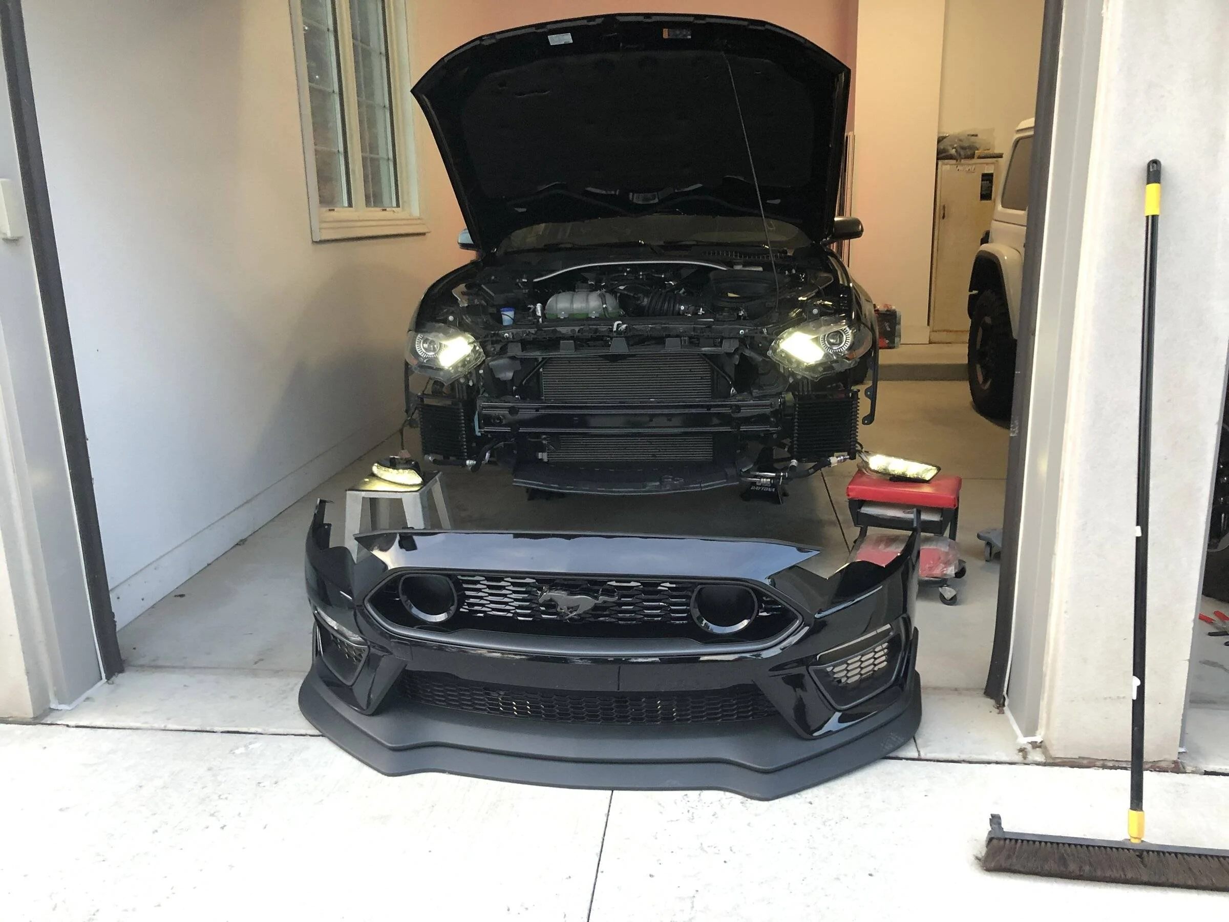

Then I don't see why these wouldn't work for you: https://www.diodedynamics.com/2015-2017-mustang-sequential-led-turn-signals-usdm.html. Pretty sure same part cross references the 15-17 year, all GT350s and M1s (and I think GT500s). You definitely need to take off the bumper to install these. I was looking at them, but did not feel like doing all the work and the switchbacks satisfy me.

It's just removing the bumper carefully. Once that is done it's a cakewalk.
