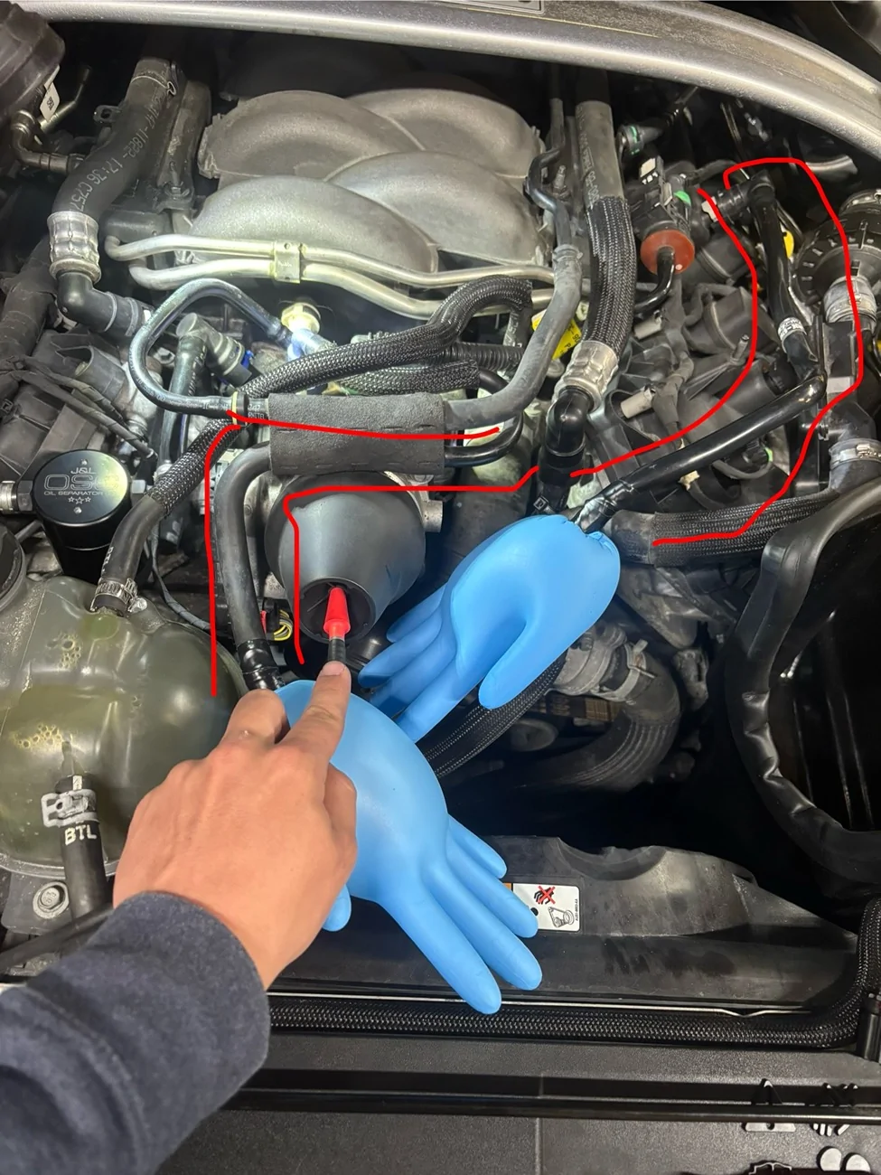

This is during a smoke test. I do not see any smoke coming out at all. These 2 lines that connect to the CAI do have smoke that comes out of them. I am assuming this is normal. Is anyone able to confirm this?
