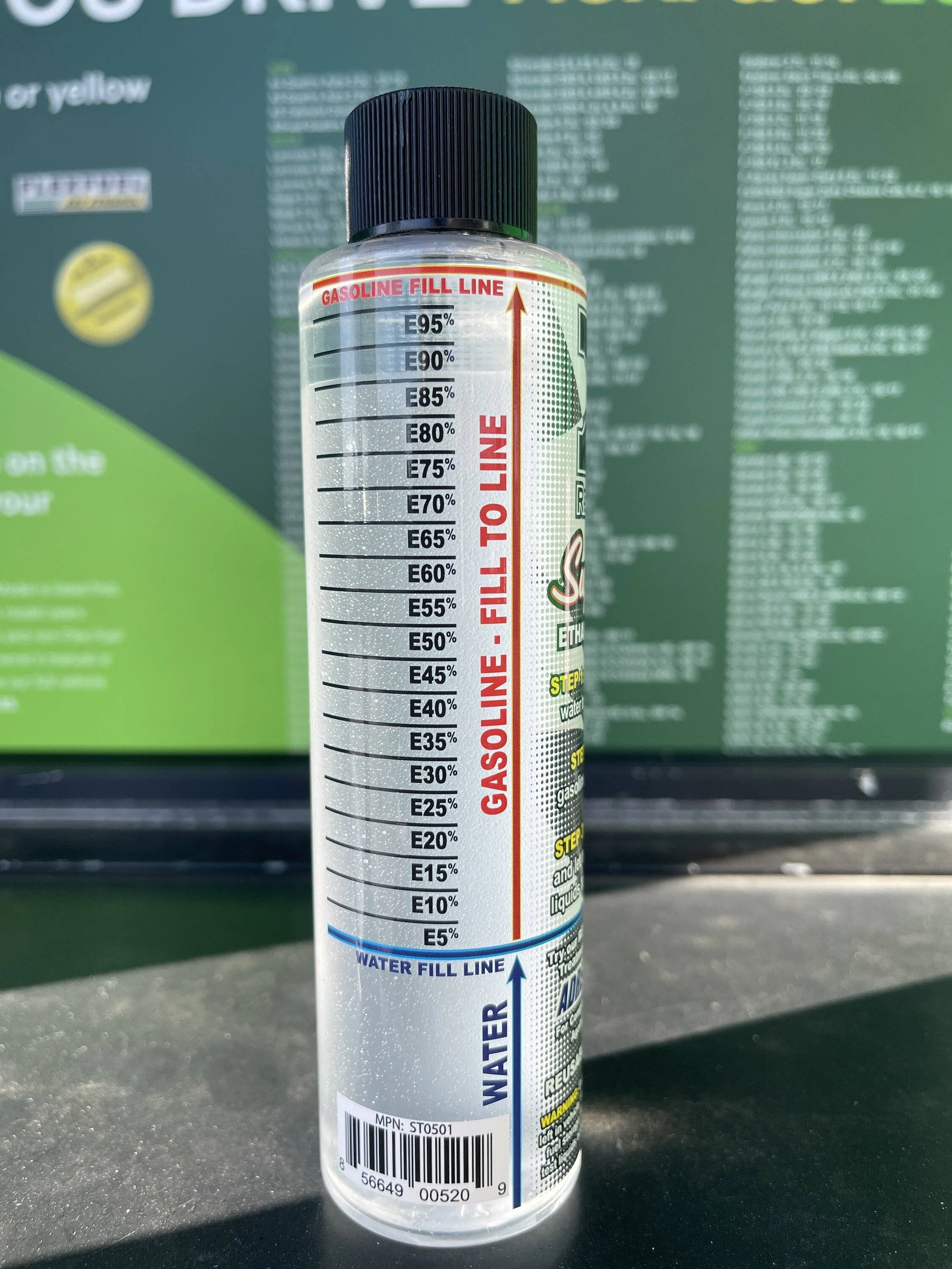

I agree with this... not sure EXACTLY what PBD tuned my car for but it seemed anything below E75 is no good (Take this with a grain of salt because we only ran into a "bad E" situation once. Luckily for me, as stated before the station by my house is consistently well above that. I test E there once a week, or every couple of fill ups (whichever comes first) and it's always always consistently between 80% - 90%. Been doing this since the car was switched to E last June and only once have I seen anything below that at that particular station (Propel).
I've been thinking about the sensor but so far have found no real need for it because the consistency of my station is always top notch and it runs on full E so no need for partial fill ups like you said.
Attached is a test from 2 days ago. 9 times out of 10 they look like this lol.
Angrey
Jun 21, 2020
104
2,794
2,984
Coral Gables
2016 GT350
Be very careful. Your logic is flawed. I've gotten E80 several times from a station and then E70 the next fill up. Sometimes the Turnpike is high 70's, sometimes it's low 70's sometimes it's high 60's.
It's dangerous to tune to E85 race quality and then rely on station consistency. It only takes one resupply of lower grade on a hot day to smoke your motor. You should check every time and never trust that just because it was awesome yesterday that it will be the same today.
I personally follow a philosophy of over-engineer, under utilize, which is why I tuned on E70 and then had the tuner back off 4 degrees. At mid-high .70's lambda. I had originally shorted the rpm limit as well (even though I'm upgraded to handle 9k).
I want the car/motor to have some breathing room for imperfect conditions and to be honest, a single unloaded rip on the dyno with good IAT's isn't reflective of what I will almost assuredly ask of the car out on the street (more load, hot temps, back to back rips with higher IAT's, less than optimal fuel, etc).
The $400 ethanol sensor setup not only spares me from water bottles and station tests, but ensures I'm not lazy or in a hurry and can still check the quality. Most guys don't even do the tube tests properly, if you shake it and read, you'll notice at least a 5 point drop if you let it sit and settle properly over 15 minutes.

If you tune to E85 and then get E70, isn't the car just going to be rich if fuel trims can't tune it to target lambda? Seems like it would be more dangerous to tune for E70 and get E85 and then need more fuel. As far as knock resistance goes, I doubt there's much difference between E70 and E85.
Exactly correct. Yes. Max effective spark is usually achieved between 67-73% in most combos on the Coyote platform. (21.5-23°)
