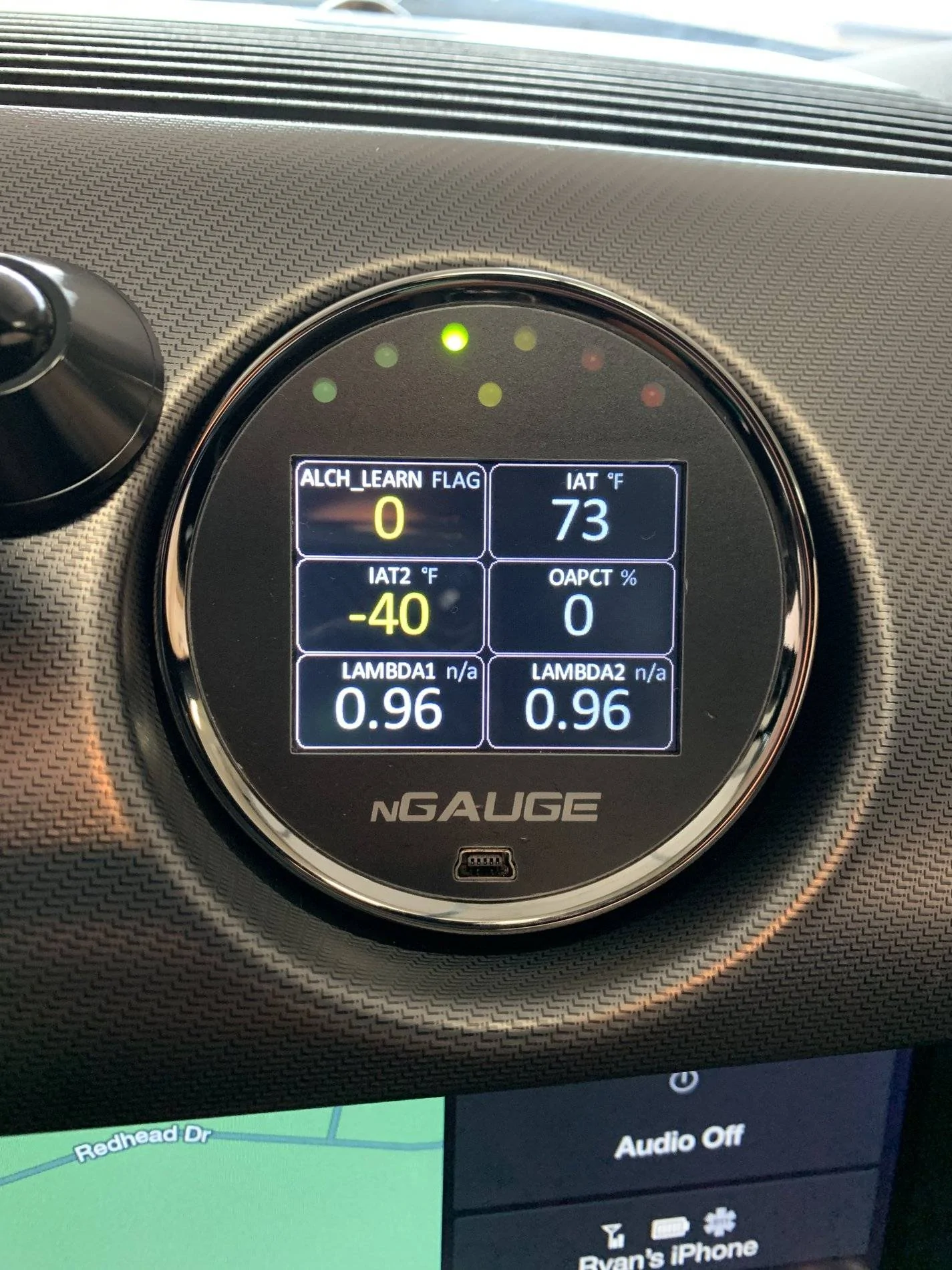

Are these the correct gauges to monitor? Is this good now?

I forgot to plug two coil packs back in :giggle:

Interesting. Glad you got it figured out your well on your way now.
Leave lambdas and IAT on top right. The rest change for coolant temp, knockR and boost if you have a boost box, or total timing, or fuel pressure (I think 18s have rail press sensors right?)
