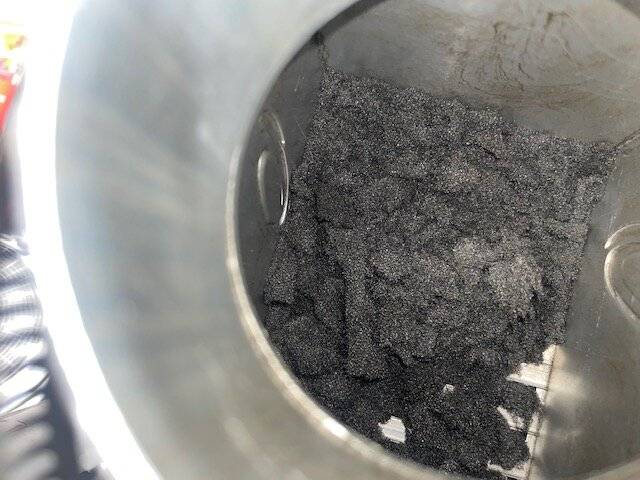

Figured out the issue. Somewhat embarrassing (don't ask!! :lipssealed:). The filter on the charge pipe had fallen off, and the blower sucked in some foam, spit it out and clogged up the IC. I was able to vacuum it out and took the car around the block and immediately hit 8psi. I didn't drive it much, since I'm not sure if any of this foam made it through the IC.
My next dilemma now is do I pull the IC and try clean any of this that could be left inside, or eat the loss and just order a new IC and know it's good to go. At this rate I have a new P1X, new BOV, new pulley, new belt...etc!! lol. A new IC sounds great, but damn another expense. What do you think?
