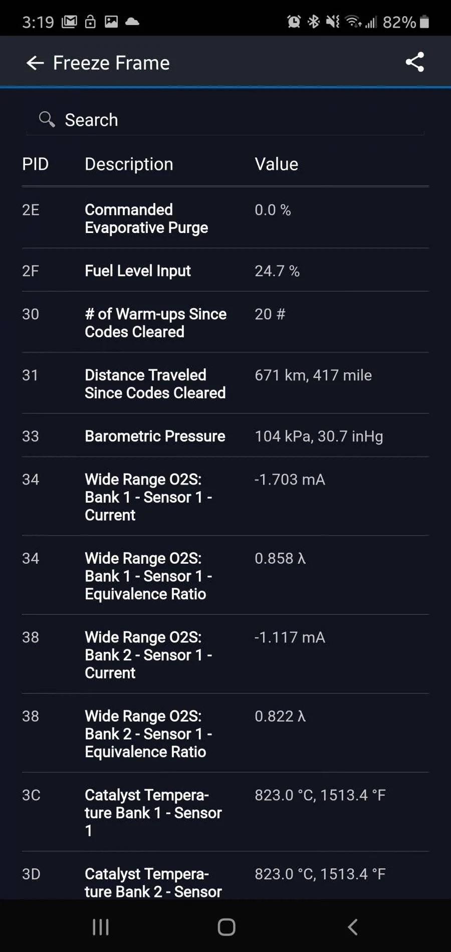

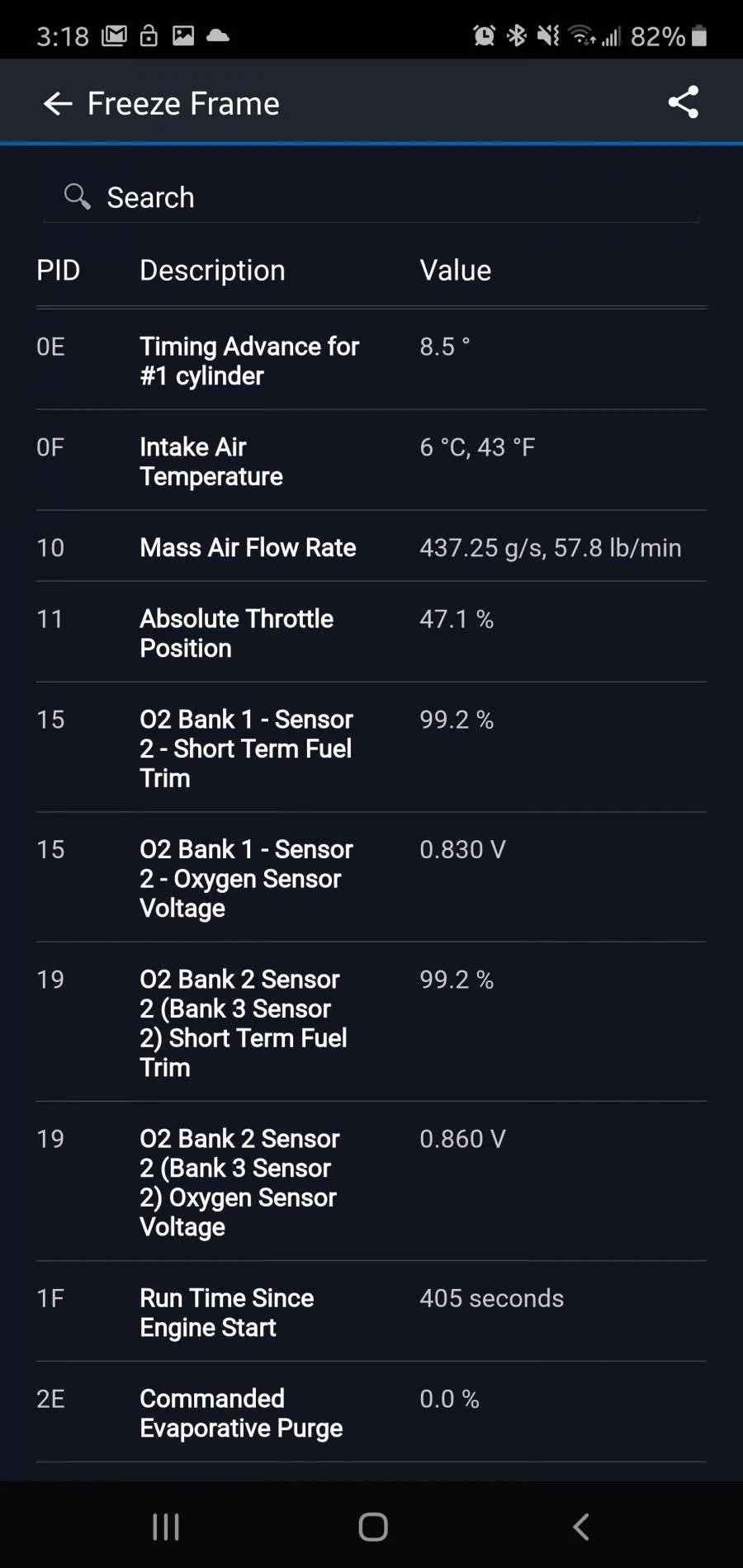

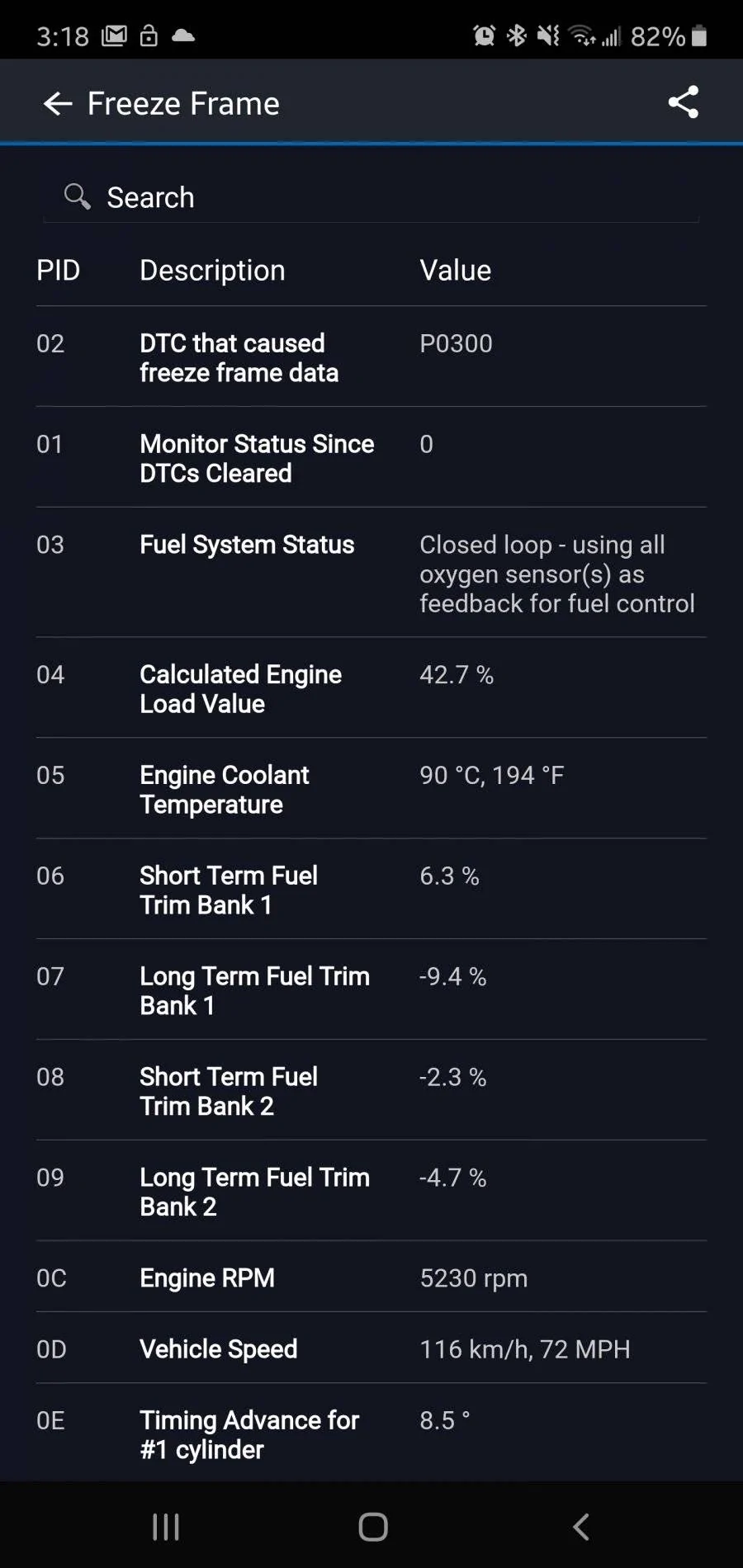

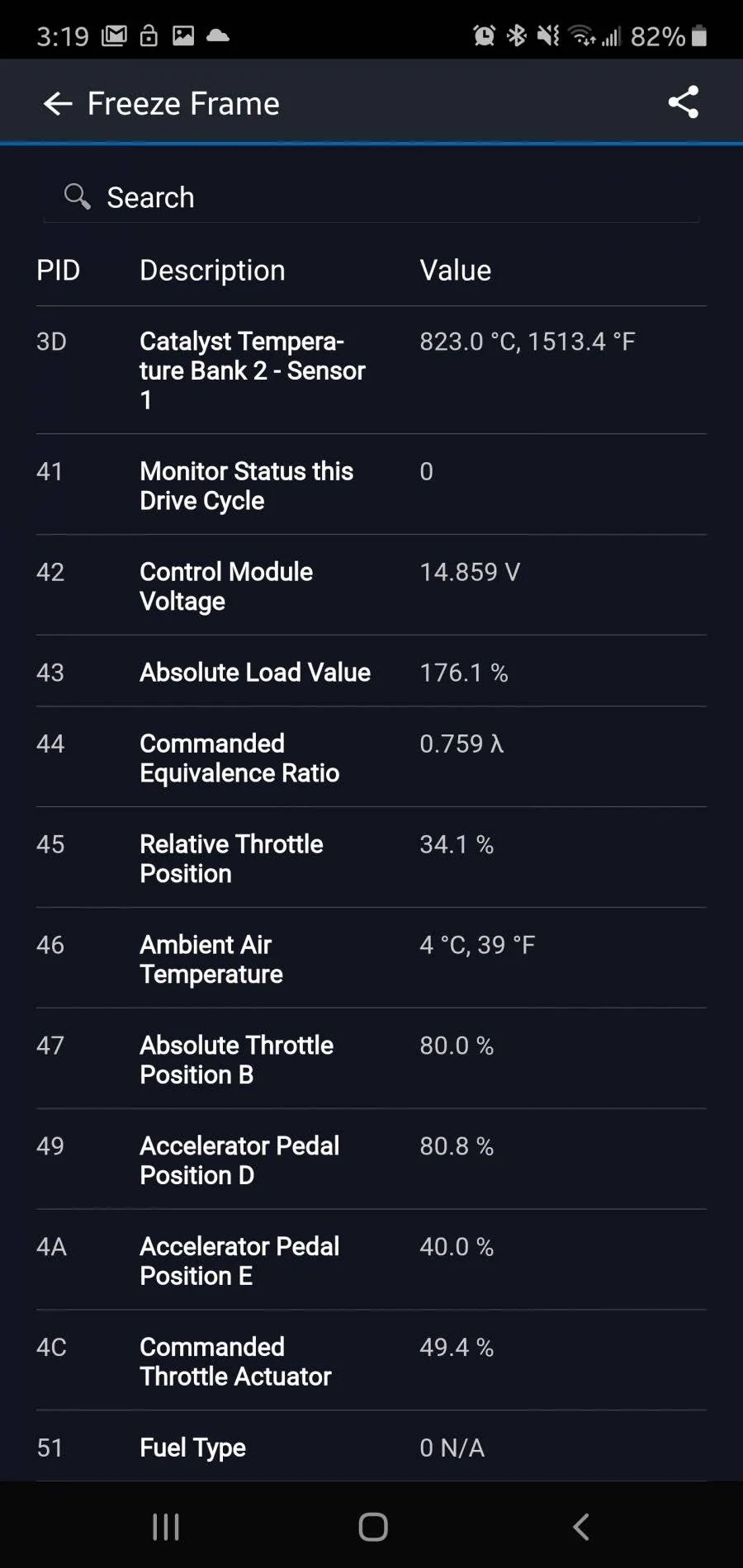

I'm having similar issue. At WOT in 3rd around 5k rpm I get hesitation until i shift. If i continue flooring it check engine light flashes with p0300 code then goes away by itself after 3 minutes. installed phase 2 kit 4 months ago. I'm not good at diagnosing things or certain terminology like what a COP is so please be mindful of that. So far i got my Mass air flow sensor cleaned, spark plugs that came with the phase 2 kit checked and re-gapped if needed to .35 and cleaned throttle body. Still have hesitation. Plugs have about 15k miles on them. Car has 98k miles.
I dont dont how to read these screenshots but hopefully someone here does? Thanks in advance.
