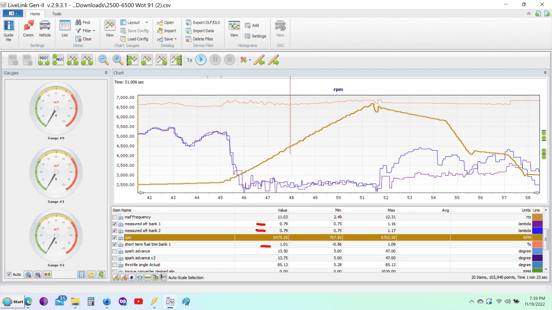

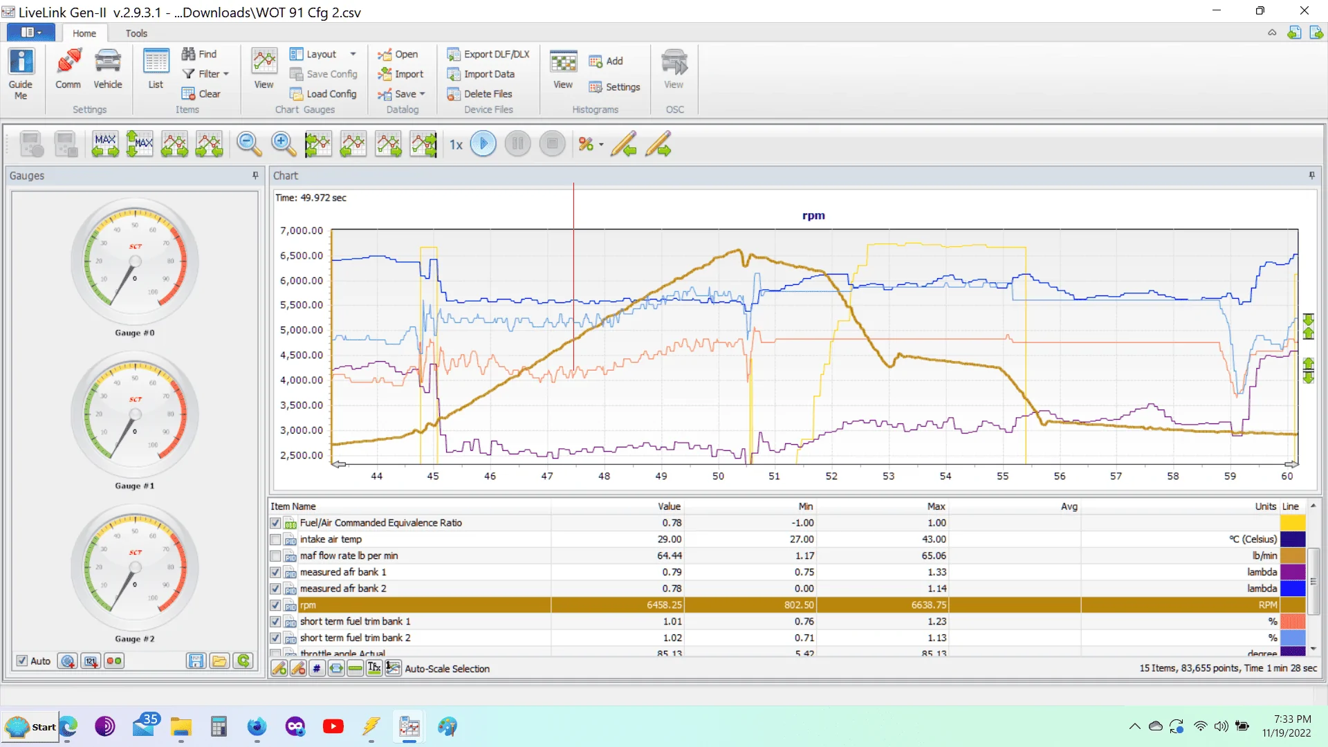

I checked all the hoses, raised fuel pressure to 50psi at idle, and redid all the wiring too make sure there was no voltage issue. Did two pulls and have logs for both. One with the the config file you sent me and one with the PBD config. I emailed them both to you and PBD. If anyone else would like to see just let me know! I don’t really know what I’m looking at with these logs so I can’t give the best update but it seems like it made a bit of a difference. The logs will tell a better story though.

The 91 tune looks good as far as fueling. Commanded equals actual.

Second log looks good also
