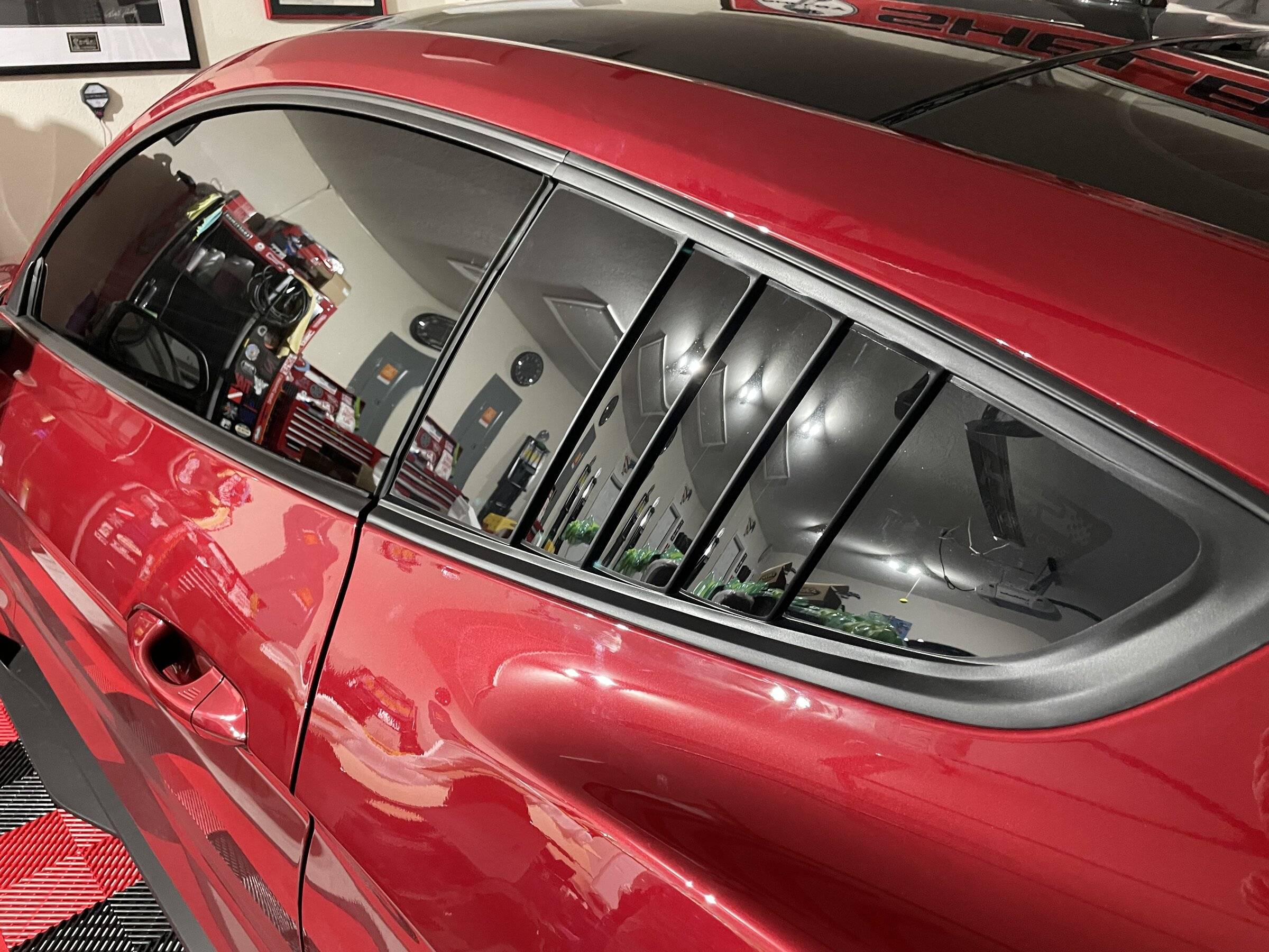

If you want close to the look without the cost go with Hyperformance Glass Products. They are gorilla laminate 5-panel glass and look killer. You can now order them without the branding and they offer a forum discount.
BTW, interior trim removal is not required to remove or install these. I watched the glass shop install mine and they didn’t even touch the inside.

How did your installer remove the original 1/4 glass out and install the Hyperformance glass without removing the interior panels?
He used some sort of power tool with a blade on the end. It cut right through the sealant. He had a guy looking through from the side to make sure the blade didn’t get near the interior panels. There’s no bolts or anything requiring the removal of the interior trim.

where do I order from for brand less glass and forum code

Who did you use for the glass installation?
