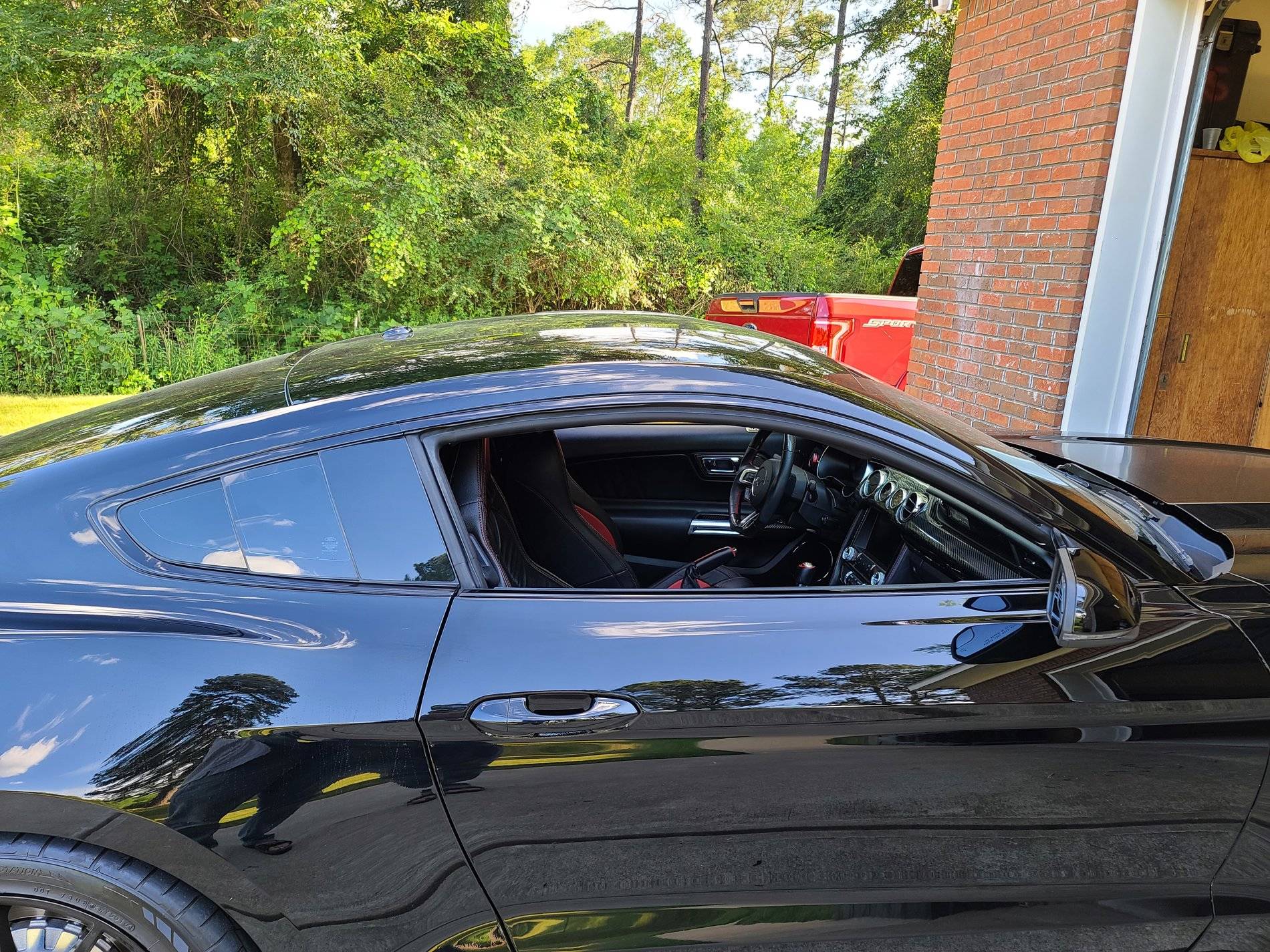

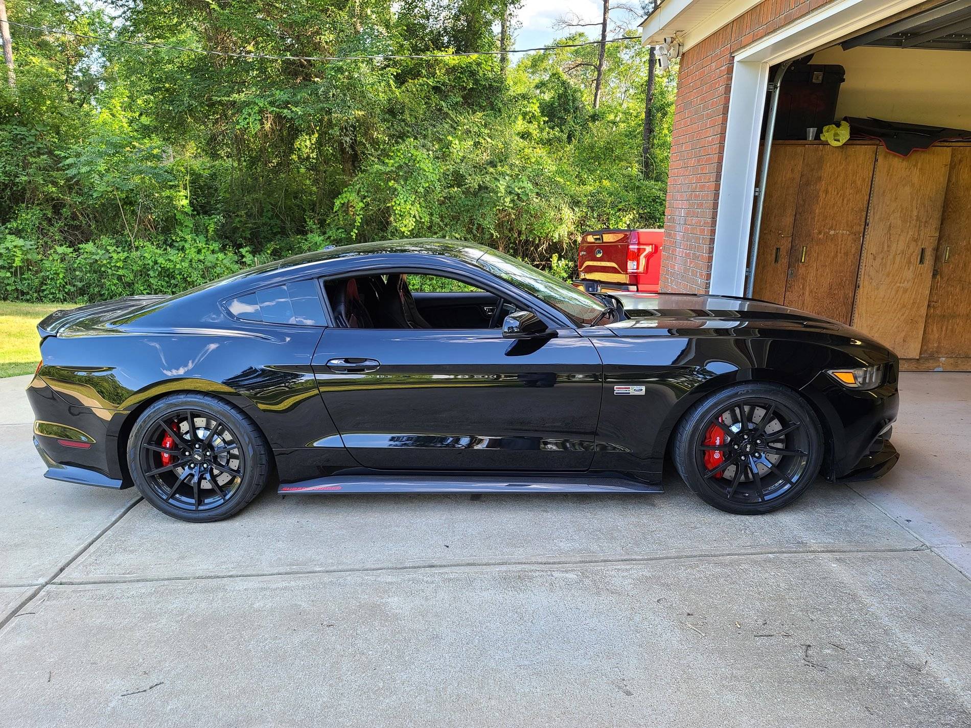

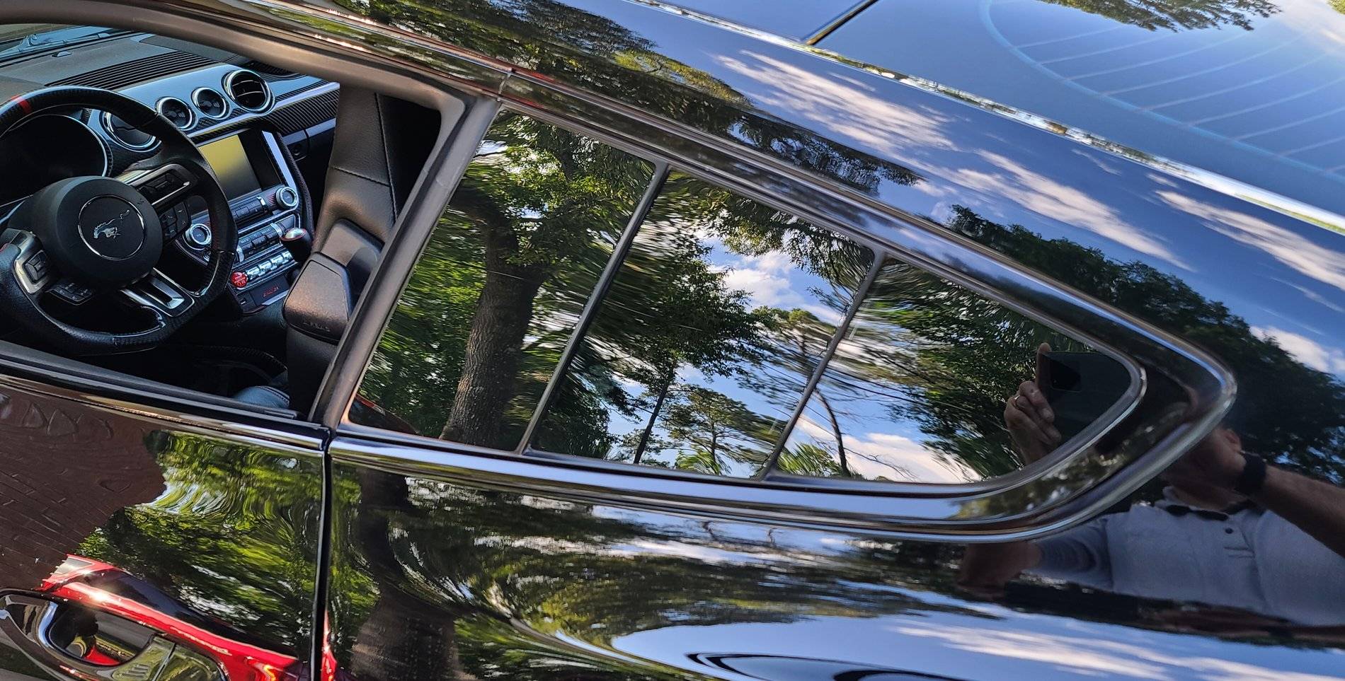

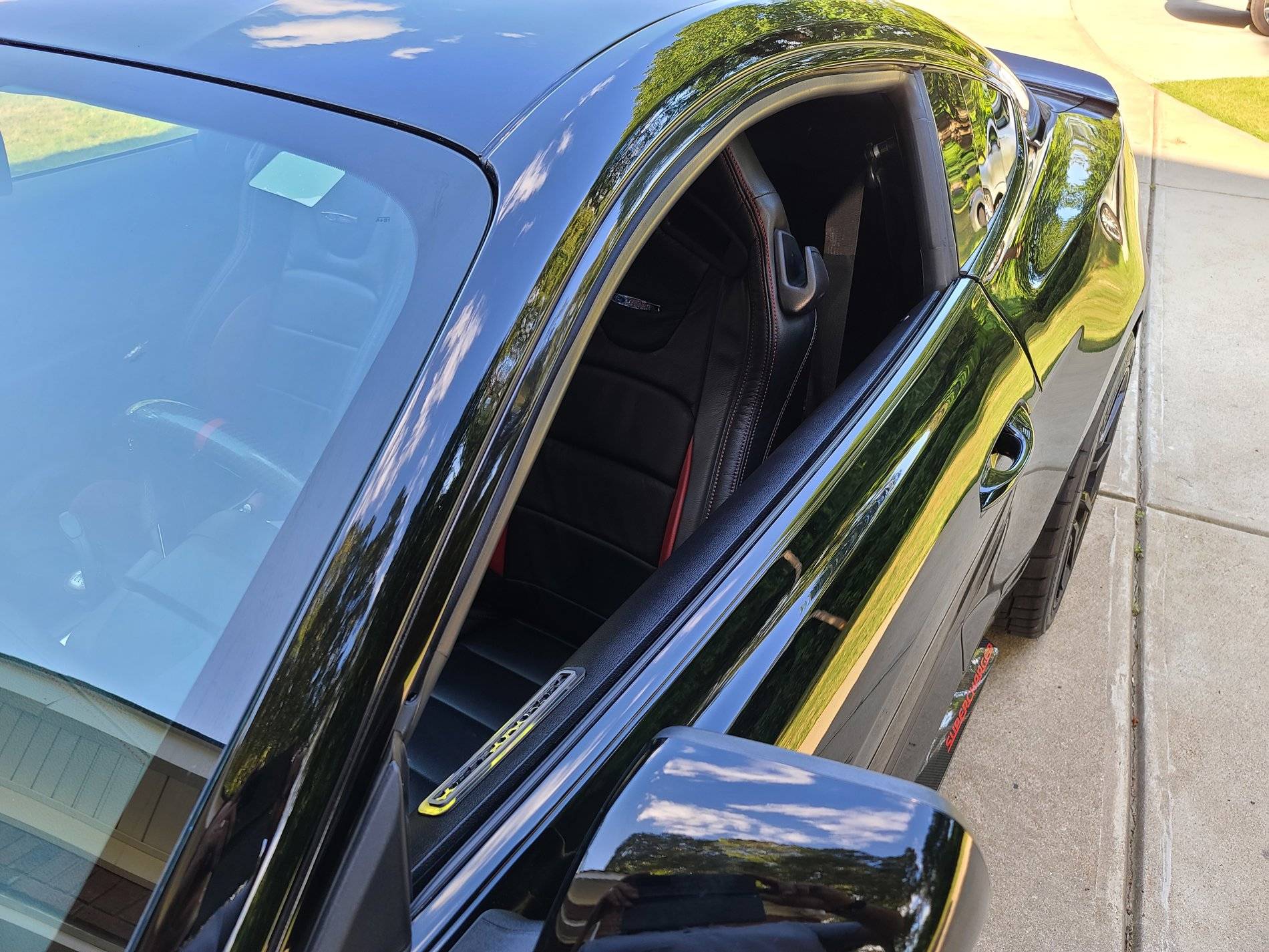

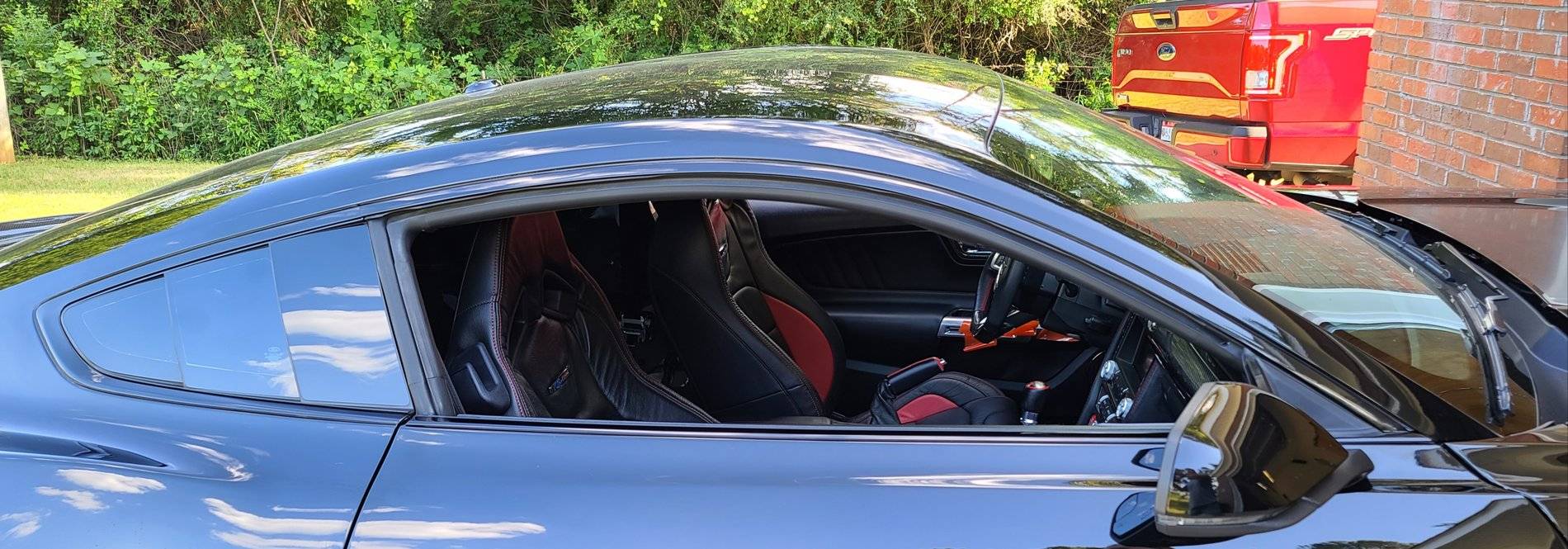

Got lucky after combing Ebay almost daily for two years. I have seen two sets in two years, mine being the second set.
I have checked with the dealer by part numbers, the door glass trim and quarter windows are not available. Even on special order.
So for anyone who can get them its like hitting the lottery.

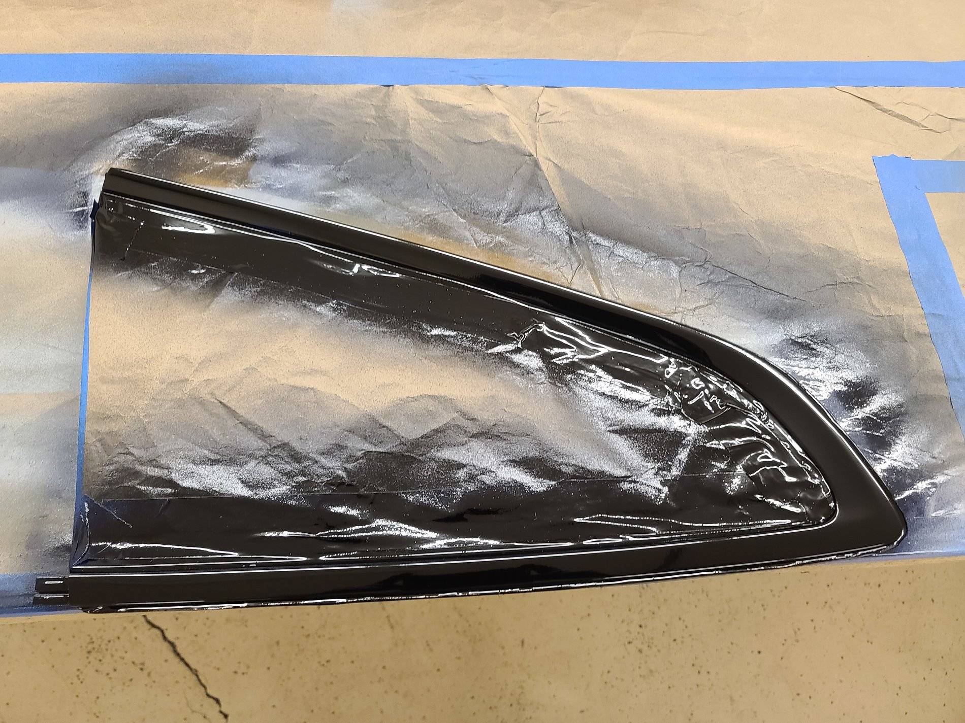

Now to stick to the plan, getting ready to paint the trim black.

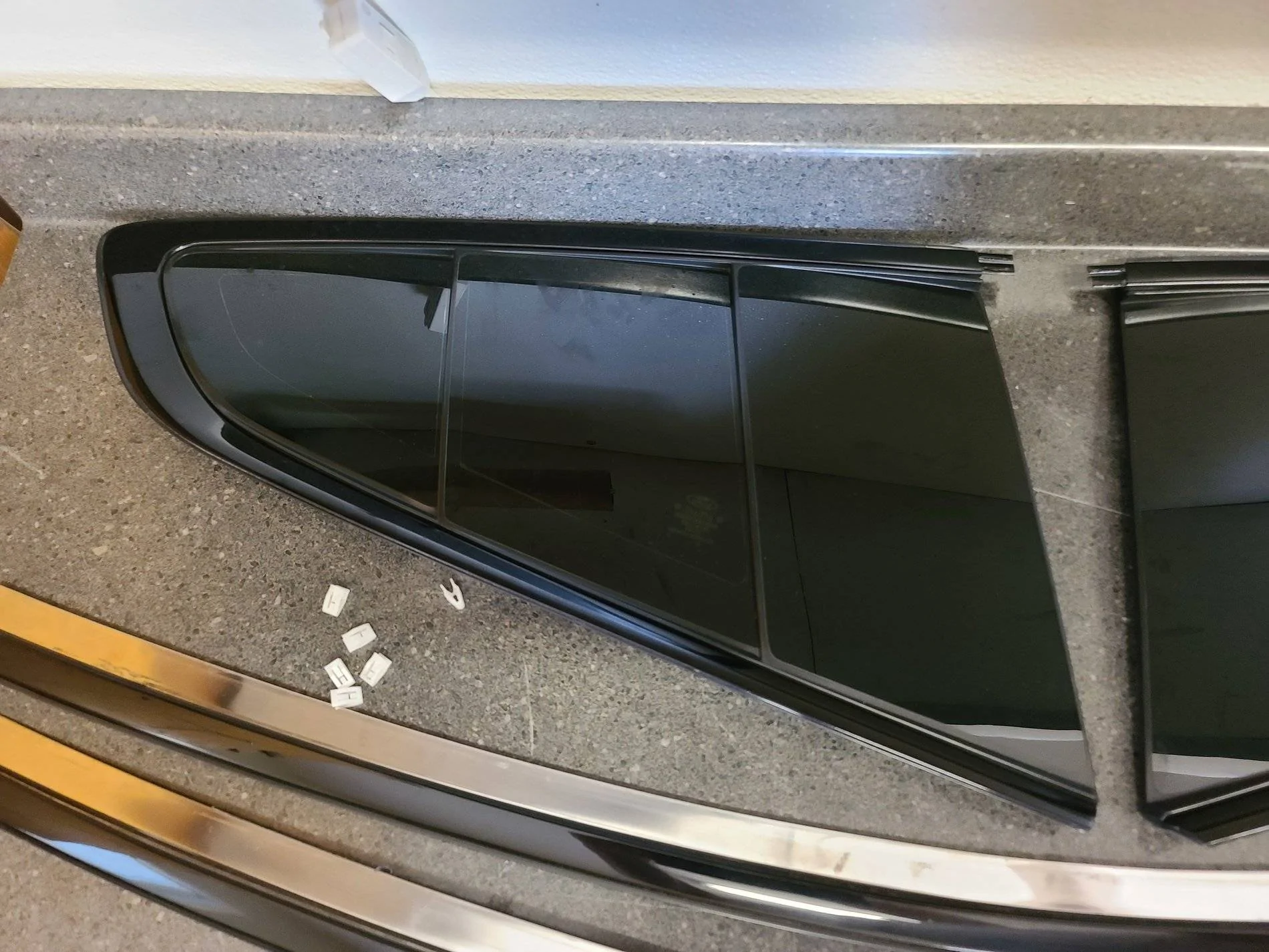

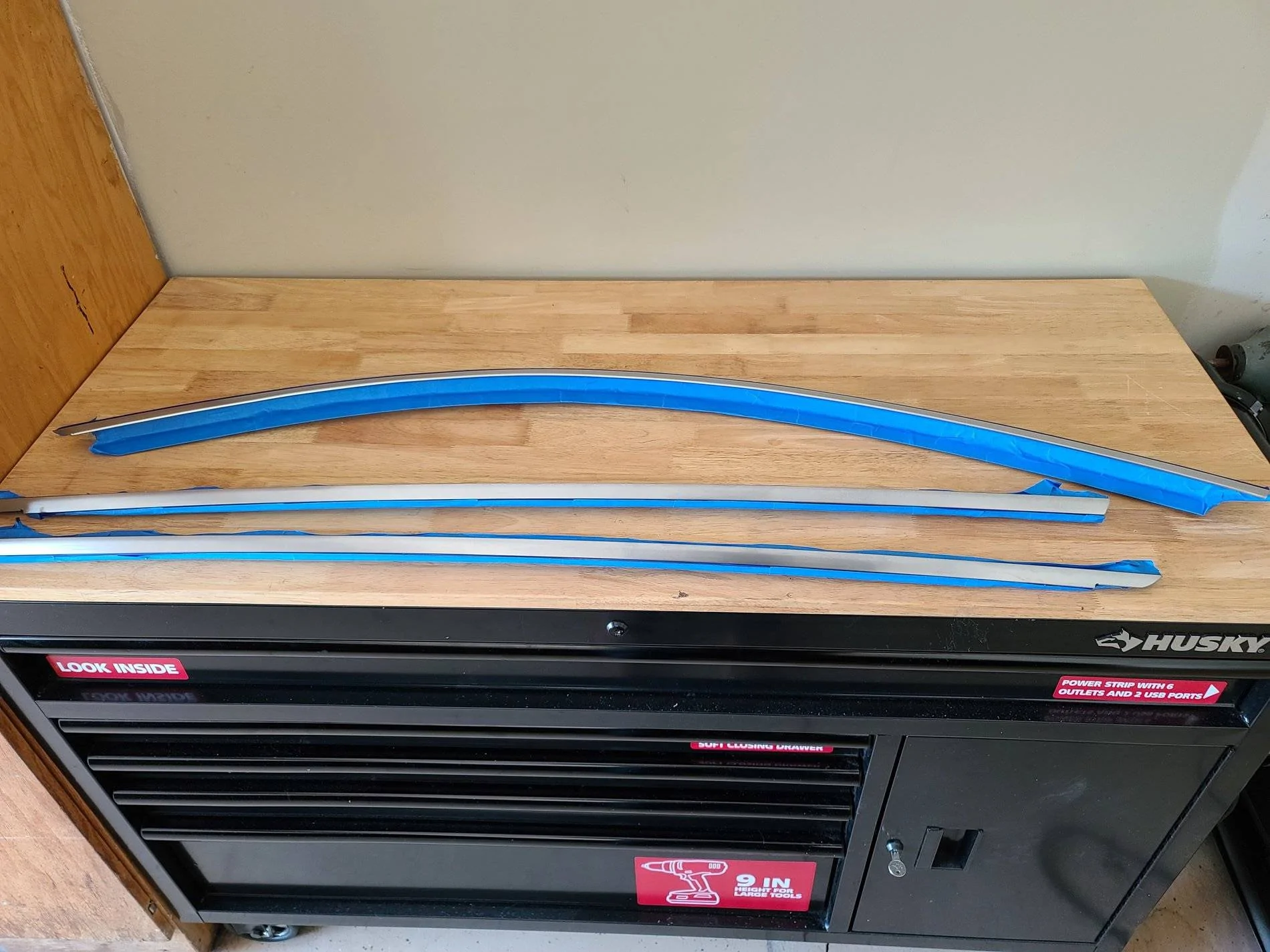

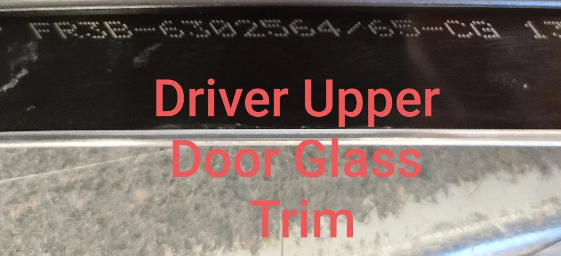

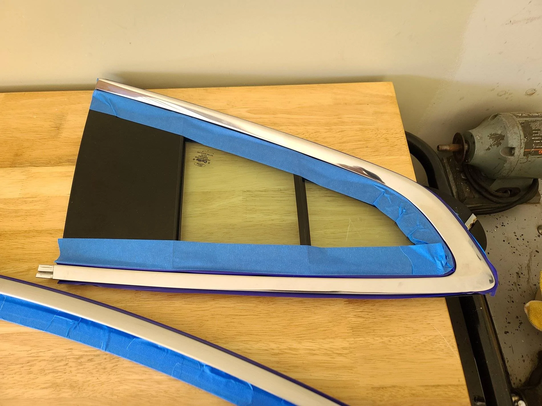

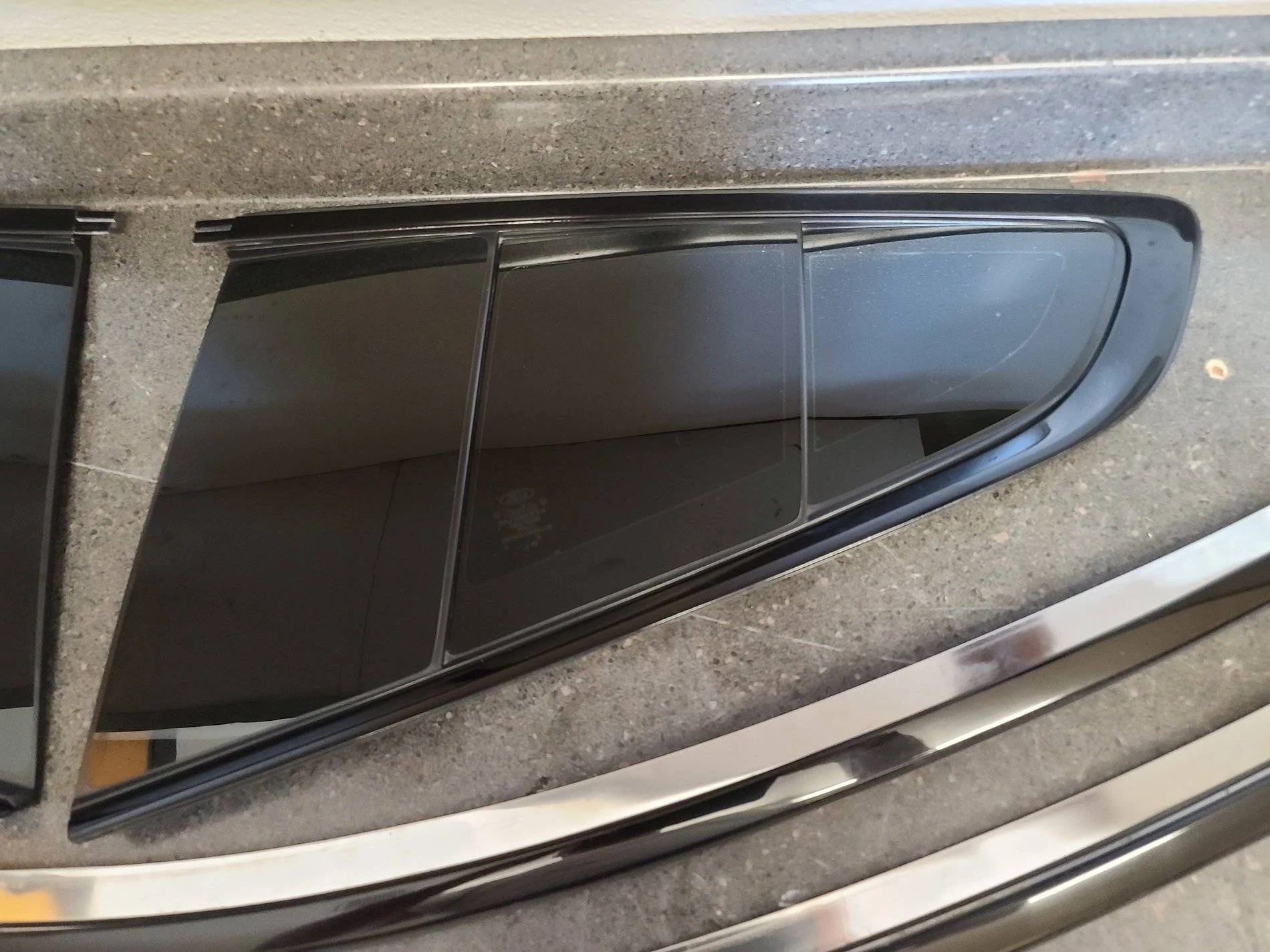

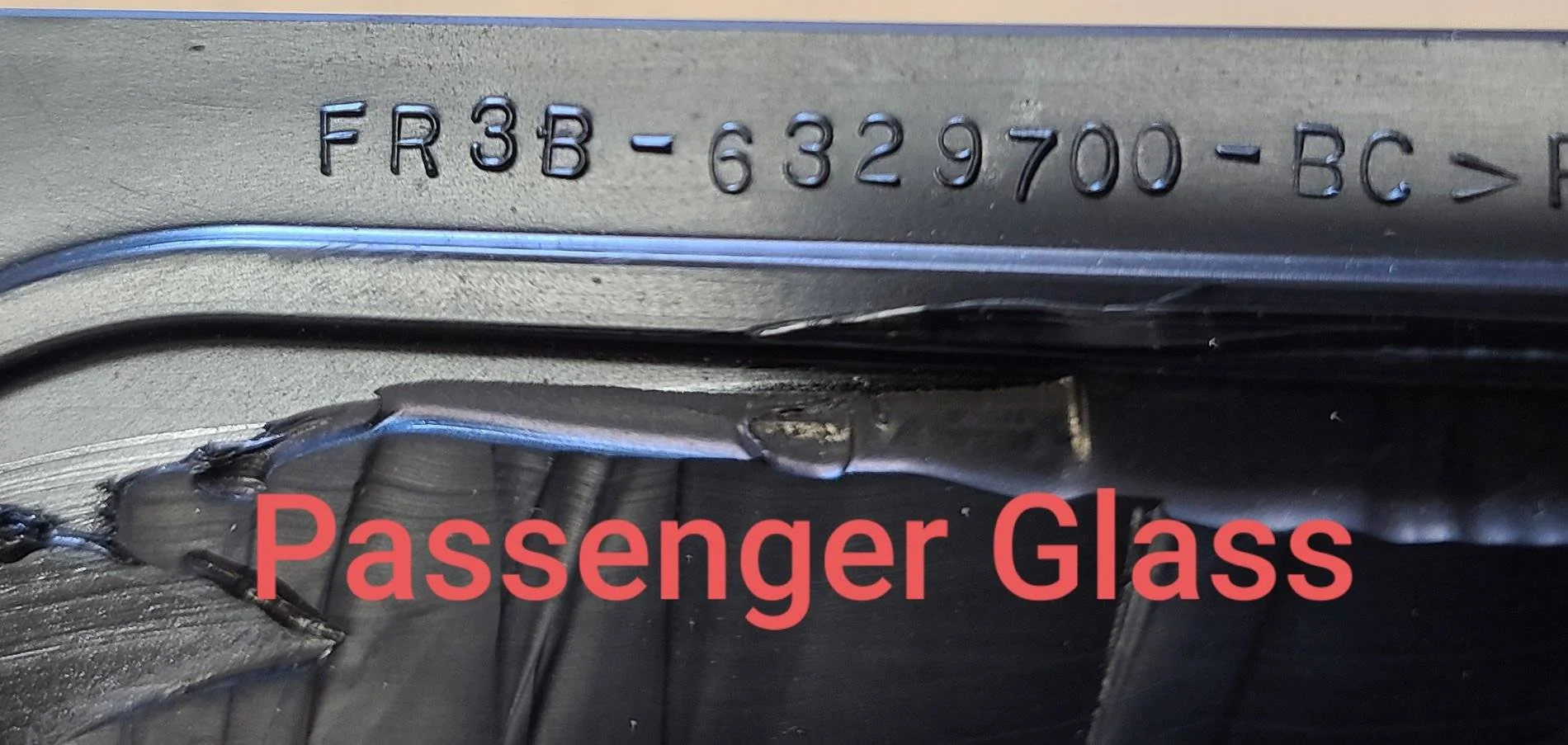

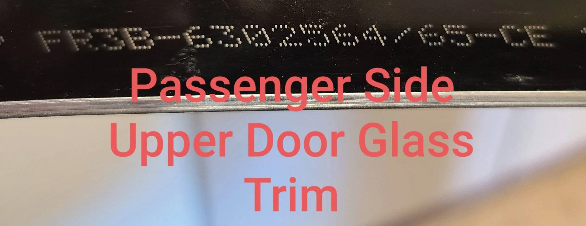

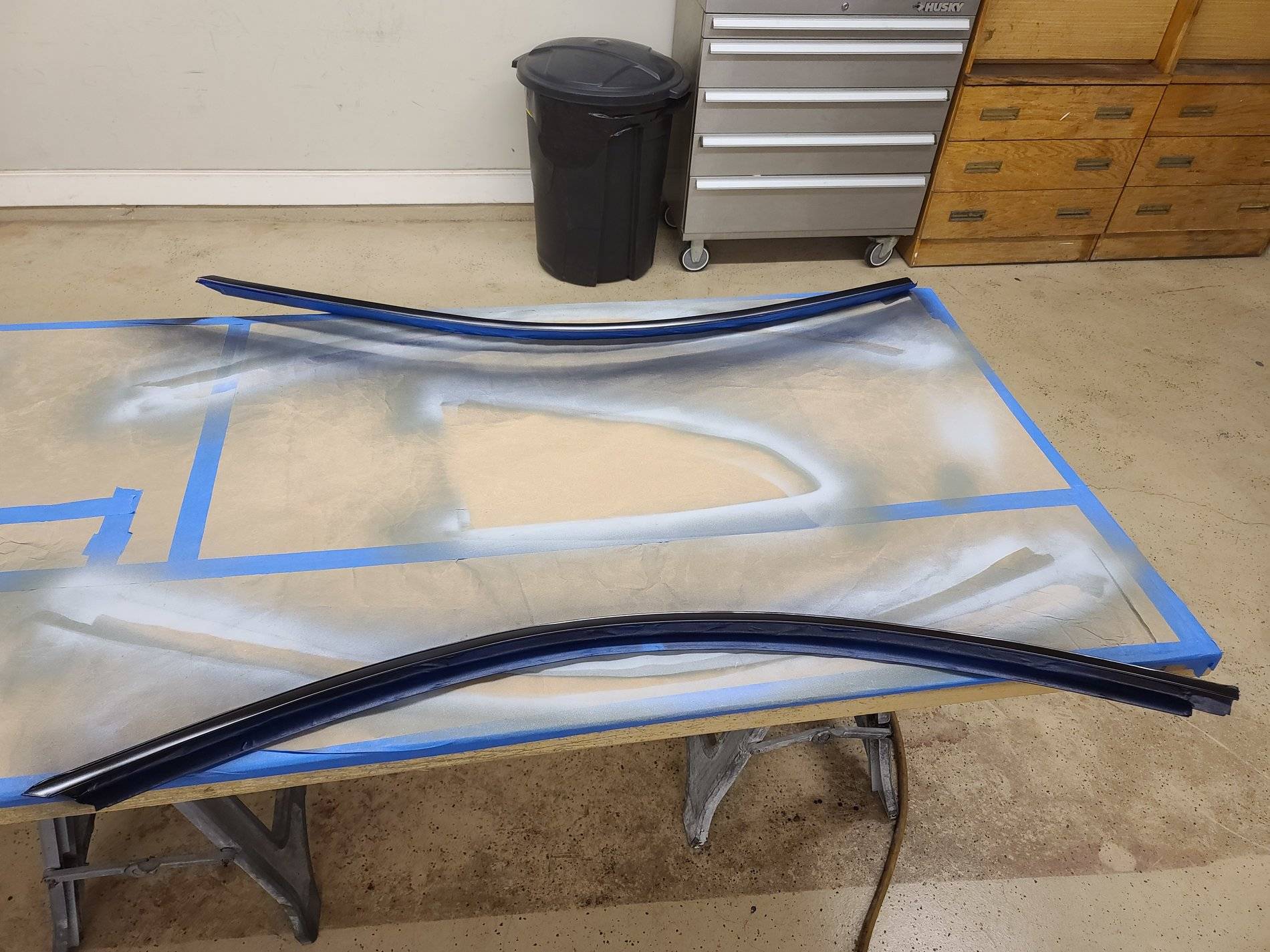

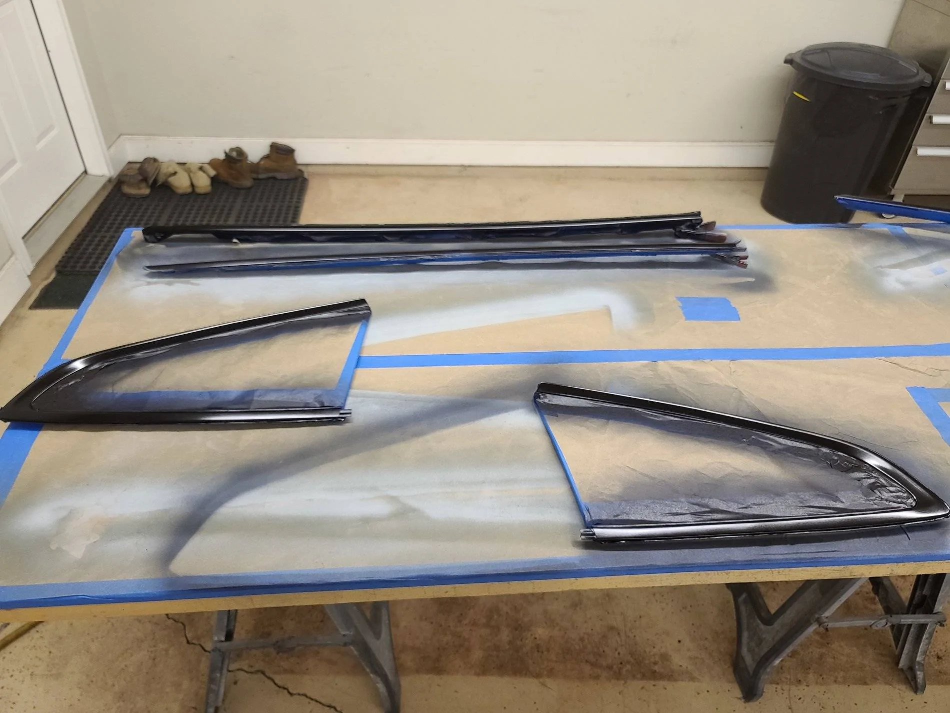

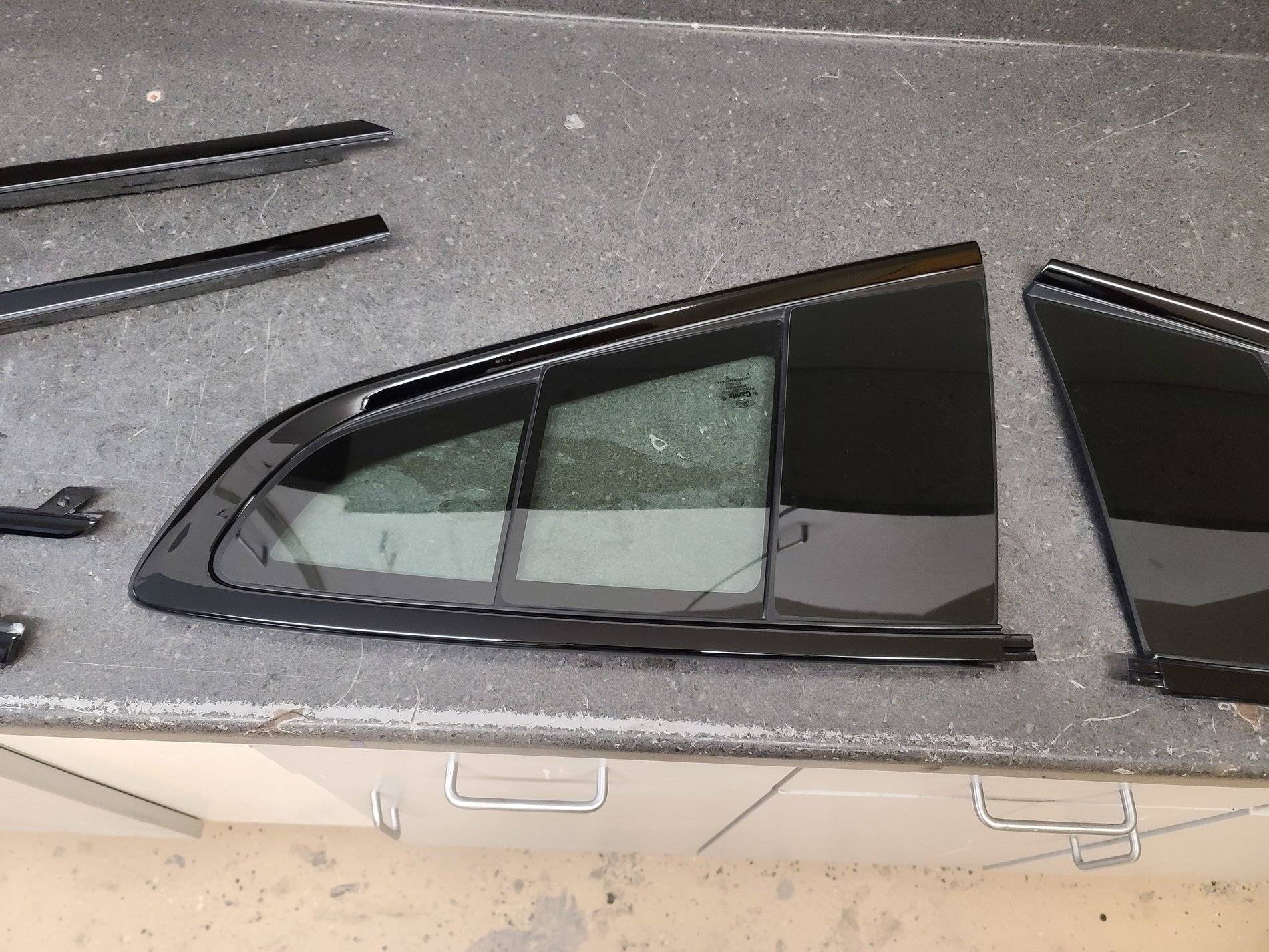

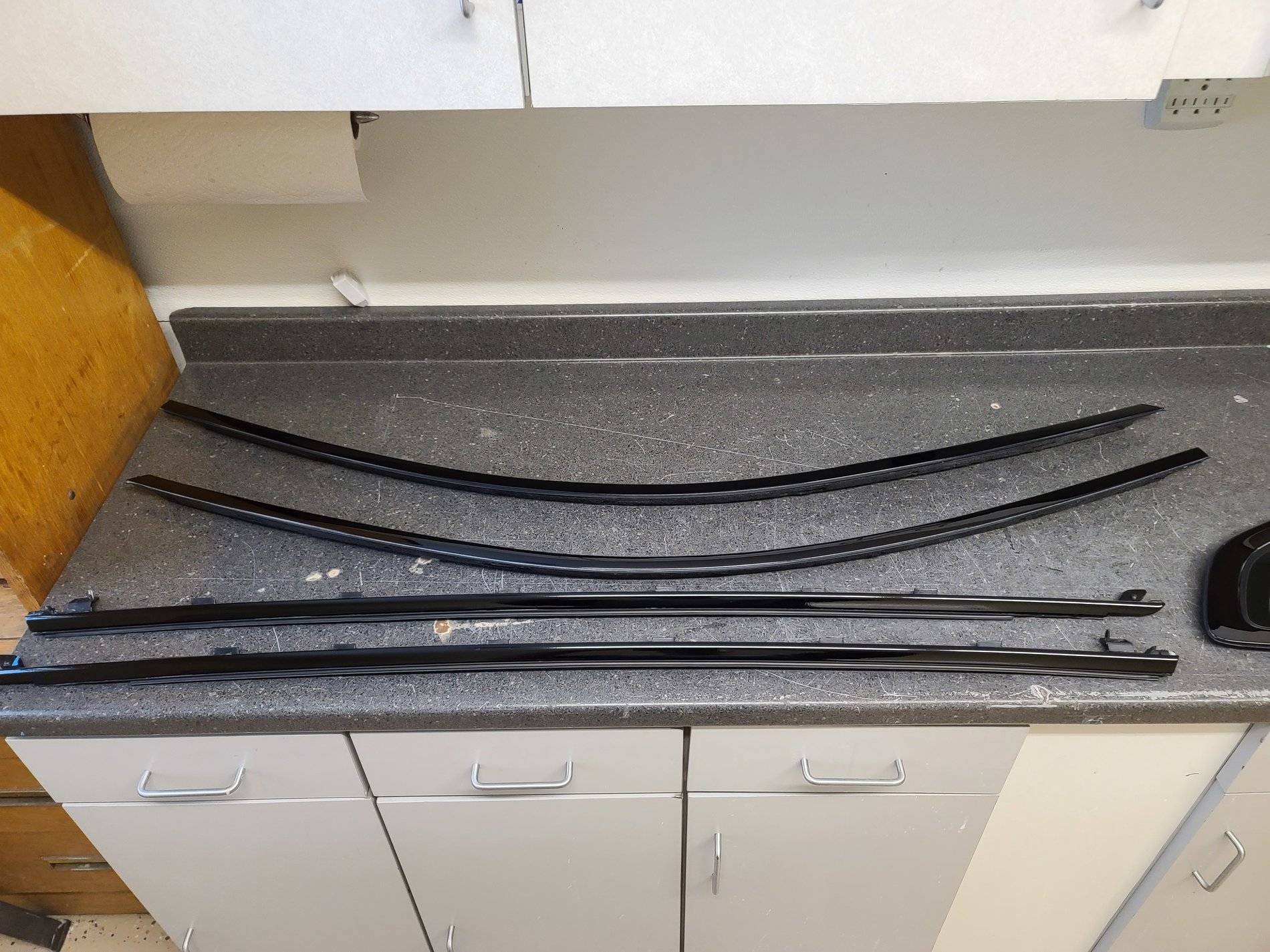

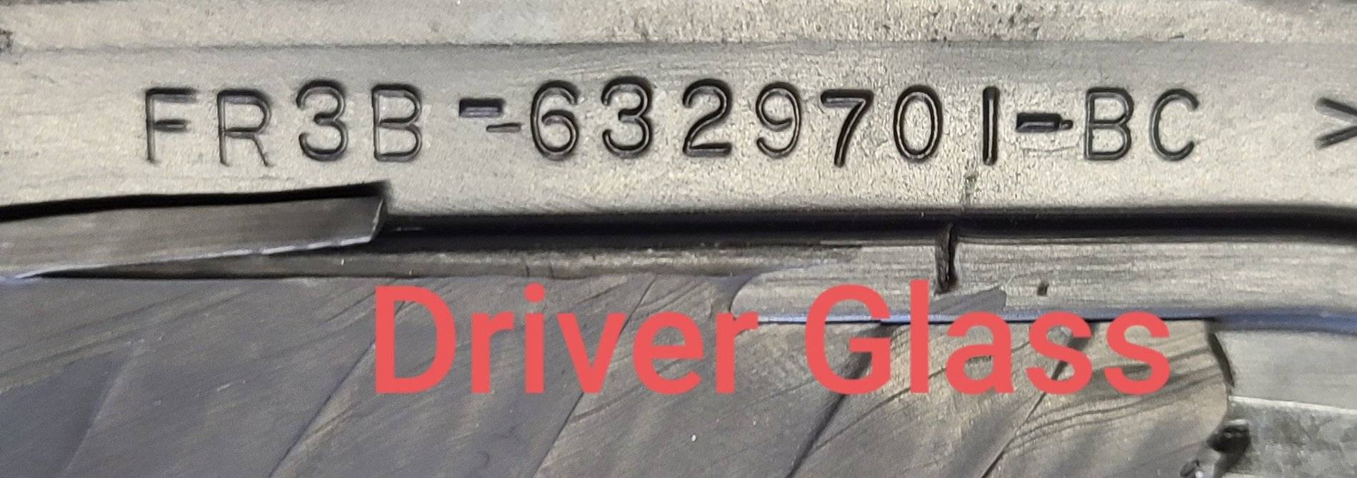

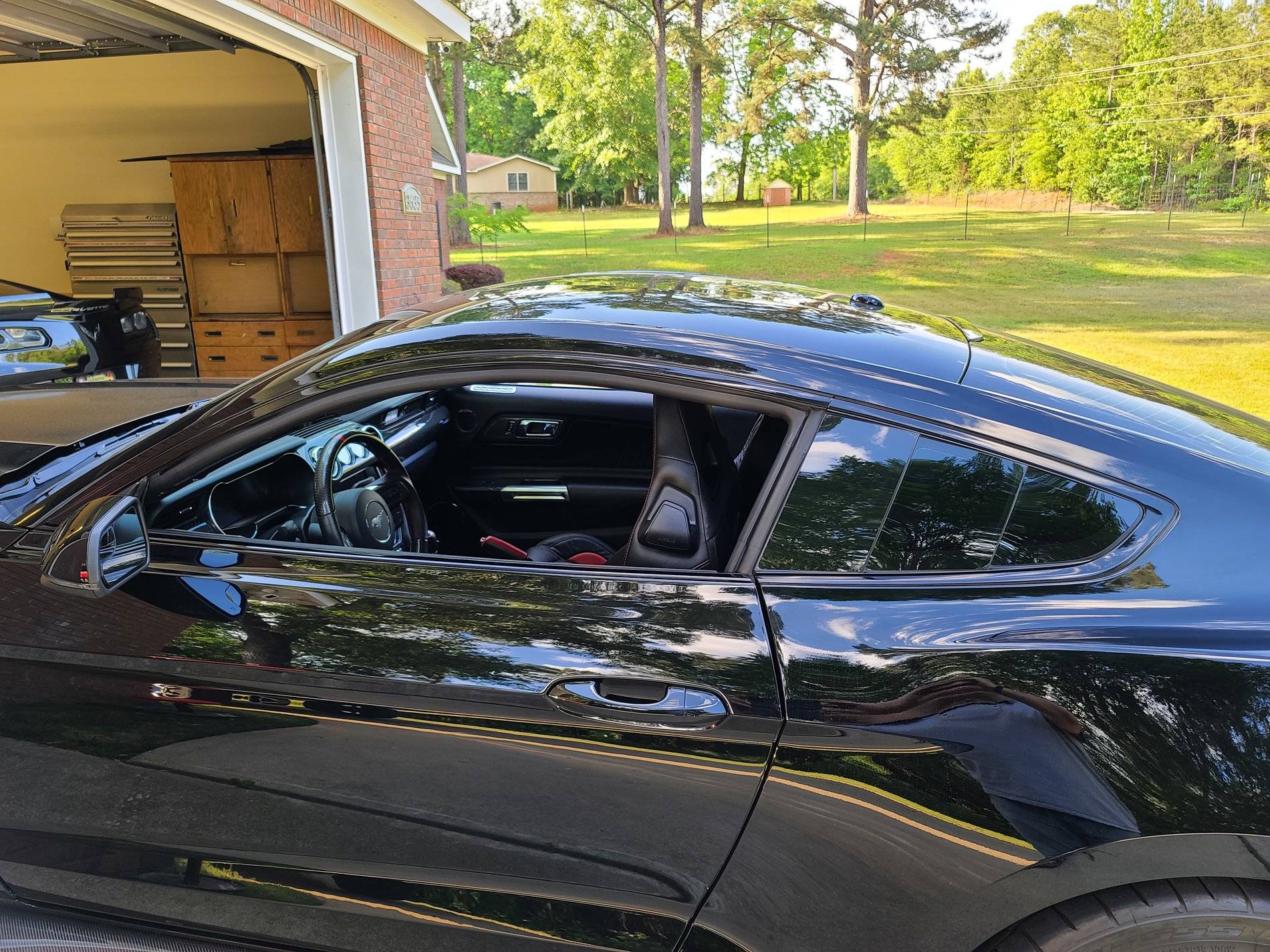

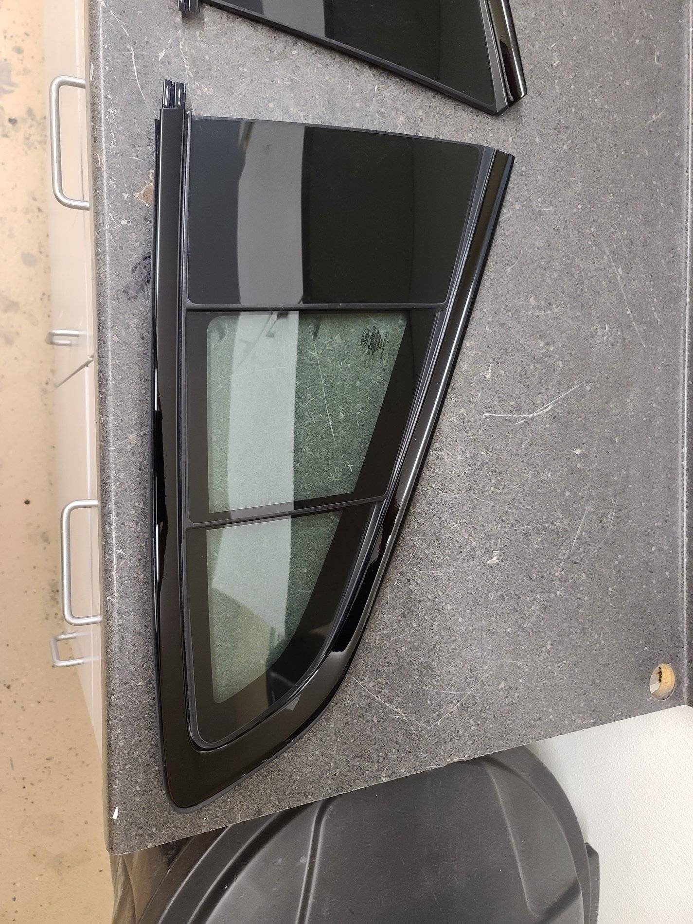

Here are some pictures of the glass with the trim painted and glass tinted, they go on next week.
Also these are pictures of the part numbers. Unfortunately there were no part numbers on the Window wipe trim for the doors.

Looks great!!
Any tips/tricks to relay regarding getting the original rear 1/4 glass out of the car?
What product did you use to reseal the LE glass to the car?

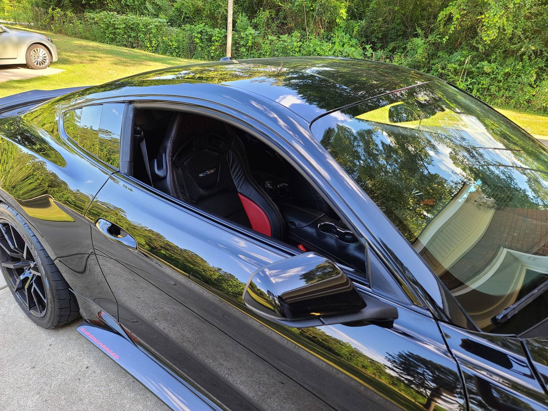

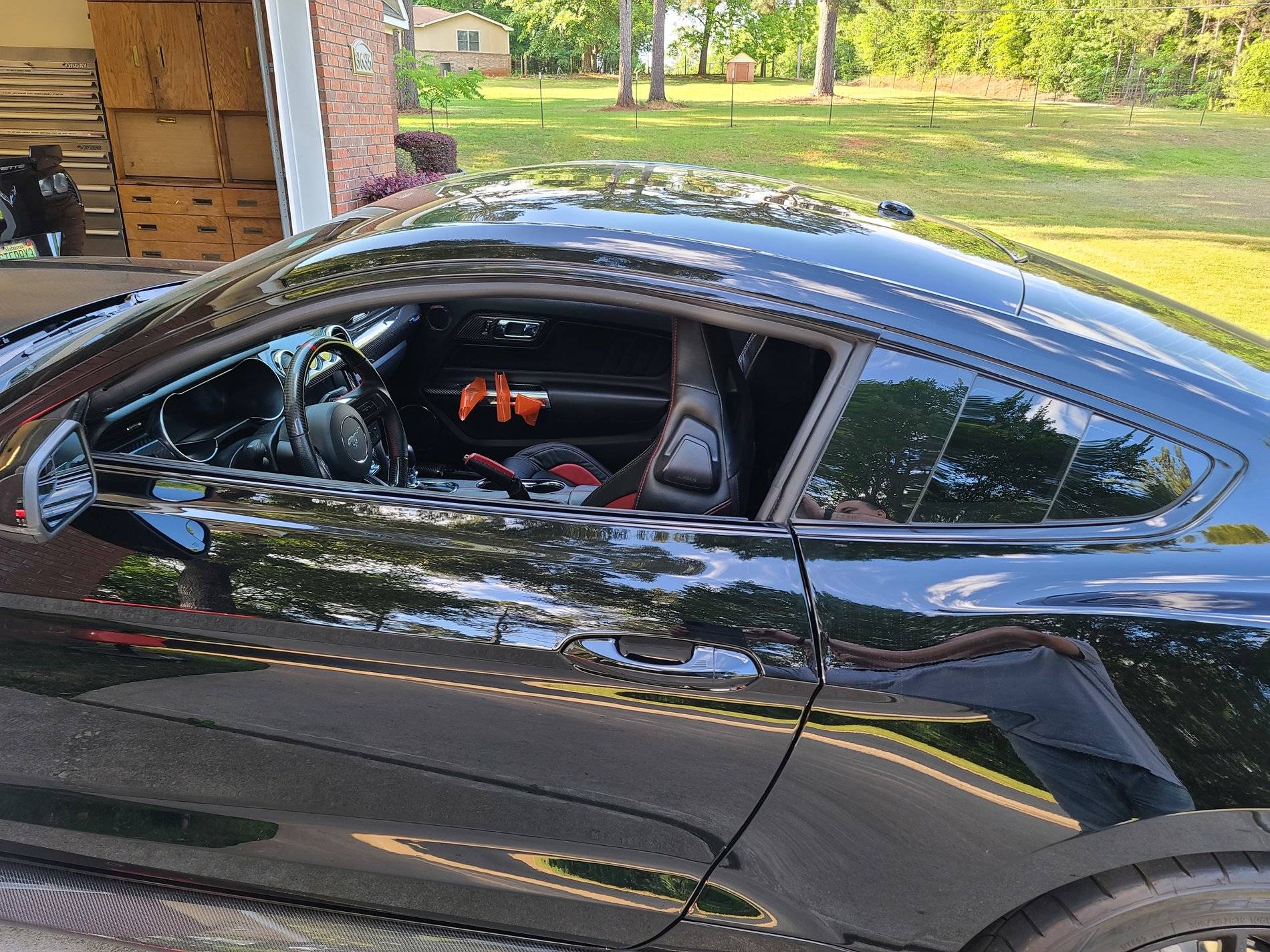

For anyone interested in this installation, with the pictures already posted to this thread and these instructions from Ford, this is all the info needed to achieve a factory quality installation of the LE Quarter Glass.
Hope this is helpful to those who need it.
